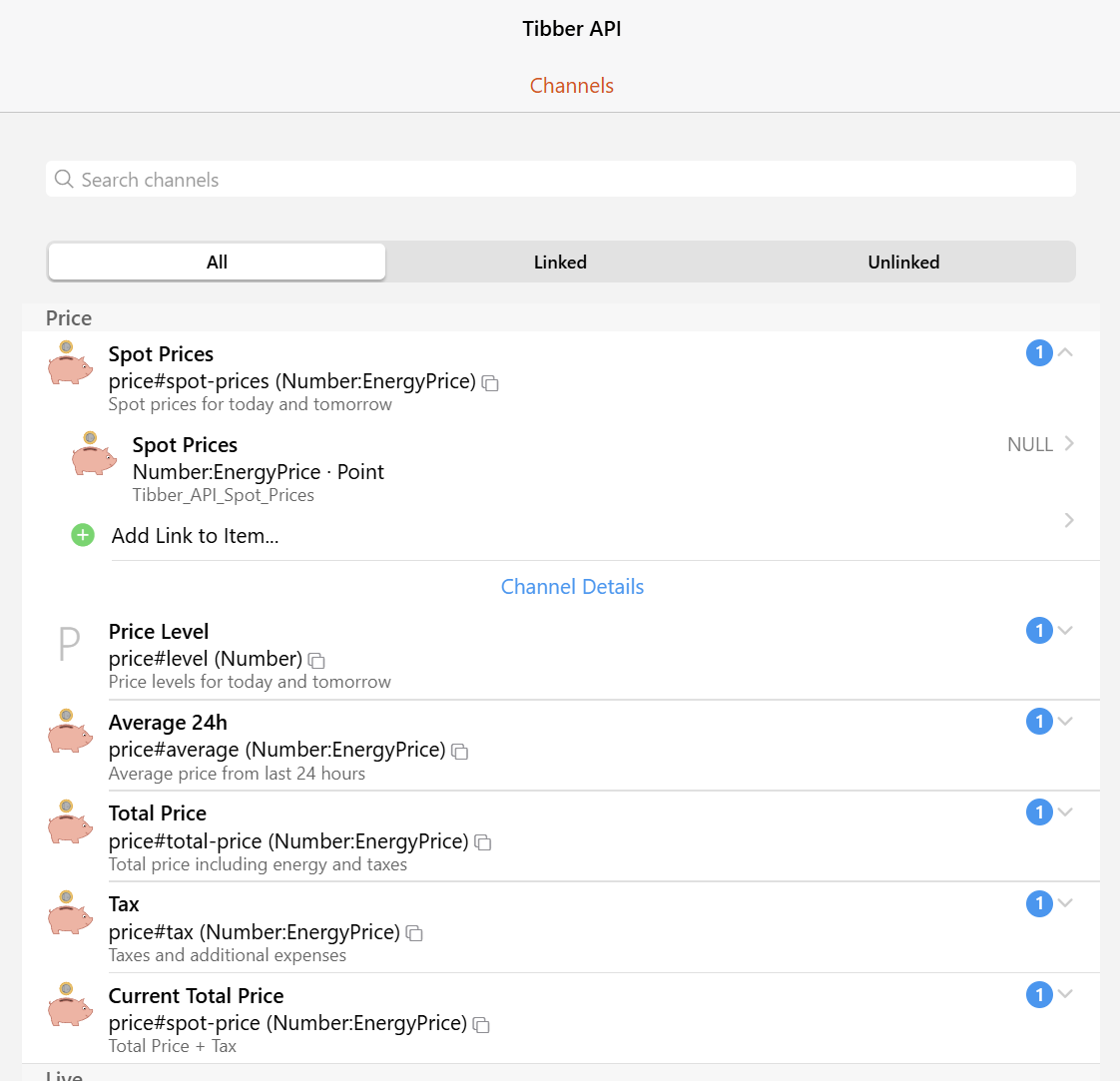

but there is no log entry at all containing Tibber_API_Spot_Prices (i’ve attached an events.log file).
All values seems good, only the spot prices do not work.

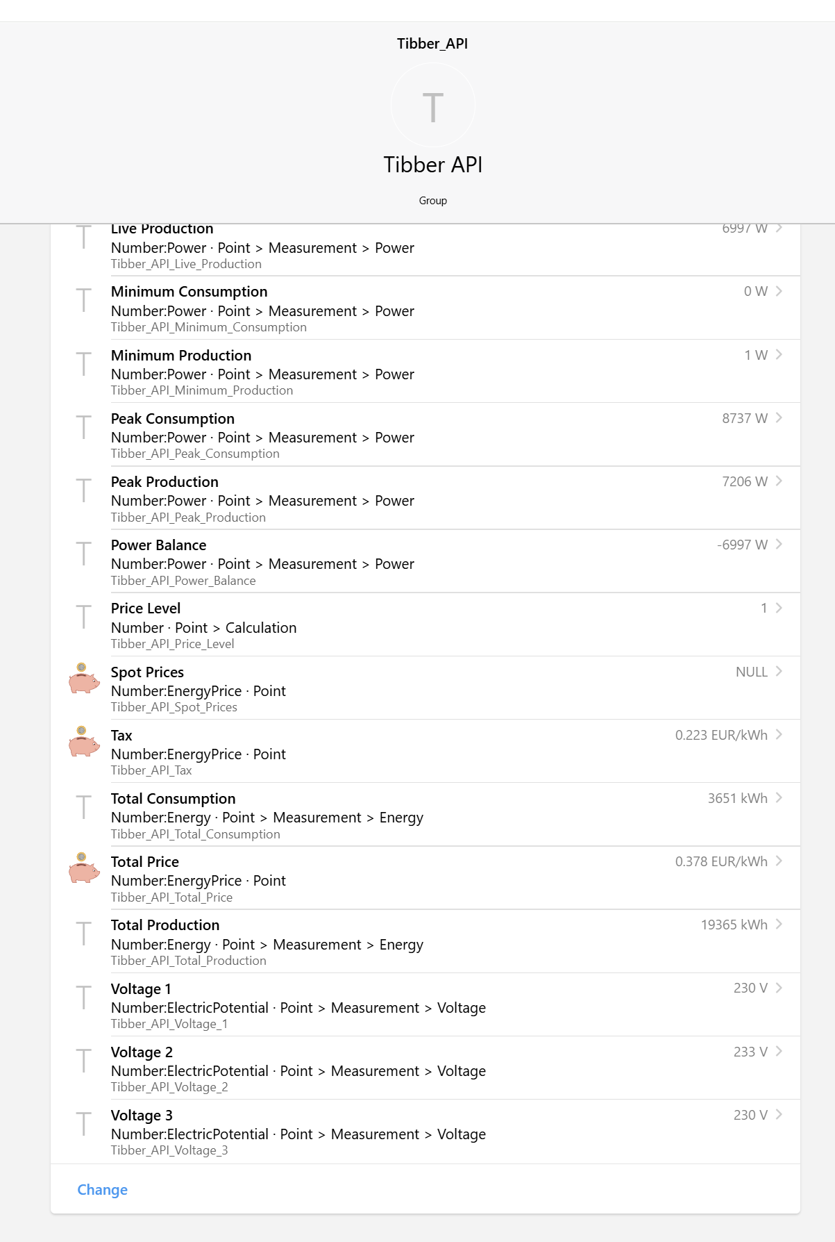

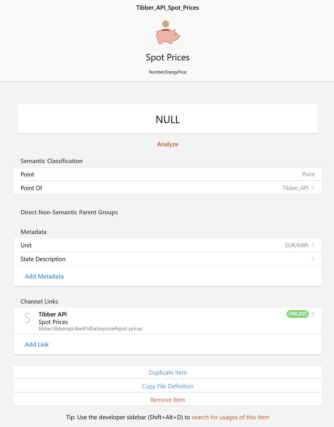

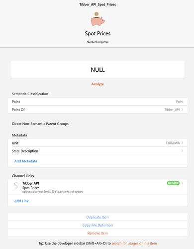

Let’s check your spot price items:
  1. is it attached to the Tibber API group and
  2. connected to the channel?
I’ve used the “Add Equiptment to Model” function to create the items and i think it looks all good :slight_smile:

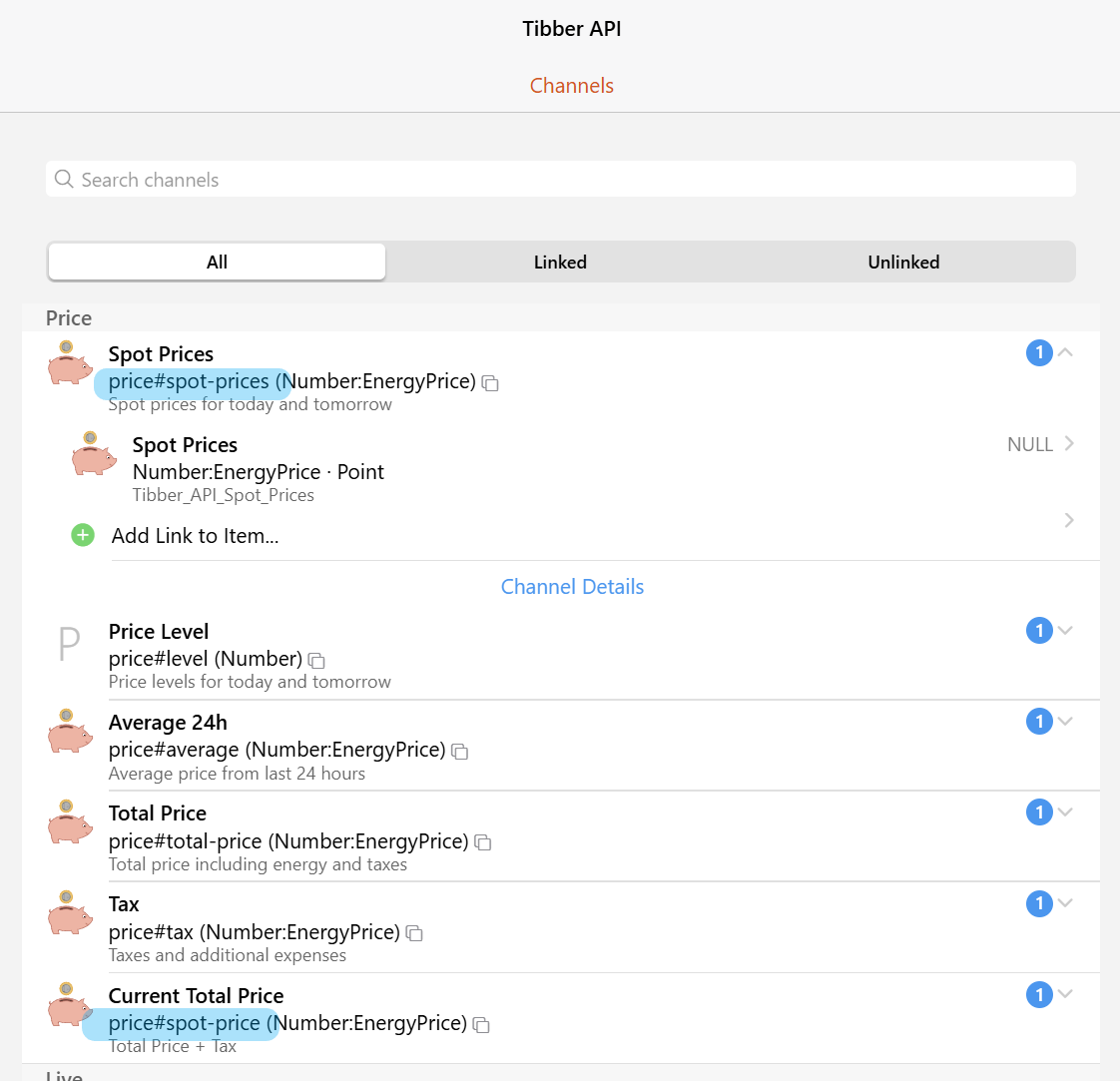

Yes, looks good. Thanks to your pictures I think I know where the problem is.

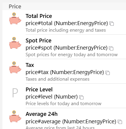

There are 2 channels spot-price and spot-prices
During the official review openHAB maintainers and I discussed a lot about channel naming. In OH5 current release binding contains spot-price which delivers the total price and this is misleading as stated in community post.
Finally we agreed to stay compatible and introduce new channels.
Long story short:
  • Please delete thing
  • uninstall tibber binding
  • install version from Marketplace again - it contains now the final version which will be released with OH5.1
  • Channels shall look like below picture
Thanks a lot!

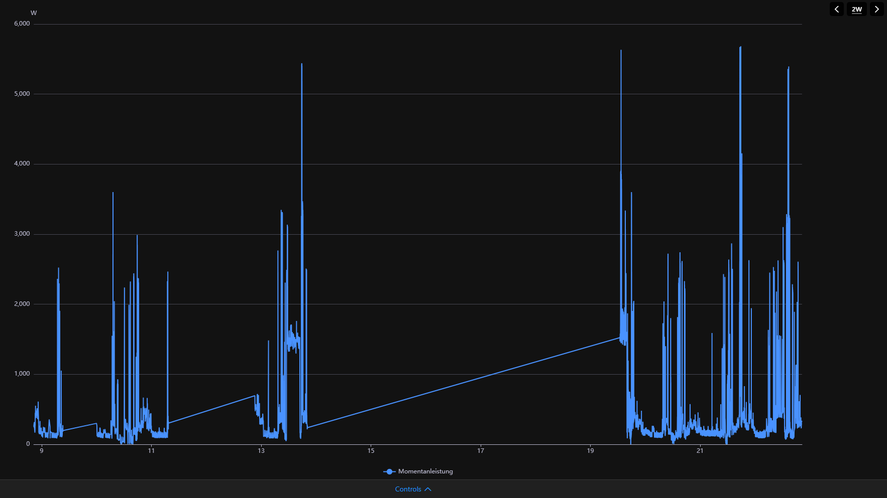

Quick question: My tibber binding sometimes stops working and only starts working again (for a couple of days) when I deactivate and then activate the tibber API-thing:
The topic was also mentioned here, but there wasn’t a solution (but merely a workaround) listed for this problem.
Does anyone know what to do?
never had that issue, since Bernd took over the developement of the binding with 5.x. What version of openHAB and binding do you run?
I’m on openHAB 5.0.1.
But now that you mention it: Do I have the wrong binding installed?
OH5.0.1 (the left picture) is fine.
The right picture is the Marketplace binding containing additional changes requested by community posts
Your graph is showing gaps int the live measurements which is protected with a watchdog which constantly checks the websocket connection.
Please enable trace logging to analyze what’s going wrong.
Thanks for your response. Will do / just activated trace.
What’s odd: The connection appears to be coming back, even if I don’t de-/reactivate the Thing (as seen in the most recent gap in the data: I did not de-/reactivate the Thing).
Will report back once I have more data.
