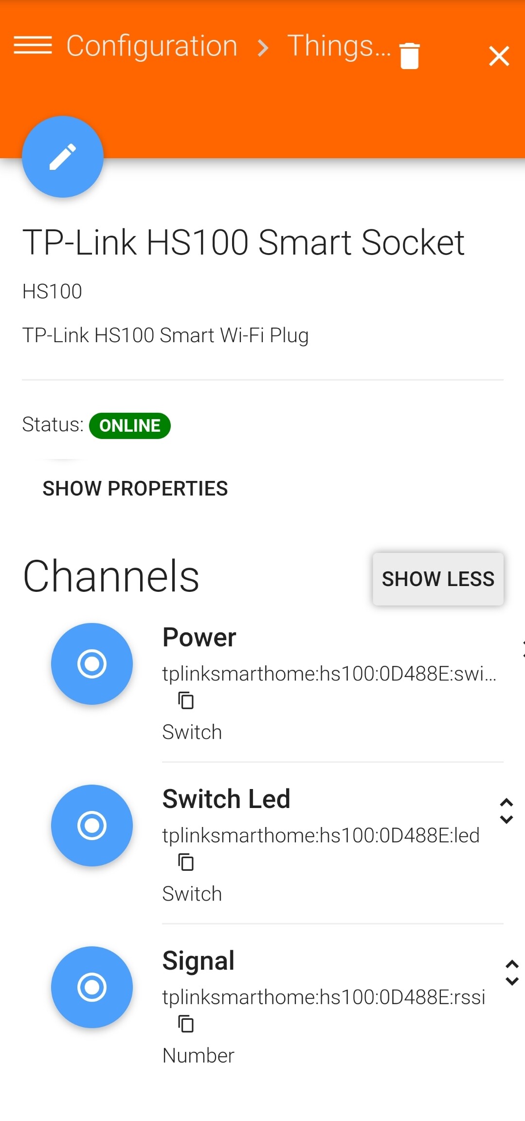

Hi
For me, the RSSI channel is shown in PaperUi, like this

Adding to @MDAR’s note about the RSSI channel, I believe you have to click “Show more” in PaperUI to see/enable it.

Think I’m making progress - I still can’t get Paper UI to autodiscover (even with it right next to the router), but I have found the RSSI channel after manually adding with the IP address. Signal strengths vary between -50dBm and -30dBm. I’ll keep an eye on them over the next few days
