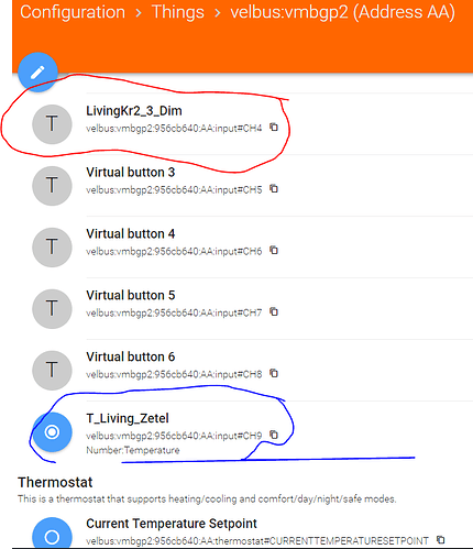

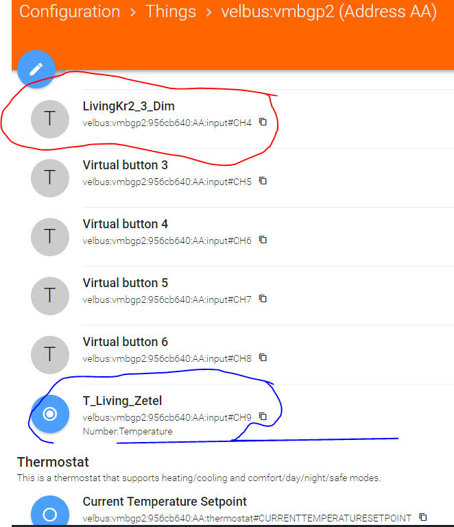

I will try to clarify a bit more.
For example
The red circle is a link to the channel of a pushbutton of a VMBGP4 (link not working)
The blue circle is a link to the temperature of the same VMBGP4 (link is working perfect)
How can i send a pulse to this input channel 4 (pushbutton)?
And is there a way to get the actual status of the statusled from that pushbutton?

Hi David
Just to clarify your screenshot.
The Red circled item is a “Trigger” which can be used in a rule..
channel 'velbus:vmbgp2:***********:AA:input#CH1' triggered PRESSED // Could be RELEASED or LONG_PRESSED
Whereas your Blue circled text can be linked to an Item and as such can be used in a rule thus
Item [Item Unique Name] changed // as an example
