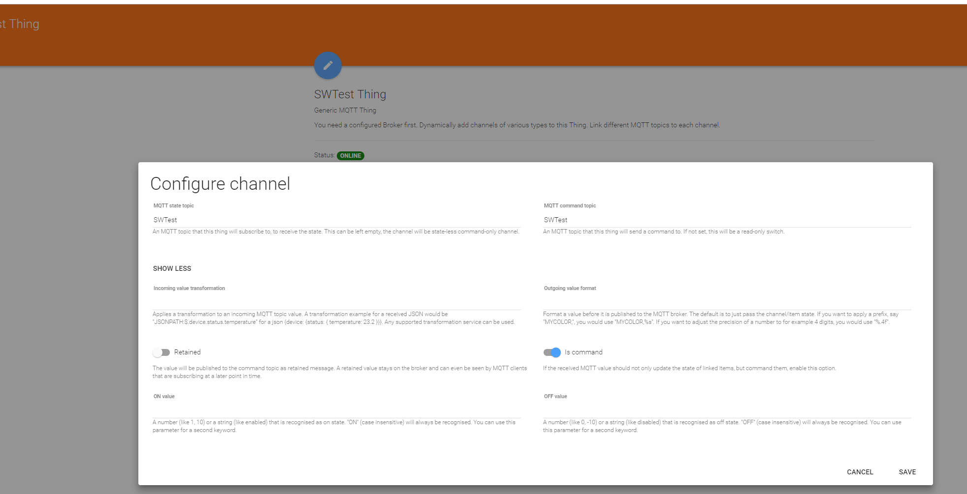

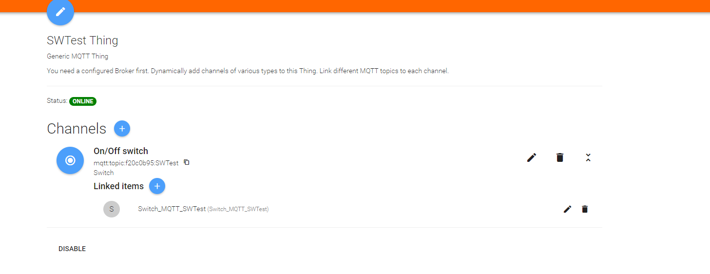

  1. Installed the MQTT 2.x Binding via Paper-UI
    a) Things > MQTT > MQTT Broker
    b) Things > MQTT > ADD MANUALLY > Generic MQTT Thing
    Add Switch
    c) Link a new Switch into the MQTT Switch
In pictures MQTT Things:
Please note that the “IS COMMAND” had to be set (didn’t work for me without)
MQTT Thing linked to Switch
