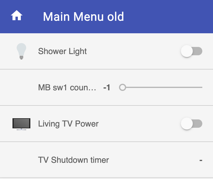

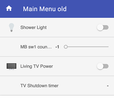

old.sitemap
sitemap old label="Main Menu old"
    Switch item=Light_SF_MasterBedRoom_BathroomLightSwitch1
    Slider item=Light_SF_MasterBedRoom_BathroomLightSwitch1__Counter
    Switch item=TV_FF_Living_Power
    Text item=Kodi1_stop__Counter
here is what I get on sitemap
Slider to change timer on demand.
That’s all.
