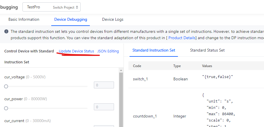

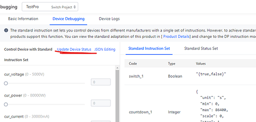

Yes, I cannot control by OH, but get full control from Tuya app.
With my opinion, problem is in firmware of the device. As I remember, I got different results for working and non woking devices when I used iot portal Tuya.
*upd If divice did not work in OH, it did not get status here (control from Tuya aplication): *
