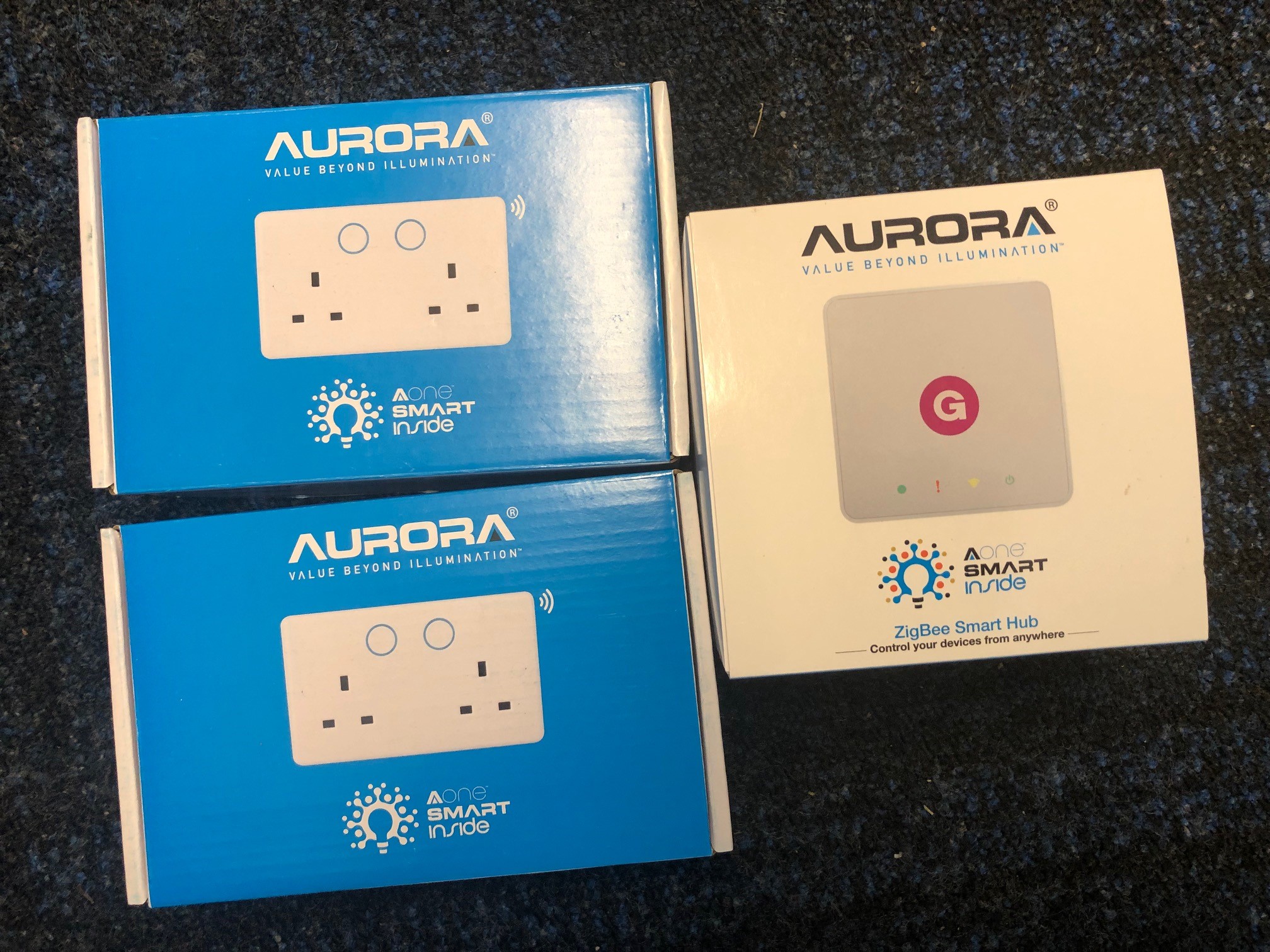

They’ve arrived..
Testing to be done now.
Fingers crossed that they live up to your expectations :smile:

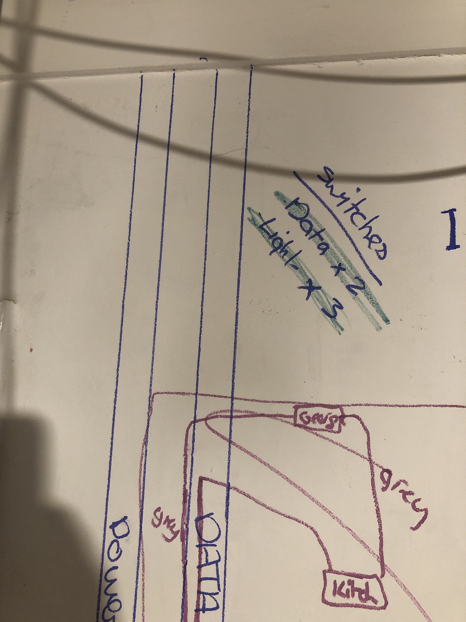

That would be grand if that’s cool, I’ll hold off for a few weeks though, my house is very dusty and upside down atm where I’ve ripped the kitchen out. Should be finished by 3rd week of June though.
I’ve run enough cables tho to incorporate:
@delid4ve - I have similar requirements to you (re:open protocols and local control) and just came across this thread, on paper the sockets look perfect so I was wondering how are you getting on with them? and do they do 2-way communication?

The AOne (Aurora) ones I purchased also still have the major issue that after a power cut they default to the off state.. not good when your fridge / freezer is plugged into it as I found out! ÂŁ500 later :weary_face:
I wonder how your getting on with the AOne sockets? I suppose for the issue with the power cut maybe setup an automation to check the status of the socket and ensure its turned on and if not turn it on?
