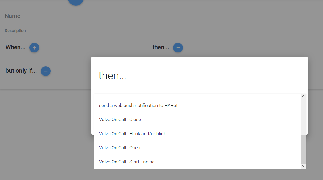

I can see the actions in the ERE in PaperUI:
However, I would like to stay with my regular rules approach using e.g.
CarLock.sendCommand(ON)
Is this possible at all with the separated actions shown in the screenshot above?
I don’t know how to link the action to a regular item to be able to use sendCommand to this item.
Any help is greatly appreciated.

How to address the “channels” available as an action only from a regular rules like a simple:
CarLock.sendCommand(ON) (Where CarLock is just available in the NGRE PaperUI interface).
I understand, that the PaperUI generated rules are stored in jsondb.
My main point is, that I just want to use regular rules only - and not NGRE, because I don’t have access by a web UI like PaperUI to my system at home and furthermore I very much like to have everything centralized in text based rules.
So is there a way to switch those actions without using NGRE?

My problem is, that the action binding of volvo on call just provides actions for ERE.
The only place I can see them is the ERE environment.
So how to trigger (switch by sendCommand) these actions without ERE.

I don’t think that is even possible. OH 2 handles Actions completely different from OH 1 and there is not a separate jar file for OH 2 Actions.
What you need to do is look at the docs for these Actions to find out what the method names are and what arguments they take. You will not be using sendCommand with Actions. Actions are function calls in Rules DSL. Some Actions you may be familiar with
  • sendCommand("ItemName", "Command")
  • postUpdate("ItemName", "Command")
  • executeCommandLine("command", 12344)
  • sendHttpGetRequest("url")
  • createTimer(now.plusSeconds(1), [ | //some code ])
You will have functions to call along these lines. What they are and what arguments they take will come from the documentation for the Actions. I can’t begin to guess what they might be. I don’t know where these jar files came from. Look there for docs.
