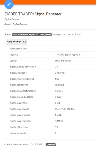

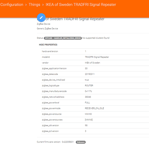

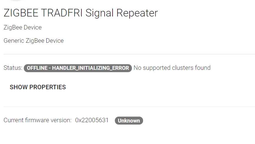

well Paper UI reports it as.
the 2 other guys up in the thread have screenshot added - it always says “offline” with that error shown

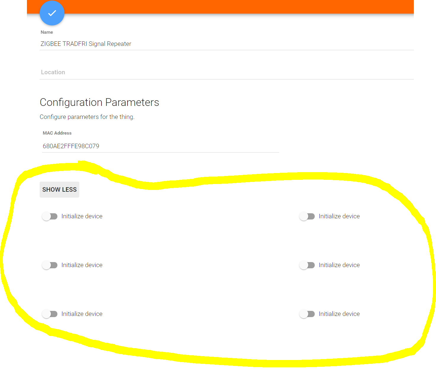

I also get a lot of initialize options in the meanwhile :wink: :wink:

Sure I only want to act as an repeater. Do you mean the state in the UI is fully ok and that is shown as offline with that error message is “work as intented”?
If it is joined to the network, it will work as a repeater. OH can’t provide you any user functionality.
Probably it shows offline as there is no user functions, so the binding doesn’t poll, and there is no reporting.
@chris
well ok then I might be happy already.
the UI does not show any neighbors in the properties for this device … so I interpreted it is not working correctly.
sorry for that … the “offline” state is a little misleading then
