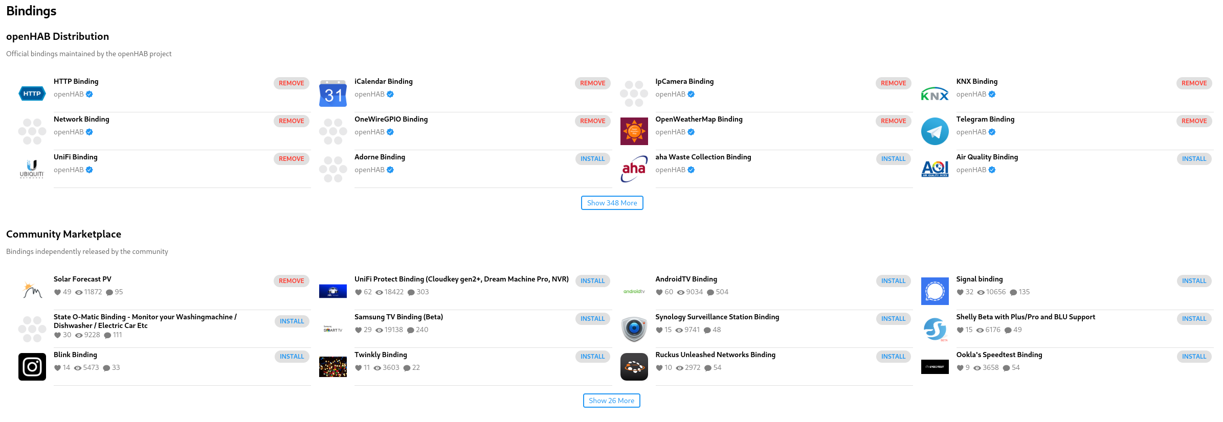

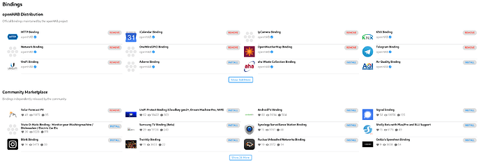

But i got into trouble that 99% of my things are no more online: “Error:Handler” (all KNX, IP Camera, URL…) Only Solarforecast Thing is Online
So it cannot get states from things/items, nothing works any more. So i tried make some restarts and also to use 4.0.1 again but i guess something on volumes was converted.
In log i cannot see a hint how to fix:

interesting: The count of directories in cache and on screenshot of webgui of installed bindings are mismatching
docker exec -it openhab_openhab_1 ls -la /openhab/userdata/cache
total 44
drwxr-xr-x   7 openhab openhab  4096 Aug 24 08:18 .
drwxr-xr-x  22 openhab openhab  4096 Aug 23 09:59 ..
-rw-r--r--   1 openhab openhab 13089 Aug 24 08:18 1692772817522.log
drwxr-xr-x 283 openhab openhab  4096 Aug 28 16:25 org.eclipse.osgi
drwxr-xr-x   2 openhab openhab  4096 Aug 16 17:32 org.openhab.binding.chromecast
drwxr-xr-x   2 openhab openhab  4096 Aug 28 10:27 org.openhab.binding.icalendar
drwxr-xr-x   2 openhab openhab  4096 Aug 16 17:31 org.openhab.binding.openweathermap
drwxr-xr-x   2 openhab openhab  4096 Aug 23 10:00 org.openhab.voice.tts
There are definitively more bindings installed which the Screenshot shows.
And the as installed shown bindings are working but i dont know where they are installed if not in cache-folder…

root@dockerpi01:~/openhab# docker exec -it openhab_openhab_1 ls -la /openhab/userdata/tmp/mvn/org/openhab/addons/bundles/org.openhab.binding.dsmr
total 12
drwxr-xr-x  3 openhab openhab 4096 Aug 16 17:41 .
drwxr-xr-x 36 openhab openhab 4096 Aug 28 11:19 ..
drwxr-xr-x  2 openhab openhab 4096 Aug 16 17:41 4.0.2
root@dockerpi01:~/openhab# docker exec -it openhab_openhab_1 ls -la /openhab/userdata/tmp/mvn/org/openhab/addons/bundles/org.openhab.binding.dsmr/4.0.2
total 164
drwxr-xr-x 2 openhab openhab   4096 Aug 16 17:41 .
drwxr-xr-x 3 openhab openhab   4096 Aug 16 17:41 ..
-rw-r--r-- 1 openhab openhab 151694 Aug 16 17:41 org.openhab.binding.dsmr-4.0.2.jar
-rw-r--r-- 1 openhab openhab     40 Aug 16 17:41 org.openhab.binding.dsmr-4.0.2.jar.sha1
i picked out one binding: dsmr
filesystem in container shows the files, but gui tells its not installed.
docker exec -it openhab_openhab_1 sha1sum /openhab/userdata/tmp/mvn/org/openhab/addons/bundles/org.openhab.binding.dsmr/4.0.2/org.openhab.binding.dsmr-4.0.2.jar
85782d812851850e21d580e4a4d4fcabd331e7fa
and the sum in the sha1 file shows 85782d812851850e21d580e4a4d4fcabd331e7fa so it seems the correct file
