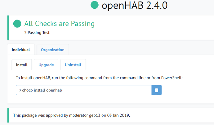

Is the Chocolatey version still being maintained?
Don‘t know, but there was a new Windows installer under development.
Not shure what happened to that one. We need to check the distro repo.
It’s discribed on the openhab download page, but there is no direct link to it.
But only for a new installation, not how to update.

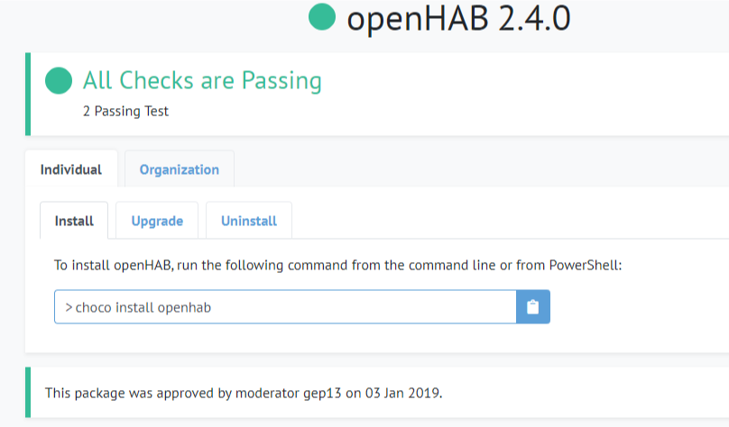

EDIT: On the Chocolatey site there are instructions how to upgrade, but the package is outdated:
It doesn’t look like it. Our docs should be updated to remove it.
from Chocolatey Software | openHAB 5.1.0-M2
Or someone could volunteer to maintain it. :wink: It’s a really nice way to install and manage software on Windows.
