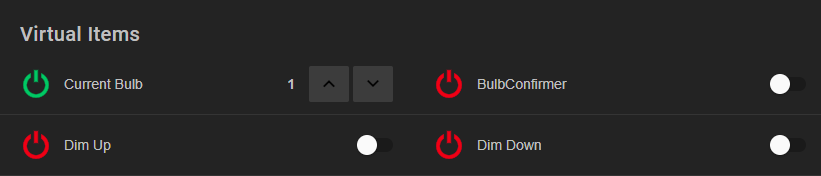

So what Im trying to achieve is the switching between 5 different bulbs, therefore I have made the Virtual Items, “BulbCounterID” for example is used to define which Bulb should be controlled, at the moment I have set up the Switches in Basic UI:
I can switch between the Bulbs with the two arrows (up and down). You can ignore the “Dim Up” and “Dim Down” switches for now. My Problem is, that I would like to enable the currently selected Bulb with the “Bulb Confirmer” Switch. More precise: I want to know why the command:
if (BulbConfirmerID.state == ON) { CurrentBulbVar (ON) }
doesn’t work. Everything works if I just put the Item ID and .sendCommand instead of “CurrentBulbVar”, but if I do that I lose the ability to switch between the bulbs and control them, does anyone have an Idea?
