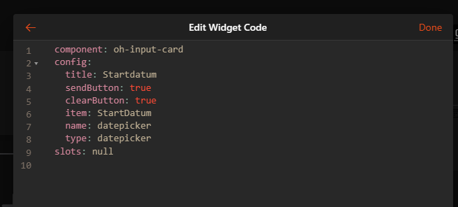

I am now trying to setup a datepicker input but the widget wont save.
do you see whats wrong?
What do you mean “won’t save”? Is there some error?
I’m not a computer so just looking at some YAML without the error message telling me what’s wrong is rarely productive.
Where did you come up with “datepicker” for the type? I think it should be just date. Clicking on the link under the “type” field shows: Inputs / Form Inputs | Framework7 Documentation
What type of Item is StartDatum?
Look at DateTime Standalone Widget and DateTime List Item for working examples using a full date and time picker. You should be able to just change the type to date.
You can’t just delete all the lines above component when creating a new widget. Your widget won’t save because it doesn’t have a uid; there is no identifier for the widget to be saved as.
At the very least you need to have:
uid: someAlphaNumericIdentifier
at the top of your widget. Even then, you will see that when you do save it, all the other lines get added back in as empty properties.

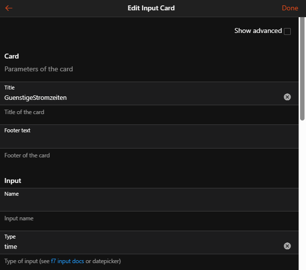

I am now trying to set up an input card with a DateTime Item. But i only want to show the Time. The problem now ist that if i just use the type “time”, the time is not shown after i e.g. reload the page. It is saved in the Item though with the correct time.
working with the item and all works, but it just doesnt show the time whats saved in the item.
Is the problem with the Type DateTime from the Item because it always needs a full input?
Do you guys have any idea on how to solve that?

I think you’re going to have to put in a feature request in the OH UI repository. It doesn’t look like the oh-input is currently configured for this. Right now the oh-input identifies any use of a date based input type and then performs specialized formatting of the item state to match that input type. However it bases that identification on whether the string "date" is found at the front of the type parameter. So, a type of time is not detected as a “date” input type and the pre-existing item state is not formatted.

I will create a PR to fix this.
PR created: Support time in oh-input widget by mherwege · Pull Request #2214 · openhab/openhab-webui · GitHub
