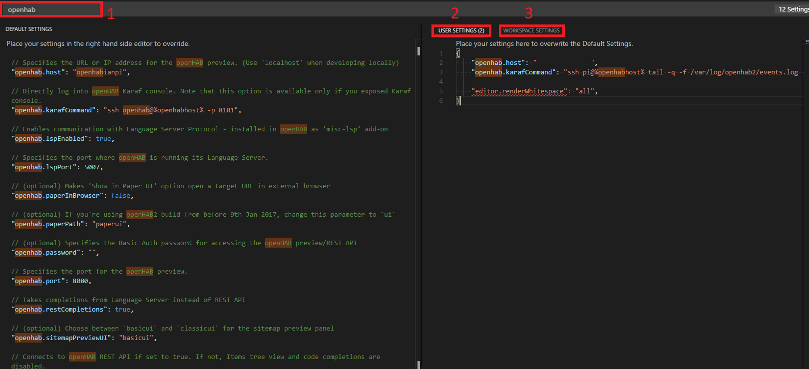

@kevin at the left are the standart settings.
At “1” you can type openhab and then only the openhab related settings will be displayed.
At “2” are the user settings, i have only this three.
At “3” are the workspace settings, these are empty in my case. Make sure you don’t have concurrent settings.

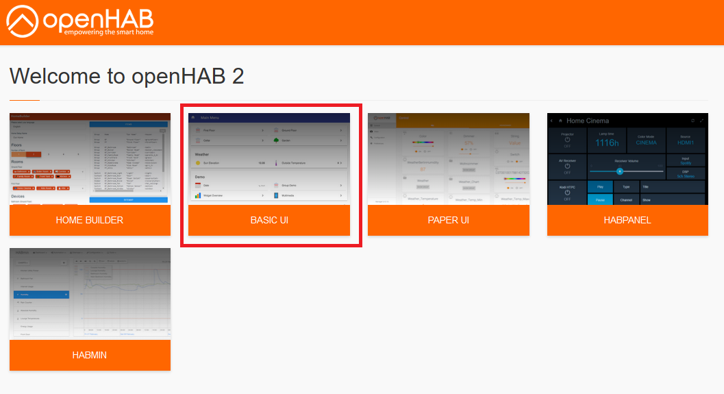

Also you have to have basicUI enabled in your configuration! Just saying.
I have my config folder listed in picture 1 item 3, and if I delete it I get presented with “you have not yet added a folder to the workspace,” “Add Folder” button which I then click and the entry reappears.
I do have BasicUI Installed as well as Rest UI, PaperUI, Habmin and Habpanel.
My Workspace settings
"settings": {},
"folders": [
		"path": "V:\\openhab2\\etc\\openhab2"
I just changed Picture 1 item 2 to match yours albeit with my servers ip address and nothing has changed. Essentially I am editing at a file level with autocomplete for the currently open file only
