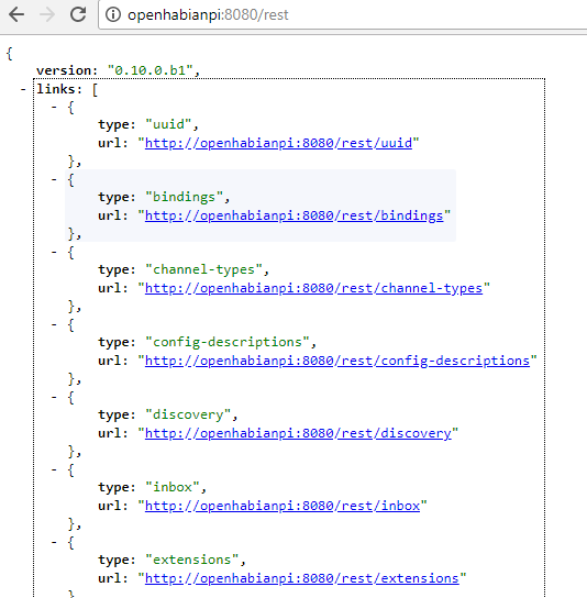

Is there any way of checking that it can access Rest and anything else that it needs? I can see a bunch of JSON formatted text in a web browser if I type in
http://xxx.xxx.xxx.xxx:8080/rest
Does that mean rest is OK?
If it look similar to this, yes:
Which version of the Extension are you using?
Yes it looks similar albeit with worse formatting which is likely down to browser version. I’m using version 0.3.5
