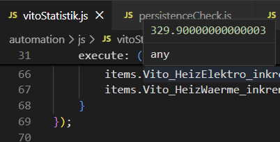

It was just one line of code and now the extension also has mouse over on js files:

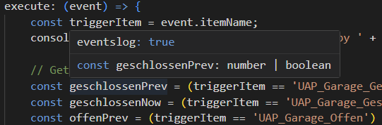

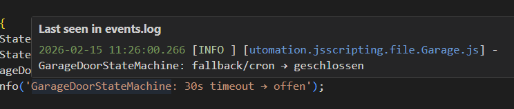

I just updated the extension. Tooltip now also reports variable states if found in the log. All you have to do is log the variable. E.g. myVariable=”state” should appear in the log and when you mouse over it looks like this:
If the string is found in the log and has no = “..” formatting, it looks like this:
