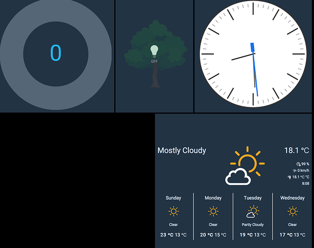

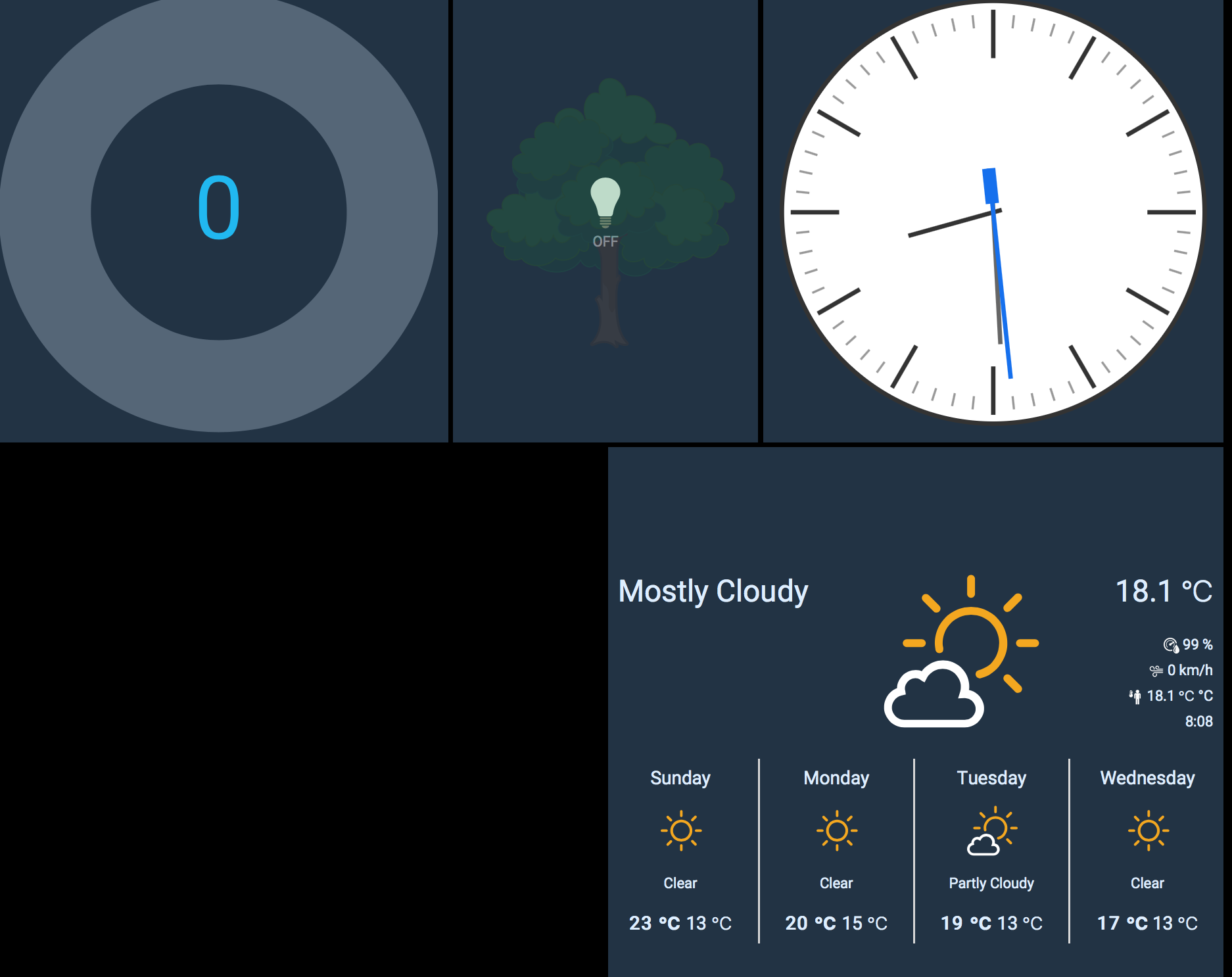

The images did end up syncing and the “feels like” temperature got closer to right. Thanks for your help.
I noticed most screenshot examples in this thread the large conditions image didn’t match up with the conditions text. I ended up changing this line:
<i class="wu wu-{{IconSet}} wu-256 wu-{{itemValue('Weather_ConditionId')}} current-icon pull-right"></i>  to  <i class="wu wu-{{IconSet}} wu-256 wu-{{itemValue('Weather_ConditionId0')}} current-icon pull-right"></i>
I added a zero to Weather_ConditionId to get the image to match up with the conditions text.

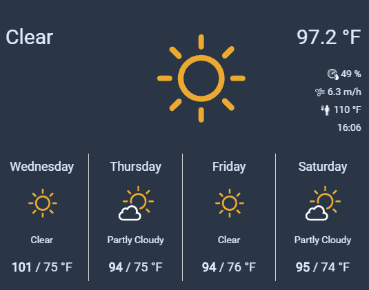

Because wu is no longer distributing free api keys and i like this widget, i used it in combination with the weather binding (openweathermap). And i only had to switch the items channels. Works excellent. Except… these images :slight_smile:
The weather condition images won’t show up. The widget json construct a css class based on the conditionID. For example it constructs a css class wu-800 for clear weather (see Weather Conditions for conditionid table)
When i look into the CSS file wu-icons-style.css this class doesn’t exist. It uses the class wu-clear. But that is not the conditionId, it is the conditionText.
I can fix this easily by changing the classnames in the wu-icons-style.css file. But it is a bit strange that nobody notices this problem with wundergroudn binding. Can somebody confirm that the channel="weatherunderground:weather:local:forecastDay2#iconKey returns a number or what am i missing?

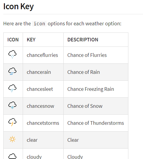

The icon key returns a string such as “clear” not a number.
You can see where how the keys map to the cons on this page.
https://www.npmjs.com/package/weather-underground-icons
Shows:
<i class="wu wu-{{IconSet}} wu-64 wu-{{itemValue(‘Weather_ConditionId2’)| lowercase }}">
‘Weather_ConditionId2’ is mapped to {channel=“weatherunderground:weather:local:forecastDay2#iconKey”}

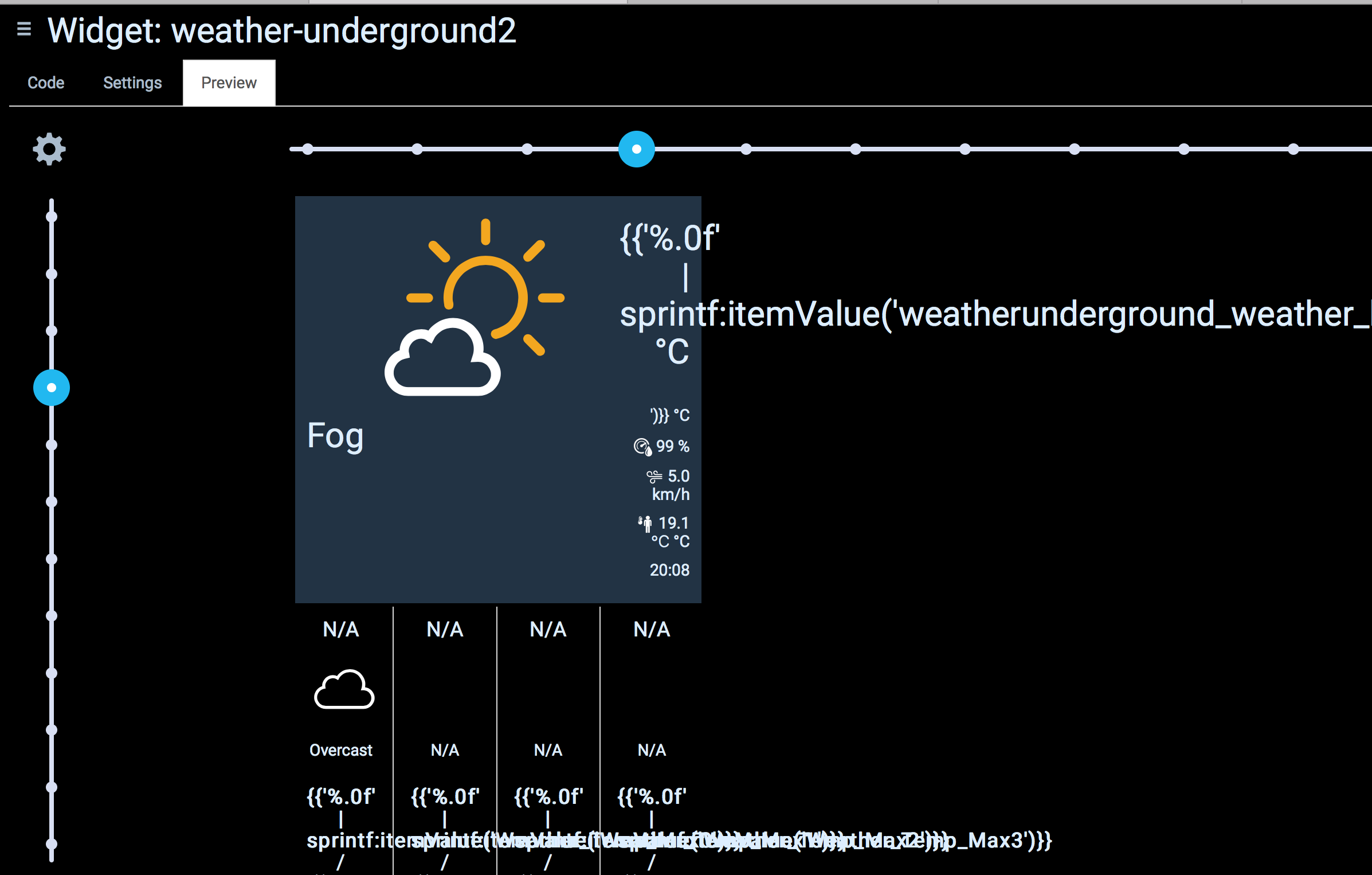

I have been trying for days to understand the sprintf issue and why I get the error expecting number but found string. I have set it up using PaperUI and can get everything working and understand the logic, but this has me beaten!
Probably the item declaration is different (capitals?) then the item name used in the widget. Could you check these are the same names?
The console error shouldn’t be a problem, i had them too and it worked. I did change the widget to get rid of this console error, just beause i don’t like errors :slight_smile:
replace:
{{‘%.0f’ | sprintf:itemValue(‘Weather_Temp_Max1’)}}
with:
{{itemState(‘Weather_Temp_Max1’) | number:0}}
do that for all items containing sprintf.
If i can find some time i could make a pull request adding support for weatherbinding and fix these js errors, but mwah.
When you say you changed the widget? Which did you use? Is it possible also to share your widget code? Much appreciate the help.
At the screen from your screenshot you posted, go to tab ‘Code’ and:
replace:
{{’%.0f’ | sprintf:itemValue(‘Weather_Temp_Max1’)}}
with:
find other sprintf occurences and change the lines occording to the above example. Not able to provide the widget at the moment, maybe later.
