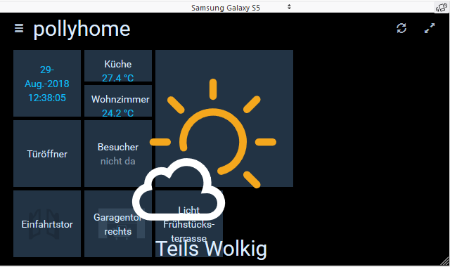

thanks for the widget, I finally got it up and running.
how can I choose the iconsize so it will fit my android phone?
I can see that icons are available in different sized, but how do I get the widget to choose the right one?
thx
EDIT: found out how to change the icon size:
<i class="wu wu-{{IconSet}} wu-64 wu-{{itemValue('Weather_ConditionId')}} current-icon pull-right"></i>
changed wu-256 to wu-64 shows resized images…
if I want to change the font size I need to edit h5 to h7… the higher the number the smaller the font???
<h5><img style="height:16px;" src="{{ServerPath}}/images/humidity.png"/> {{itemValue('Weather_Humidity')}} %</h5>
shouldn´t that somehow work automatically?

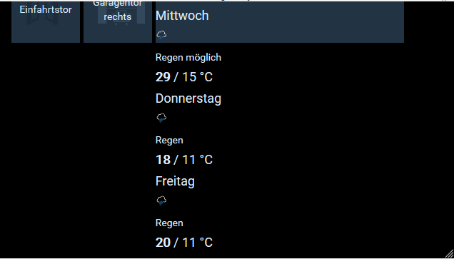

my new problem is this:
forecast is from top to down…
someone knows how to change this?

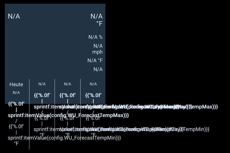

I had this widget working once but when I tried to set it up again after a clean OpenHAB2 install, I can no longer get it working. This is what I’m seeing:

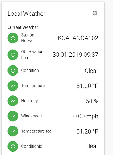

I have the WeatherUnderground installed and configured correctly and am receiving weather data:
I’ve followed the widget set up instructions exactly a number of times on clean OpenHAB 2.4.0 installs but I’m not getting anywhere. I tried most of the recommended tweaks and fixes in this thread to no avail. What could I be missing?

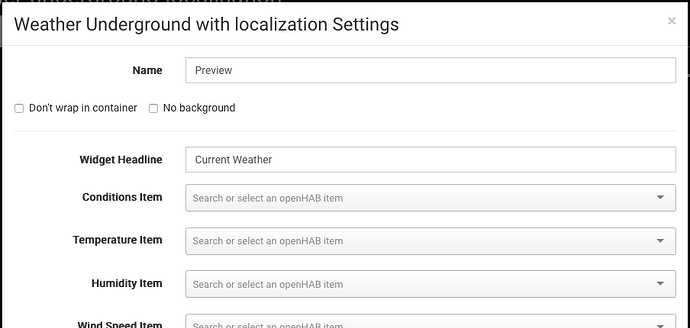

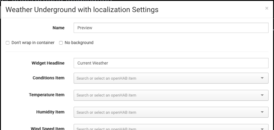

Should the localization settings be populated? Mine don’t seem to be but I don’t recall having to touch them when the widget did work:
