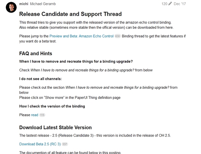

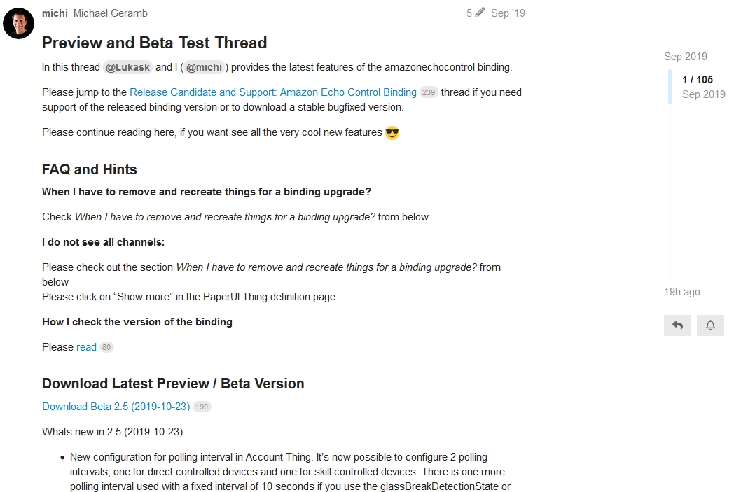

Have you ever read this:
Namenlos
you see:
there is no date for File Beta 2.5 (RC 3)
that´s why you follow the first link in the post:
" Please jump to the Preview and Beta: Amazon Echo Control Binding thread to get the latest features if you want do a beta test."
you find the page:
ther you were tolld to install latest Download Beta 2.5 (2019-10-23) …
and so you were send round and round and round …
Can Michi please organise or better stop this vicious circle by fill in jar-file DATE - so everybody can see what is the newest stable!
Cheers
Stef
