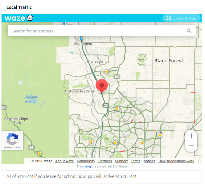

  1. Finally, I’ve a widget that shows the current traffic conditions. It also shows a caption under the map which is the contents of that School_TravelMessage. This gets updated every time the travel time is calculated so I can visually check and quickly see what the commute is going to look like before the announcement.
Note the pin is roughly halfway between my home and the school to center the map where I can see the traffic over the roads I need.
This widget is on the marketplace at Embedded Waze Live Traffic Map Widget. There is also a Google Maps version at Embedded Google Maps Widget which is a good choice if you only care about the one route between two points instead of the general traffic conditions over an area. The Google Maps version requires a Google Developer account and API key. Waze’s API is open and doesn’t require anything.
With 1 through 3 combined I’m able to get a heads-up in the morning and easily check when I need to leave to arrive on time without it being annoying.
