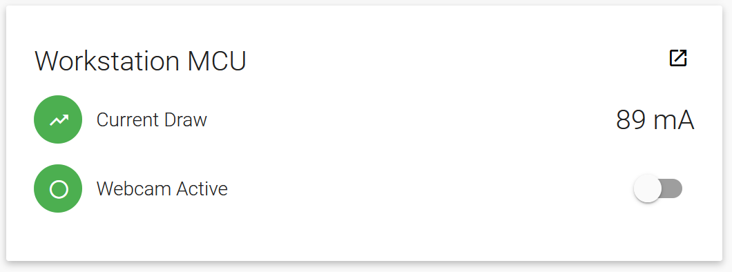

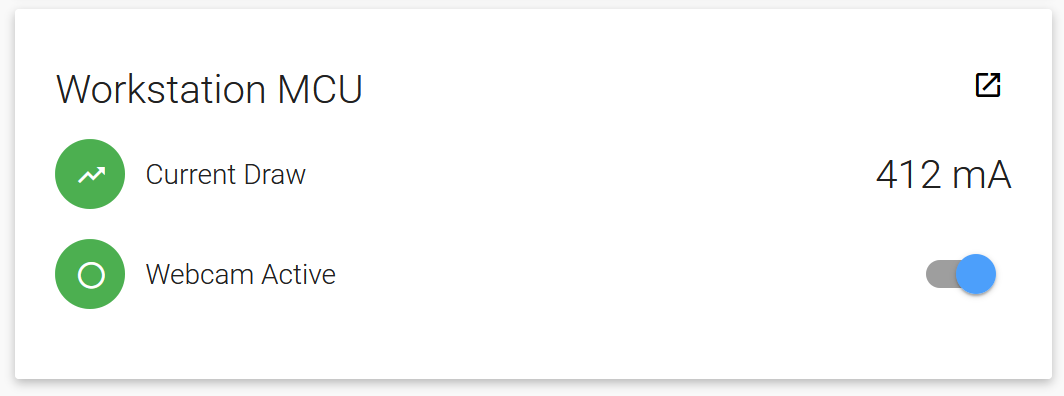

Finally, a couple of days ago, I realized there’s another way to solve it. Why not just measure the power consumption of the webcam? Surely it uses more power when it’s active?
Time to get to work!

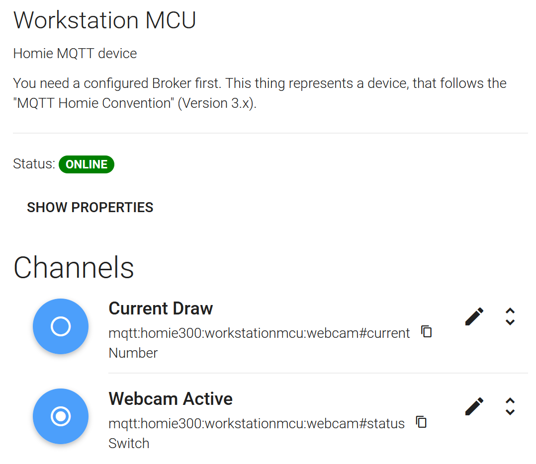

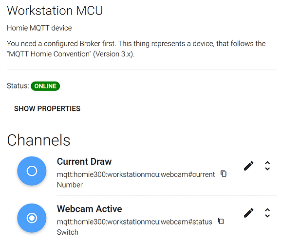

That’s an ESP8266 microcontroller (with wifi) and a ACS712 current sensor board.
Then, after some software magic:
com-video-to-gif(1)
Success! Lights turn on automatically whenever the webcam is on. So, now people can see me, and there’s no need to cover the webcam anymore – if it’s on, I’ll know!
Updane: I had to make some revisions. At first, I was powering the ACS712 and the ESP8266 (NodeMCU) from the same USB 5V source as the webcam (before the current sensor, obviously). However the webcam caused enough of a current draw for the value to read negative when the webcam was activated. I modified the design to take power from a separate USB connection, so that the webcam no longer affects the power supply of the circuit, and now it works much better. I’m also now reporting the actual power consumption in milliamps too.

You just gotta love everything that is possible with the esp8266 based boards and the myriad of sensors available for them. Do you do the logic on the wemos side or do you transmit the raw data to openhab and do the conversion to a switch item based on some threshold in rules there? Nice work.

The logic is on the MCU, the data enters openHAB as an MQTT Homie Boolean: Webcam active (true or false).
