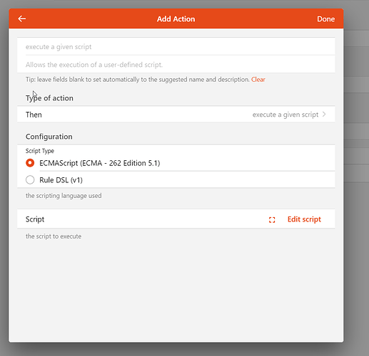

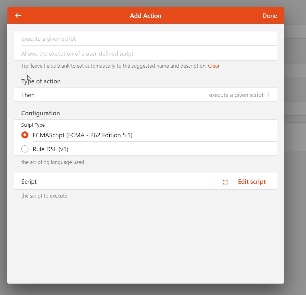

But still, it doesn’t appear the option in the UI:
Any help or direction where to look or a workaround to be able to test my script will be heavily appreciated.

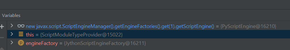

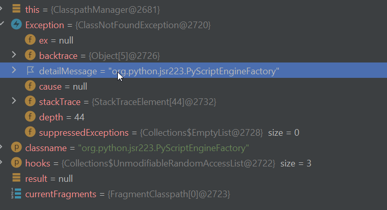

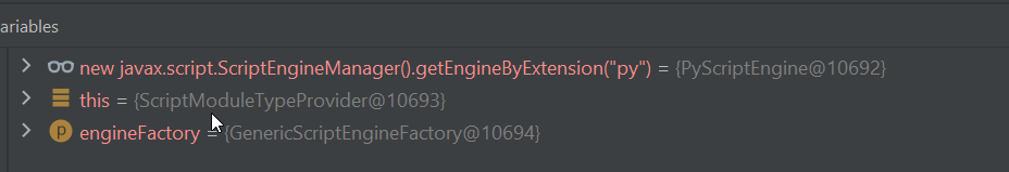

@5iver I’ve been debugging it and althought I haven’t found the original problem I found something.
Initially, before org.openhab.core.automation.module.script.internal.provider.ScriptModuleTypeProvider#setScriptEngineFactory is called for each engine I can get the Jython script engine:
And create it:
But when scripts start to register and it takes the turn of Jython, just after this is called (before the createSCriptEngine is called alls ok and watchpoint is able to create engine:
public void setScriptEngineFactory(ScriptEngineFactory engineFactory) {
    ScriptEngine scriptEngine = engineFactory.createScriptEngine(engineFactory.getScriptTypes().get(0));
But after, It brokes the PythonEngine and then getScriptByExtension("py") always returns null.
Can it be a problem in module classpath, and that when Jython engine is tried to be created inside the module classpath it breaks?
The real error has been difficult to caught because ScriptEngineManager silently ignores exceptions.
