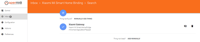

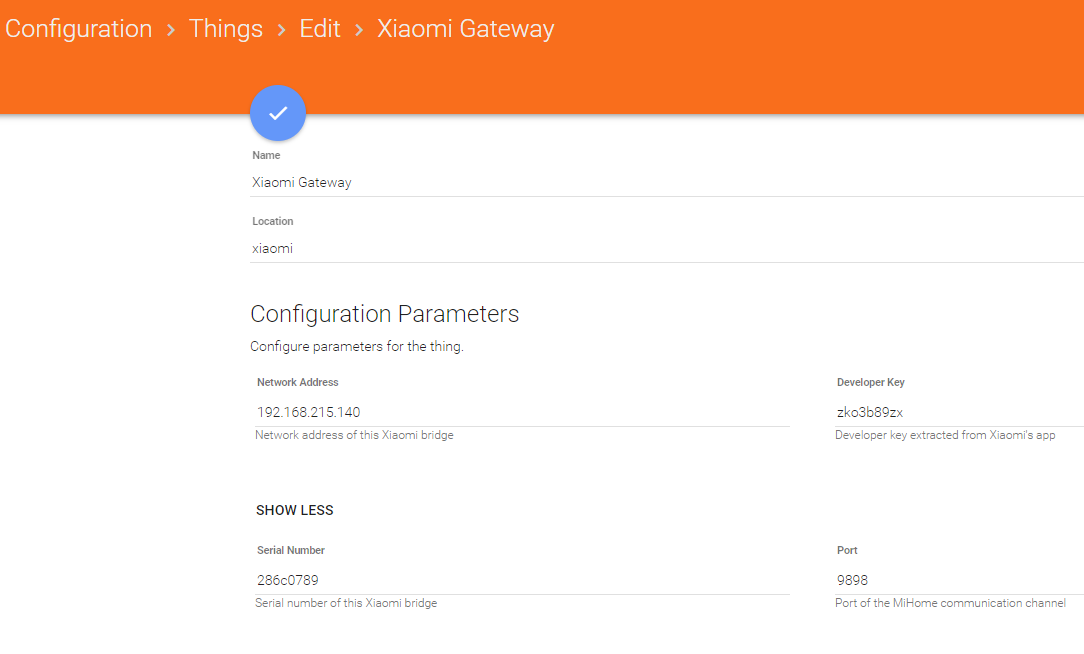

third screen, MiHome device ID
Yes, I have read the thread (not everything, too long :-). Your print screens looks the same as mine, except I have a different MiHome device ID (of course). I got the ID from the Mi Home app in about, gateway information and from there the β€œmac” ID. The gateway hasn’t shown up in the inbox so I had to add the gateway manually (thing) and enter the ID. BTW, my gateway is version lumi_gateway.v3.
es, I have the same!

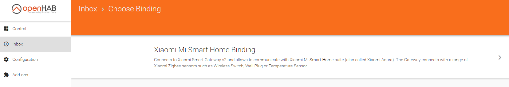

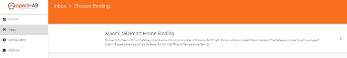

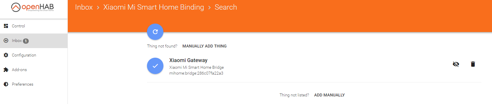

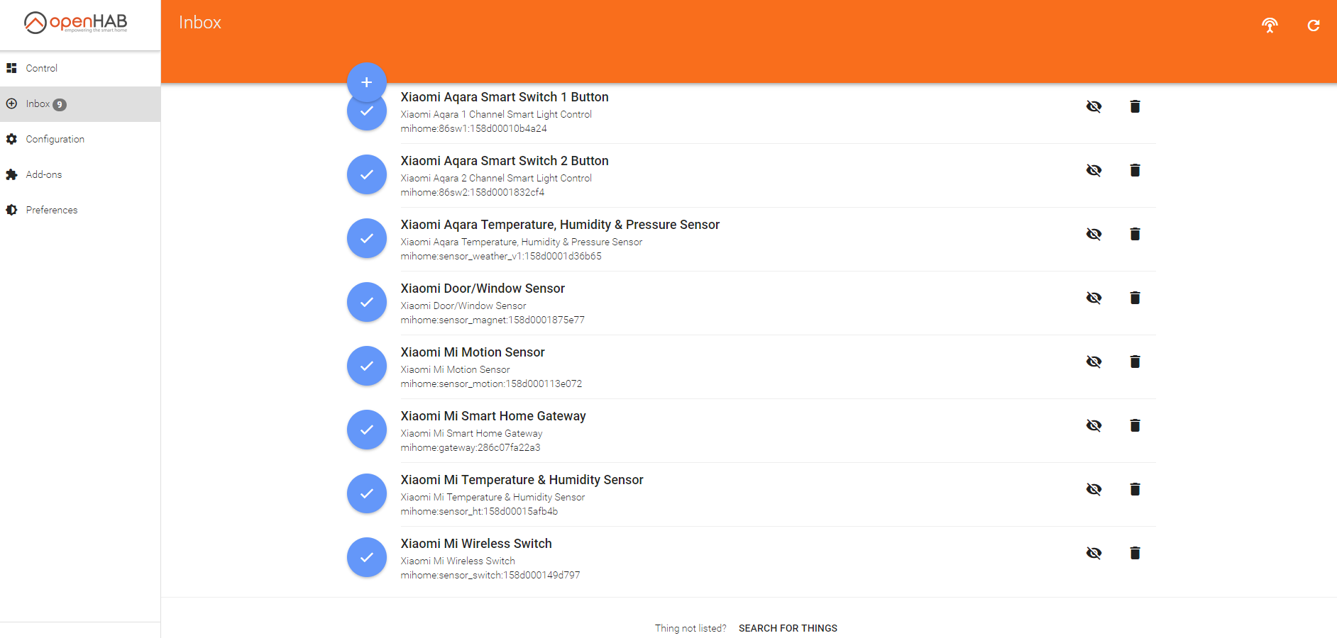

new (clean) installation of OpenHAB
add a gateway to the android application
add sensors in the android application
I press +
here, too, I click
here, too, I click
automatically appear sensors, added in the application android
I did not enter the developer key, it is needed for the gateway itself, for example it is possible without it
well, then we add things, create a file of items as written in the first posts, now there is no time, if necessary, tomorrow I’ll finish it, but I think you do not even have to work here
