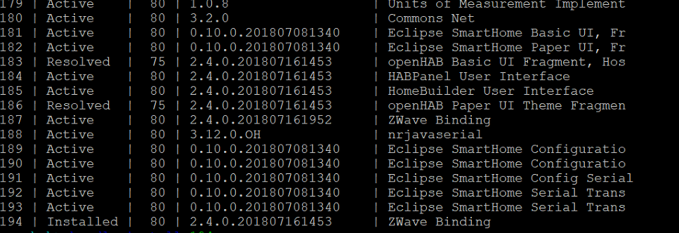

No - don’t uninstall this one. This one is running, and it is the right one. The other one doesn’t really matter, but you can uninstall it as mentioned (except it’s bundle id 194).
Bundle IDs are not related to the age of a bundle. The ID is an incrementing number, so if you install an older bundle, after a newer bundle, it will have a higher ID. Basically, the date on the bundle is the date the bundle was created (ie compiled), while the bundle ID is allocated at the time the bundle is loaded into the system.
