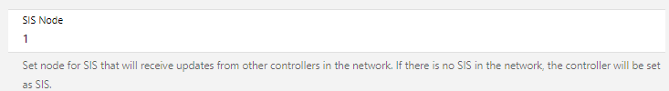

I have seen an issue where the 3.3 version was validating the settings of one of my controllers and failing so the controller did not initialise. I was not sure if it was a bug as other controllers I tested worked. The fix was to edit and save the SUC id a few times. There was no error shown on the UI.
Does this sound like your issue?

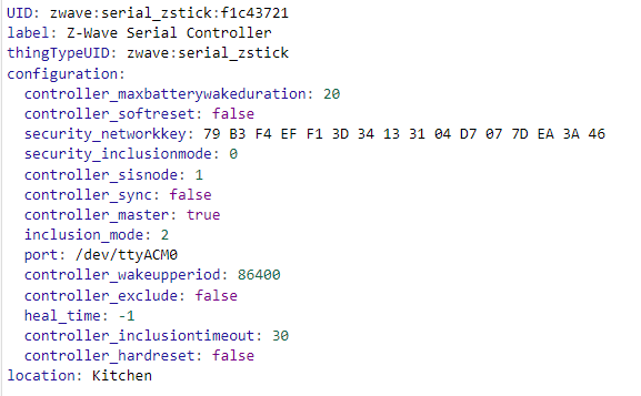

not sure if this is the same issue. I have tested with my backup controller (similar hw model ZMEUZB) and had the same issue. There was actually no error shown on the UI, the bridge was just saying it’s in unitialized state.
I have no thing file for the controller, so I’m not sure how to edit the SUC id and test if this would solve my issue?

It is the SIS node setting under advanced settings that was the issue with the controller that had an error. It was blank rather than set to my controller id.
When setting it to 1 as it should be it behaved strangely and took a few saves.
I think there were changes to the configuration validation recently and it certainly caused issues for slave device configuration so possibly connected.
thanks, but I have double checked and the SIS was already set to 1

sure, here is the output (actually before downgrade - but I assume it has not changed by OH version)
UID: zwave:serial_zstick:5045e1bf
label: Z-Wave Serial Controller
thingTypeUID: zwave:serial_zstick
configuration:
  controller_softreset: 0
  security_networkkey: xxxx
  security_inclusionmode: 0
  controller_suc: false
  controller_sisnode: 1
  controller_sync: 0
  controller_master: true
  inclusion_mode: 2
  port: /dev/ttyACM0
  controller_wakeupperiod: 3600
  controller_exclude: false
  heal_time: 2
  controller_inclusiontimeout: 30
  controller_hardreset: 0

maybe it’s related to the following attributes which should be boolean instead?
 controller_sync: 0
I will move the thing configuration to config file and try to change the parameters

after “fixing” the wrong configuration parameters (actually I have migrated from UI to .thing configuration and just removed those 3 parameters) my ZWave controller thing came back online - and all Zwave Nodes as well!
Below my actual .thing configuration
Bridge zwave:serial_zstick:5045e1bf "ZWave Controller ZMEUZB" [ port="/dev/ttyACM0", controller_master=true, heal_enable=true, security_networkkey="xxx" ]
and corresponding UI controller code page:
label: ZWave Controller ZMEUZB
configuration:
  controller_softreset: false
  heal_enable: true
  controller_sync: false
  port: /dev/ttyACM0
  inclusion_mode: 2
  heal_time: 2
  controller_hardreset: false
