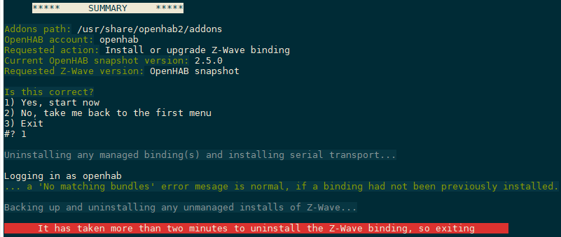

Latest clone of git, script does not uninstall on 2.4. Here are the log entries of the attempt.
2019-11-15 19:54:37.751 [INFO ] [ing.zwave.handler.ZWaveSerialHandler] - Stopped ZWave serial handler
2019-11-15 19:54:48.801 [INFO ] [ing.zwave.handler.ZWaveSerialHandler] - Connecting to serial port '/dev/ttyUSB0'
2019-11-15 19:54:48.821 [INFO ] [ing.zwave.handler.ZWaveSerialHandler] - Serial port is initialized
2019-11-15 19:54:48.860 [INFO ] [ve.internal.protocol.ZWaveController] - Starting ZWave controller
2019-11-15 19:54:48.863 [INFO ] [ve.internal.protocol.ZWaveController] - ZWave timeout is set to 5000ms. Soft reset is false.

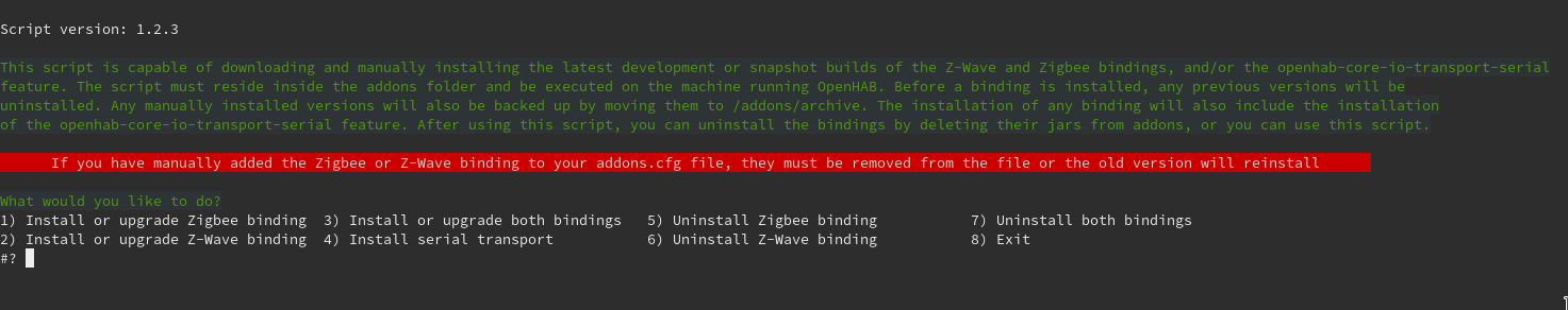

Hi All,
I just executed the zzManualInstaller.sh and this is the result:
What am I doing wrong.?
I’m currently on rasp2, Openhab 2.4.0-1 (install from image)
Which version of the script were you using? The script should update itself, but maybe you did not allow it to?
I downloaded the openHAB-utils-1.2.3.zip
If that is what you mean?
The version of the script is the very first thing displayed…
1.2.3 is the latest. Others have reported some issues using the script with OH 2.4, but I did not have issues when I tested it with 2.5. If it is not working for you, try following the manual install instructions in the README.md. I’ll look into it.
Hi @5iver,
I relaunched the script (version 1.2.3) but decided to take option 6: Uninstall Z-wave binding.
When completed then launched the script again with option 2:Install or upgrade Z-wave binding
That did the job!!
Script completed without errors, z-wave binding installed.
The reason why @chris sugested to upgrade (strange behavior of some new devices) seems to be solved(although I going to play around with these now)
Thanks again to all!!
Mario
I just deployed a brand new Raspberry Pi 4, running vanilla Openhabian latest version and tried the latest script version 1.2.3. It fails with the 2 min time-out (both for zigbee and z-wave). It feels like the simplest of test cases, what could possibly be wrong with my setup?
Which version of OH?
Latest as of today, 2.4.0-1.
I just tested the script on 2.4 and installed both zwave and zigbee. The first attempt timed out due to the dependencies not being installed, which is possibly a timing issue. The files were in place, so an OH restart would have resolved it. Instead, I used the script a second time and it completed successfully.
So, if you are having trouble, like the 2 minute timeout, then restart OH or run the script a second time.
I restarted OH and that did the trick! Thank you!
