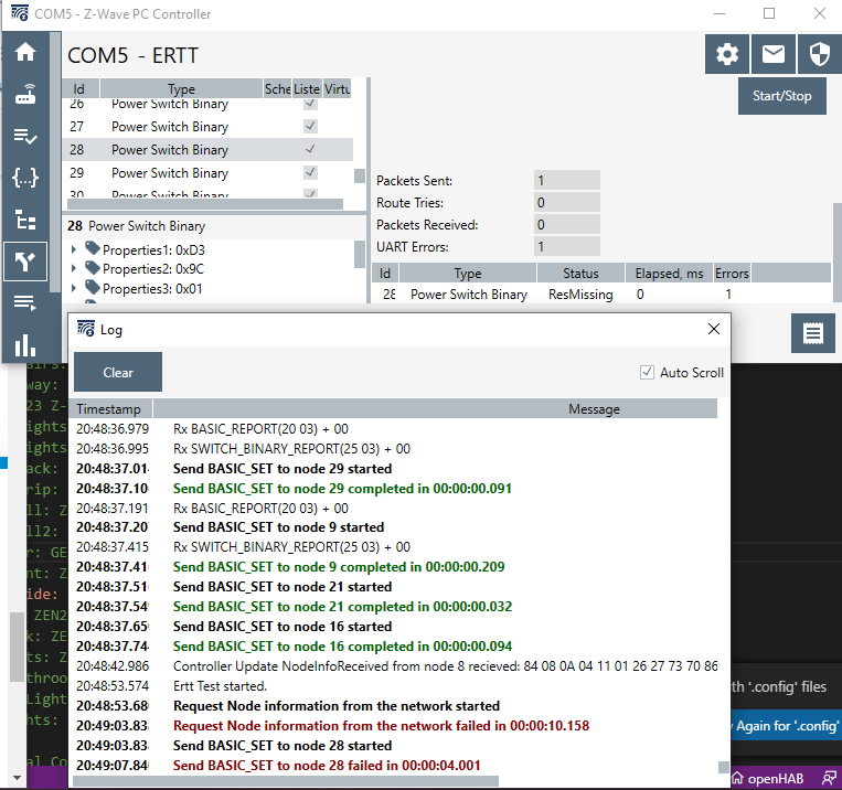

It didn’t take too much to reproduce the error state with PC Controller. I added many nodes to the ERTT test, as you suggested, and my zstick has stopped responding. It seems frozen because the LED ring light has stopped changing colors. I left the delay at 100 ms between commands.
I tried many different test sequences and I noticed that if I include node 28 in the test sequence, it causes my failure. In fact, if I test node 28 by itself the zstick stops communicating. I think I will try testing each node one at a time and then exclude all the nodes that are causing my failure.
I wonder if this means I have a bad zwave light switch?

The log from openHab failed during a send to a different node but that does not say that node 28 did not send an unsolicited report that froze the stick.

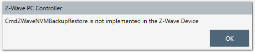

EDIT: It turns out that the PC Controller software reports that the Aeotect Gen5 zstick does not support NVM backups.
