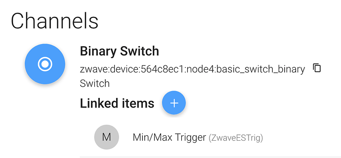

Looking in the Paper UI shows me this:
=> basic_switch_binary
Will try both :slight_smile:

Hmm. I don’t think I’ve ever seen a channel named like that.
In the database it just shows switch_binary.
Device%20List%202019-01-04%2010-30-06
It seems that both versions work :thinking:
When changing the channel in the items file to either basic_switch_binary or switch_binary gives the same output for Linked items in Paper UI:
When changing to channel to something else like binary_sensor it does link it via Paper UI …
I leave it to switch_binary
