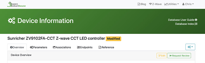

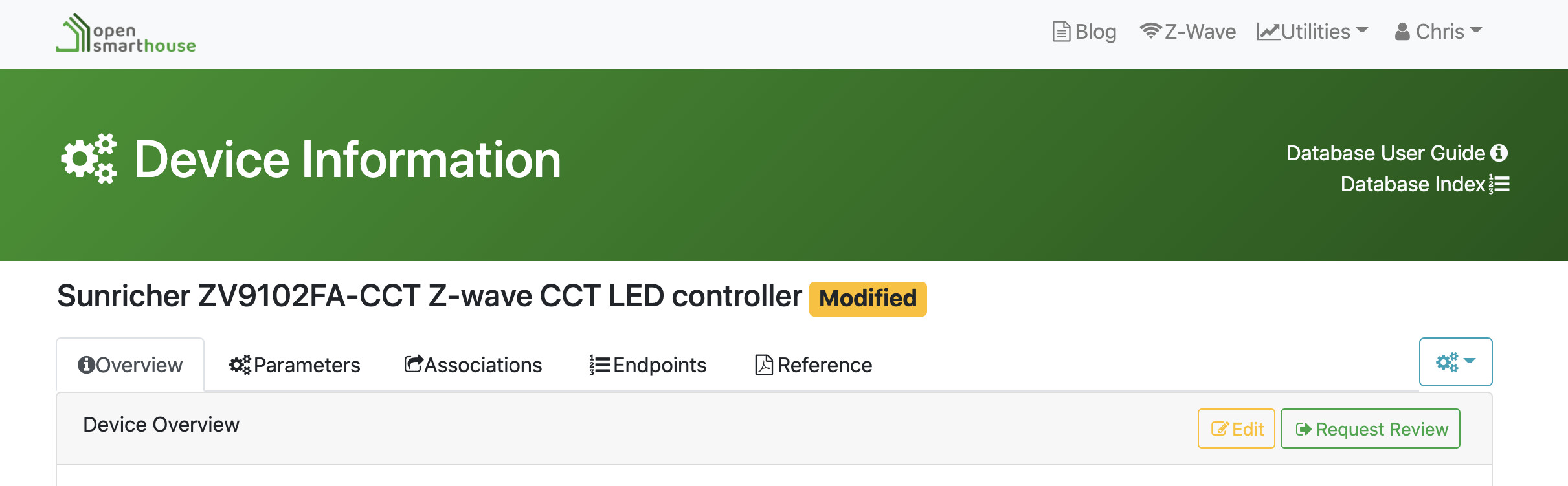

On the overview tab you should have a request review button?
Strange - I’ll take a look at why it’s not appearing :confounded:
Ahhh, I know why now.
I’ve just logged out and back in again and it appeared.
When you gave me access I was already logged in so I just modified it and the box was not available at this stage.
Anyway I’ve posted for review, many thanks for your help
