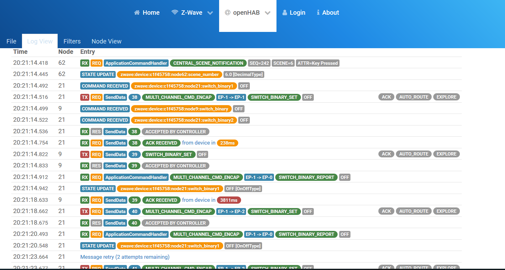

Zwave traffic and rule problem
I’ve a problem with my z-wave network or with a rule (see below).

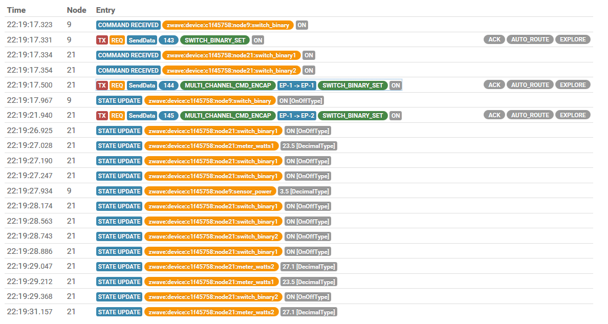

The 2 switches of WS_BM_TERASSE_01 and the switch of WS_BM_TERASSE_01 are changing their states multpile times after the rule is tiggered.
The rule is triggered more than once although a button on the remote is only pressed once.
The attached log (DEBUG enabled for z-wave binding) shows a lot of traffic regarding these things.
The log is truncated.
Does someone have an idea what could cause these traffic and why the rule is triggered more than once?
Norbert
z-wave node id		 	Device type					Thing name
62				DEVOLO MT2653 Keyfob				RC_01_DEVOLO
 9				FGWP102 Metered Wall Plug Switch		WP_BM_CARPORT_01
21				FGS223 Double Switch 2				WS_BM_TERASSE_01
RC_01_DEVOLO Configured to send “central scene to gateway”
The log viewer shows some long runs for some messages and some rejected messages:
2018-08-22 20:21:14.418 [DEBUG] [WaveSerialHandler$ZWaveReceiveThread] - Receive Message = 01 0B 00 04 00 3E 05 5B 03 F2 00 06 67
2018-08-22 20:21:14.421 [DEBUG] [ve.internal.protocol.ZWaveController] - Receive queue TAKE: Length=0
2018-08-22 20:21:14.423 [DEBUG] [wave.internal.protocol.SerialMessage] - Assembled message buffer = 01 0B 00 04 00 3E 05 5B 03 F2 00 06 67
2018-08-22 20:21:14.425 [DEBUG] [ve.internal.protocol.ZWaveController] - Process Message = 01 0B 00 04 00 3E 05 5B 03 F2 00 06 67
2018-08-22 20:21:14.427 [DEBUG] [ve.internal.protocol.ZWaveController] - Message: class=ApplicationCommandHandler[0x04], type=Request[0x00], priority=High, dest=255, callback=0, payload=00 3E 05 5B 03 F2 00 06
2018-08-22 20:21:14.429 [DEBUG] [ssage.ApplicationCommandMessageClass] - NODE 62: Application Command Request (ALIVE:DONE)
2018-08-22 20:21:14.431 [DEBUG] [alization.ZWaveNodeInitStageAdvancer] - NODE 62: Starting initialisation from DONE
2018-08-22 20:21:14.432 [DEBUG] [ve.internal.protocol.ZWaveController] - Event Listener org.openhab.binding.zwave.internal.protocol.initialization.ZWaveNodeInitStageAdvancer@1fc41d9 already registered
2018-08-22 20:21:14.434 [DEBUG] [ssage.ApplicationCommandMessageClass] - NODE 62: Incoming command class CENTRAL_SCENE
2018-08-22 20:21:14.436 [DEBUG] [dclass.ZWaveCentralSceneCommandClass] - NODE 62: Received CENTRAL_SCENE command V1
2018-08-22 20:21:14.437 [DEBUG] [dclass.ZWaveCentralSceneCommandClass] - NODE 62: Received scene 6 at key 0 [Single Press]
2018-08-22 20:21:14.440 [DEBUG] [ve.internal.protocol.ZWaveController] - Notifying event listeners: ZWaveCommandClassValueEvent
2018-08-22 20:21:14.441 [DEBUG] [ding.zwave.handler.ZWaveThingHandler] - NODE 62: Got an event from Z-Wave network: ZWaveCommandClassValueEvent
2018-08-22 20:21:14.443 [DEBUG] [ding.zwave.handler.ZWaveThingHandler] - NODE 62: Got a value event from Z-Wave network, endpoint = 0, command class = CENTRAL_SCENE, value = 6.0
2018-08-22 20:21:14.445 [DEBUG] [ding.zwave.handler.ZWaveThingHandler] - NODE 62: Updating channel state zwave:device:c1f45758:node62:scene_number to 6.0 [DecimalType]
2018-08-22 20:21:14.448 [DEBUG] [ssage.ApplicationCommandMessageClass] - NODE 35: Transaction not completed: node address inconsistent.  lastSent=35, incoming=255
2018-08-22 20:21:14.471 [INFO ] [ipse.smarthome.model.script.r_RC_001] - rule r_RC_DEVOLO_01_Scene_Number_rcv_upd
                                                                         RC_DEVOLO_01_Scene_Number received command = "6.0"
2018-08-22 20:21:14.492 [DEBUG] [ding.zwave.handler.ZWaveThingHandler] - NODE 21: Command received zwave:device:c1f45758:node21:switch_binary1 --> OFF
2018-08-22 20:21:14.495 [DEBUG] [dclass.ZWaveBinarySwitchCommandClass] - NODE 21: Creating new message for application command SWITCH_BINARY_SET
2018-08-22 20:21:14.507 [DEBUG] [ng.zwave.internal.protocol.ZWaveNode] - NODE 21: Encapsulating message, instance / endpoint 1
2018-08-22 20:21:14.509 [DEBUG] [class.ZWaveMultiInstanceCommandClass] - NODE 21: Creating new message for command MULTI_CHANNEL_ENCAP endpoint 1
2018-08-22 20:21:14.511 [DEBUG] [ve.internal.protocol.ZWaveController] - Message queued. Queue length = 1. Queue={}
2018-08-22 20:21:14.511 [DEBUG] [ocol.ZWaveController$ZWaveSendThread] - Took message from queue for sending. Queue length = 0
2018-08-22 20:21:14.513 [DEBUG] [wave.internal.protocol.SerialMessage] - Assembled message buffer = 01 0E 00 13 15 07 60 0D 01 01 25 01 00 25 26 BA
2018-08-22 20:21:14.516 [DEBUG] [ing.zwave.handler.ZWaveSerialHandler] - NODE 21: Sending REQUEST Message = 01 0E 00 13 15 07 60 0D 01 01 25 01 00 25 26 BA
2018-08-22 20:21:14.499 [DEBUG] [ding.zwave.handler.ZWaveThingHandler] - NODE 9: Command received zwave:device:c1f45758:node9:switch_binary --> OFF
2018-08-22 20:21:14.520 [DEBUG] [dclass.ZWaveBinarySwitchCommandClass] - NODE 9: Creating new message for application command SWITCH_BINARY_SET
2018-08-22 20:21:14.522 [DEBUG] [ding.zwave.handler.ZWaveThingHandler] - NODE 21: Command received zwave:device:c1f45758:node21:switch_binary2 --> OFF
2018-08-22 20:21:14.527 [DEBUG] [dclass.ZWaveBinarySwitchCommandClass] - NODE 21: Creating new message for application command SWITCH_BINARY_SET
2018-08-22 20:21:14.527 [DEBUG] [ve.internal.protocol.ZWaveController] - Message queued. Queue length = 1. Queue={}
2018-08-22 20:21:14.529 [DEBUG] [ng.zwave.internal.protocol.ZWaveNode] - NODE 21: Encapsulating message, instance / endpoint 2
2018-08-22 20:21:14.533 [DEBUG] [class.ZWaveMultiInstanceCommandClass] - NODE 21: Creating new message for command MULTI_CHANNEL_ENCAP endpoint 2
2018-08-22 20:21:14.536 [DEBUG] [WaveSerialHandler$ZWaveReceiveThread] - Receive Message = 01 04 01 13 01 E8
2018-08-22 20:21:14.539 [DEBUG] [ve.internal.protocol.ZWaveController] - Receive queue TAKE: Length=0
2018-08-22 20:21:14.541 [DEBUG] [wave.internal.protocol.SerialMessage] - Assembled message buffer = 01 04 01 13 01 E8
2018-08-22 20:21:14.535 [DEBUG] [ve.internal.protocol.ZWaveController] - Message queued. Queue length = 2. Queue={}
2018-08-22 20:21:14.543 [DEBUG] [ve.internal.protocol.ZWaveController] - Process Message = 01 04 01 13 01 E8
2018-08-22 20:21:14.545 [DEBUG] [ve.internal.protocol.ZWaveController] - Message: class=SendData[0x13], type=Response[0x01], priority=High, dest=255, callback=0, payload=01
2018-08-22 20:21:14.547 [DEBUG] [l.serialmessage.SendDataMessageClass] - NODE 21: Sent Data successfully placed on stack.
2018-08-22 20:21:14.754 [DEBUG] [WaveSerialHandler$ZWaveReceiveThread] - Receive Message = 01 07 00 13 26 00 00 17 DA
2018-08-22 20:21:14.758 [DEBUG] [ve.internal.protocol.ZWaveController] - Receive queue TAKE: Length=0
2018-08-22 20:21:14.760 [DEBUG] [wave.internal.protocol.SerialMessage] - Assembled message buffer = 01 09 00 13 26 00 00 17 00 00 D4
2018-08-22 20:21:14.762 [DEBUG] [ve.internal.protocol.ZWaveController] - Process Message = 01 09 00 13 26 00 00 17 00 00 D4
2018-08-22 20:21:14.764 [DEBUG] [ve.internal.protocol.ZWaveController] - Message: class=SendData[0x13], type=Request[0x00], priority=High, dest=255, callback=0, payload=26 00 00 17
2018-08-22 20:21:14.765 [DEBUG] [l.serialmessage.SendDataMessageClass] - NODE 21: SendData Request. CallBack ID = 38, Status = Transmission complete and ACK received(0)
2018-08-22 20:21:14.767 [DEBUG] [alization.ZWaveNodeInitStageAdvancer] - NODE 21: Starting initialisation from DONE
2018-08-22 20:21:14.774 [DEBUG] [ve.internal.protocol.ZWaveController] - Event Listener org.openhab.binding.zwave.internal.protocol.initialization.ZWaveNodeInitStageAdvancer@1b6081d already registered
2018-08-22 20:21:14.776 [DEBUG] [.serialmessage.ZWaveCommandProcessor] - Checking transaction complete: Sent Message: class=SendData[0x13], type=Request[0x00], priority=Set, dest=21, callback=38, payload=15 07 60 0D 01 01 25 01 00
2018-08-22 20:21:14.784 [DEBUG] [.serialmessage.ZWaveCommandProcessor] - Checking transaction complete: Recv Message: class=SendData[0x13], type=Request[0x00], priority=High, dest=255, callback=0, payload=26 00 00 17
2018-08-22 20:21:14.794 [DEBUG] [.serialmessage.ZWaveCommandProcessor] - Checking transaction complete: class=SendData, callback id=38, expected=SendData, cancelled=false        transaction complete!
2018-08-22 20:21:14.795 [DEBUG] [ve.internal.protocol.ZWaveController] - Notifying event listeners: ZWaveTransactionCompletedEvent
2018-08-22 20:21:14.797 [DEBUG] [ding.zwave.handler.ZWaveThingHandler] - NODE 21: Got an event from Z-Wave network: ZWaveTransactionCompletedEvent
2018-08-22 20:21:14.809 [DEBUG] [ocol.ZWaveController$ZWaveSendThread] - NODE 21: Response processed after 291ms/4958ms.
2018-08-22 20:21:14.818 [DEBUG] [ocol.ZWaveController$ZWaveSendThread] - Took message from queue for sending. Queue length = 1
2018-08-22 20:21:14.820 [DEBUG] [wave.internal.protocol.SerialMessage] - Assembled message buffer = 01 0A 00 13 09 03 25 01 00 25 27 CA
2018-08-22 20:21:14.822 [DEBUG] [ing.zwave.handler.ZWaveSerialHandler] - NODE 9: Sending REQUEST Message = 01 0A 00 13 09 03 25 01 00 25 27 CA
2018-08-22 20:21:14.833 [DEBUG] [WaveSerialHandler$ZWaveReceiveThread] - Receive Message = 01 04 01 13 01 E8
2018-08-22 20:21:14.837 [DEBUG] [ve.internal.protocol.ZWaveController] - Receive queue TAKE: Length=0
2018-08-22 20:21:14.840 [DEBUG] [wave.internal.protocol.SerialMessage] - Assembled message buffer = 01 04 01 13 01 E8
2018-08-22 20:21:14.844 [DEBUG] [ve.internal.protocol.ZWaveController] - Process Message = 01 04 01 13 01 E8
2018-08-22 20:21:14.848 [DEBUG] [ve.internal.protocol.ZWaveController] - Message: class=SendData[0x13], type=Response[0x01], priority=High, dest=255, callback=0, payload=01
2018-08-22 20:21:14.851 [DEBUG] [l.serialmessage.SendDataMessageClass] - NODE 9: Sent Data successfully placed on stack.
2018-08-22 20:21:14.912 [DEBUG] [WaveSerialHandler$ZWaveReceiveThread] - Receive Message = 01 0D 00 04 00 15 07 60 0D 01 00 25 03 00 AE
2018-08-22 20:21:14.915 [DEBUG] [ve.internal.protocol.ZWaveController] - Receive queue TAKE: Length=0
2018-08-22 20:21:14.917 [DEBUG] [wave.internal.protocol.SerialMessage] - Assembled message buffer = 01 0D 00 04 00 15 07 60 0D 01 00 25 03 00 AE
2018-08-22 20:21:14.918 [DEBUG] [ve.internal.protocol.ZWaveController] - Process Message = 01 0D 00 04 00 15 07 60 0D 01 00 25 03 00 AE
2018-08-22 20:21:14.920 [DEBUG] [ve.internal.protocol.ZWaveController] - Message: class=ApplicationCommandHandler[0x04], type=Request[0x00], priority=High, dest=255, callback=0, payload=00 15 07 60 0D 01 00 25 03 00
2018-08-22 20:21:14.923 [DEBUG] [ssage.ApplicationCommandMessageClass] - NODE 21: Application Command Request (ALIVE:DONE)
2018-08-22 20:21:14.925 [DEBUG] [alization.ZWaveNodeInitStageAdvancer] - NODE 21: Starting initialisation from DONE
2018-08-22 20:21:14.926 [DEBUG] [ve.internal.protocol.ZWaveController] - Event Listener org.openhab.binding.zwave.internal.protocol.initialization.ZWaveNodeInitStageAdvancer@1b6081d already registered
2018-08-22 20:21:14.928 [DEBUG] [ssage.ApplicationCommandMessageClass] - NODE 21: Incoming command class MULTI_INSTANCE
2018-08-22 20:21:14.929 [DEBUG] [class.ZWaveMultiInstanceCommandClass] - NODE 21: Received MULTI_INSTANCE command V2
2018-08-22 20:21:14.931 [DEBUG] [class.ZWaveMultiInstanceCommandClass] - NODE 21: Requested Command Class = SWITCH_BINARY (0x25)
2018-08-22 20:21:14.932 [DEBUG] [class.ZWaveMultiInstanceCommandClass] - NODE 21: Endpoint = 1, calling handleApplicationCommandRequest.
2018-08-22 20:21:14.934 [DEBUG] [dclass.ZWaveBinarySwitchCommandClass] - Received Switch Binary Request for Node ID = 21
2018-08-22 20:21:14.935 [DEBUG] [dclass.ZWaveBinarySwitchCommandClass] - NODE 21: Switch Binary report, value = 0
2018-08-22 20:21:14.937 [DEBUG] [ve.internal.protocol.ZWaveController] - Notifying event listeners: ZWaveCommandClassValueEvent
2018-08-22 20:21:14.939 [DEBUG] [ding.zwave.handler.ZWaveThingHandler] - NODE 21: Got an event from Z-Wave network: ZWaveCommandClassValueEvent
2018-08-22 20:21:14.940 [DEBUG] [ding.zwave.handler.ZWaveThingHandler] - NODE 21: Got a value event from Z-Wave network, endpoint = 1, command class = SWITCH_BINARY, value = 0
2018-08-22 20:21:14.942 [DEBUG] [ding.zwave.handler.ZWaveThingHandler] - NODE 21: Updating channel state zwave:device:c1f45758:node21:switch_binary1 to OFF [OnOffType]
2018-08-22 20:21:14.950 [DEBUG] [ssage.ApplicationCommandMessageClass] - NODE 9: Transaction not completed: node address inconsistent.  lastSent=9, incoming=255

The log shows only the one entry for the rule, so it is only being triggered once. Commands are sent to the devices, the devices receive the commands and turn off, the devices send a notification that they have turned off, and then the binding updates the item states based on the info received from the devices. In new versions of the binding, you’ll also see a poll of each channel to check the state of a device after a command is sent, since some devices do not send this information automatically. Hopefully this answers your question… everything looks to be working normally.
I have not followed the development version of the binding and had no idea this was implemented. This is exciting. It solves a particularly annoying problem I have with my setup. At this point I’ll wait until Chris finishes merging and upgrade to the snapshot for that feature.
It is also configurable (100-15000ms).
I used snapshot 2.4 08/18/2018 of openhab (openhabian).

Lamps are connected to the switches and the result is that the lamps are turned on and off and on and off for minutes. The lamps become flash lights instead of being switched once.
Today I’ve updated to the actual openhabian snapshot “openHAB 2.4.0~20180823114345-1 (Build #1339)”.
It seems that the rule is now not triggered more than once but sometimes - NOT EACH TIME A BUTTON ON THE REMOTE IS PRESSED - the lights are suddenly flash lights. A lot of log entries regarding the two switch things are displayed. After a few minutes this behaviour stops suddenly like it starts :roll_eyes:

I remember someone reporting something similar. Are you using an in-wall dimmer device? IIRC, the issue was with wiring in the switch paddles. I’ll see if I can find the post… found it…
Thanks for the information.
I’ll try to place the Fibaro Double-Reley-Switch outside the garage for testing.
I’ll come bach after testing.
I’ve placed the Fibaro Double Relay switch as mentioned outside the garage, so that only one wall of the house is between it and the next z-wave node. Unfortunatelly that’s not the solution.
I changed the rule and added also some rules for logging, when then the switch items changed.
A group is now used for switching all items on and off by button 4 of the Devolo remote.

I observed the following:
Sometimes it works well. A few seconds later using the Devolo remote again the system reacts very slow. It took in this case a few seconds between pressing the button and that the z-wave switch changed it status (light on/off).
Using the button 4 (switching all on/off): Switch 2 of node 21 needs a very long time to change it state, if the slow behaviour ocours.
I added also a reentrance lock to the rule, but that seems not to be the problem. The unlock is done in the rule before the zwave channel chaged its state.
I don’t added the log because it’s very long.
What can I try further to get this solved?

I did more testing. I created a simple sitemap to find out if the Devolo remote or my rule is the problem.
Both aren’t the problem, because using the sitemap is also creating problems.
sitemap TERASSE_01 label="Terasse"
	Frame label="" {
		Switch	item=WS_BM_TERASSE_01_Switch1
		Switch	item=WS_BM_TERASSE_01_Switch2
		Switch	item=WP_BM_CARPORT_01_Switch
		Switch	item=G_Terasse_All_PowerOutlets
Using the switches that are link to simple item switches works, but at the end there a some
" Transaction not completed: node address inconsistent" messages (see log below).
The time between changing the state in the UI and the real change of the power outlet is ok.

But using the group that include only the three items cause most of the time a huge delay until all power outlet have changed their state (see log below):
2018-08-29 22:19:17.323 [DEBUG] [ding.zwave.handler.ZWaveThingHandler] - NODE 9: Command received zwave:device:c1f45758:node9:switch_binary --> ON
2018-08-29 22:19:17.325 [DEBUG] [dclass.ZWaveBinarySwitchCommandClass] - NODE 9: Creating new message for application command SWITCH_BINARY_SET
2018-08-29 22:19:17.331 [DEBUG] [ing.zwave.handler.ZWaveSerialHandler] - NODE 9: Sending REQUEST Message = 01 0A 00 13 09 03 25 01 FF 25 8F 9D
2018-08-29 22:19:17.334 [DEBUG] [ding.zwave.handler.ZWaveThingHandler] - NODE 21: Command received zwave:device:c1f45758:node21:switch_binary1 --> ON
2018-08-29 22:19:17.336 [DEBUG] [dclass.ZWaveBinarySwitchCommandClass] - NODE 21: Creating new message for application command SWITCH_BINARY_SET
2018-08-29 22:19:17.347 [DEBUG] [ng.zwave.internal.protocol.ZWaveNode] - NODE 21: Encapsulating message, instance / endpoint 1
2018-08-29 22:19:17.349 [DEBUG] [class.ZWaveMultiInstanceCommandClass] - NODE 21: Creating new message for command MULTI_CHANNEL_ENCAP endpoint 1
2018-08-29 22:19:17.364 [DEBUG] [l.serialmessage.SendDataMessageClass] - NODE 9: Sent Data successfully placed on stack.
2018-08-29 22:19:17.354 [DEBUG] [ding.zwave.handler.ZWaveThingHandler] - NODE 21: Command received zwave:device:c1f45758:node21:switch_binary2 --> ON
2018-08-29 22:19:17.381 [DEBUG] [dclass.ZWaveBinarySwitchCommandClass] - NODE 21: Creating new message for application command SWITCH_BINARY_SET
2018-08-29 22:19:17.392 [DEBUG] [ng.zwave.internal.protocol.ZWaveNode] - NODE 21: Encapsulating message, instance / endpoint 2
2018-08-29 22:19:17.397 [DEBUG] [class.ZWaveMultiInstanceCommandClass] - NODE 21: Creating new message for command MULTI_CHANNEL_ENCAP endpoint 2
2018-08-29 22:19:17.480 [DEBUG] [l.serialmessage.SendDataMessageClass] - NODE 9: SendData Request. CallBack ID = 143, Status = Transmission complete and ACK received(0)
2018-08-29 22:19:17.482 [DEBUG] [alization.ZWaveNodeInitStageAdvancer] - NODE 9: Starting initialisation from DONE
2018-08-29 22:19:17.492 [DEBUG] [ding.zwave.handler.ZWaveThingHandler] - NODE 9: Got an event from Z-Wave network: ZWaveTransactionCompletedEvent
2018-08-29 22:19:17.493 [DEBUG] [curityCommandClassWithInitialization] - NODE 9: updating lastSentMessageTimestamp
2018-08-29 22:19:17.495 [DEBUG] [ocol.ZWaveController$ZWaveSendThread] - NODE 9: Response processed after 158ms/4963ms.
2018-08-29 22:19:17.500 [DEBUG] [ing.zwave.handler.ZWaveSerialHandler] - NODE 21: Sending REQUEST Message = 01 0E 00 13 15 07 60 0D 01 01 25 01 FF 25 90 F3
2018-08-29 22:19:17.520 [DEBUG] [l.serialmessage.SendDataMessageClass] - NODE 21: Sent Data successfully placed on stack.
2018-08-29 22:19:17.953 [DEBUG] [ssage.ApplicationCommandMessageClass] - NODE 9: Application Command Request (ALIVE:DONE)
2018-08-29 22:19:17.954 [DEBUG] [alization.ZWaveNodeInitStageAdvancer] - NODE 9: Starting initialisation from DONE
2018-08-29 22:19:17.957 [DEBUG] [ssage.ApplicationCommandMessageClass] - NODE 9: Incoming command class SWITCH_BINARY
2018-08-29 22:19:17.961 [DEBUG] [dclass.ZWaveBinarySwitchCommandClass] - NODE 9: Switch Binary report, value = 255
2018-08-29 22:19:17.964 [DEBUG] [ding.zwave.handler.ZWaveThingHandler] - NODE 9: Got an event from Z-Wave network: ZWaveCommandClassValueEvent
2018-08-29 22:19:17.965 [DEBUG] [ding.zwave.handler.ZWaveThingHandler] - NODE 9: Got a value event from Z-Wave network, endpoint = 0, command class = SWITCH_BINARY, value = 255
2018-08-29 22:19:17.967 [DEBUG] [ding.zwave.handler.ZWaveThingHandler] - NODE 9: Updating channel state zwave:device:c1f45758:node9:switch_binary to ON [OnOffType]
2018-08-29 22:19:17.970 [DEBUG] [ssage.ApplicationCommandMessageClass] - NODE 21: Transaction not completed: node address inconsistent.  lastSent=21, incoming=255
2018-08-29 22:19:21.912 [DEBUG] [l.serialmessage.SendDataMessageClass] - NODE 21: SendData Request. CallBack ID = 144, Status = Transmission complete and ACK received(0)
2018-08-29 22:19:21.915 [DEBUG] [alization.ZWaveNodeInitStageAdvancer] - NODE 21: Starting initialisation from DONE
2018-08-29 22:19:21.929 [DEBUG] [ding.zwave.handler.ZWaveThingHandler] - NODE 21: Got an event from Z-Wave network: ZWaveTransactionCompletedEvent
2018-08-29 22:19:21.931 [DEBUG] [curityCommandClassWithInitialization] - NODE 21: updating lastSentMessageTimestamp
2018-08-29 22:19:21.933 [DEBUG] [ocol.ZWaveController$ZWaveSendThread] - NODE 21: Response processed after 4432ms/4963ms.
2018-08-29 22:19:21.940 [DEBUG] [ing.zwave.handler.ZWaveSerialHandler] - NODE 21: Sending REQUEST Message = 01 0E 00 13 15 07 60 0D 01 02 25 01 FF 25 91 F1
2018-08-29 22:19:21.969 [DEBUG] [l.serialmessage.SendDataMessageClass] - NODE 21: Sent Data successfully placed on stack.
2018-08-29 22:19:26.801 [DEBUG] [l.serialmessage.SendDataMessageClass] - NODE 21: SendData Request. CallBack ID = 145, Status = Transmission complete and ACK received(0)
2018-08-29 22:19:26.803 [DEBUG] [alization.ZWaveNodeInitStageAdvancer] - NODE 21: Starting initialisation from DONE
2018-08-29 22:19:26.820 [DEBUG] [ding.zwave.handler.ZWaveThingHandler] - NODE 21: Got an event from Z-Wave network: ZWaveTransactionCompletedEvent
2018-08-29 22:19:26.822 [DEBUG] [curityCommandClassWithInitialization] - NODE 21: updating lastSentMessageTimestamp
2018-08-29 22:19:26.825 [DEBUG] [ocol.ZWaveController$ZWaveSendThread] - NODE 21: Response processed after 4882ms/4963ms.
2018-08-29 22:19:26.897 [DEBUG] [ssage.ApplicationCommandMessageClass] - NODE 21: Application Command Request (ALIVE:DONE)
2018-08-29 22:19:26.899 [DEBUG] [alization.ZWaveNodeInitStageAdvancer] - NODE 21: Starting initialisation from DONE
2018-08-29 22:19:26.904 [DEBUG] [ssage.ApplicationCommandMessageClass] - NODE 21: Incoming command class MULTI_INSTANCE
2018-08-29 22:19:26.906 [DEBUG] [class.ZWaveMultiInstanceCommandClass] - NODE 21: Received MULTI_INSTANCE command V2
2018-08-29 22:19:26.909 [DEBUG] [class.ZWaveMultiInstanceCommandClass] - NODE 21: Requested Command Class = SWITCH_BINARY (0x25)
2018-08-29 22:19:26.911 [DEBUG] [class.ZWaveMultiInstanceCommandClass] - NODE 21: Endpoint = 1, calling handleApplicationCommandRequest.
2018-08-29 22:19:26.915 [DEBUG] [dclass.ZWaveBinarySwitchCommandClass] - NODE 21: Switch Binary report, value = 255
2018-08-29 22:19:26.920 [DEBUG] [ding.zwave.handler.ZWaveThingHandler] - NODE 21: Got an event from Z-Wave network: ZWaveCommandClassValueEvent
2018-08-29 22:19:26.922 [DEBUG] [ding.zwave.handler.ZWaveThingHandler] - NODE 21: Got a value event from Z-Wave network, endpoint = 1, command class = SWITCH_BINARY, value = 255
2018-08-29 22:19:26.925 [DEBUG] [ding.zwave.handler.ZWaveThingHandler] - NODE 21: Updating channel state zwave:device:c1f45758:node21:switch_binary1 to ON [OnOffType]
2018-08-29 22:19:26.994 [DEBUG] [ssage.ApplicationCommandMessageClass] - NODE 21: Application Command Request (ALIVE:DONE)
2018-08-29 22:19:26.996 [DEBUG] [alization.ZWaveNodeInitStageAdvancer] - NODE 21: Starting initialisation from DONE
2018-08-29 22:19:27.002 [DEBUG] [ssage.ApplicationCommandMessageClass] - NODE 21: Incoming command class MULTI_INSTANCE
2018-08-29 22:19:27.005 [DEBUG] [class.ZWaveMultiInstanceCommandClass] - NODE 21: Received MULTI_INSTANCE command V2
2018-08-29 22:19:27.007 [DEBUG] [class.ZWaveMultiInstanceCommandClass] - NODE 21: Requested Command Class = METER (0x32)
2018-08-29 22:19:27.010 [DEBUG] [class.ZWaveMultiInstanceCommandClass] - NODE 21: Endpoint = 1, calling handleApplicationCommandRequest.
2018-08-29 22:19:27.013 [DEBUG] [.commandclass.ZWaveMeterCommandClass] - NODE 21: Received METER command V3
2018-08-29 22:19:27.015 [DEBUG] [.commandclass.ZWaveMeterCommandClass] - NODE 21: Meter: Type=Electric(1), Scale=W(2), Value=23.5
2018-08-29 22:19:27.020 [DEBUG] [ding.zwave.handler.ZWaveThingHandler] - NODE 21: Got an event from Z-Wave network: ZWaveMeterValueEvent
2018-08-29 22:19:27.023 [DEBUG] [ding.zwave.handler.ZWaveThingHandler] - NODE 21: Got a value event from Z-Wave network, endpoint = 1, command class = METER, value = 23.5
2018-08-29 22:19:27.028 [DEBUG] [ding.zwave.handler.ZWaveThingHandler] - NODE 21: Updating channel state zwave:device:c1f45758:node21:meter_watts1 to 23.5 [DecimalType]
2018-08-29 22:19:27.159 [DEBUG] [ssage.ApplicationCommandMessageClass] - NODE 21: Application Command Request (ALIVE:DONE)
2018-08-29 22:19:27.161 [DEBUG] [alization.ZWaveNodeInitStageAdvancer] - NODE 21: Starting initialisation from DONE
2018-08-29 22:19:27.167 [DEBUG] [ssage.ApplicationCommandMessageClass] - NODE 21: Incoming command class MULTI_INSTANCE
2018-08-29 22:19:27.169 [DEBUG] [class.ZWaveMultiInstanceCommandClass] - NODE 21: Received MULTI_INSTANCE command V2
2018-08-29 22:19:27.172 [DEBUG] [class.ZWaveMultiInstanceCommandClass] - NODE 21: Requested Command Class = SWITCH_BINARY (0x25)
2018-08-29 22:19:27.174 [DEBUG] [class.ZWaveMultiInstanceCommandClass] - NODE 21: Endpoint = 1, calling handleApplicationCommandRequest.
2018-08-29 22:19:27.179 [DEBUG] [dclass.ZWaveBinarySwitchCommandClass] - NODE 21: Switch Binary report, value = 255
2018-08-29 22:19:27.184 [DEBUG] [ding.zwave.handler.ZWaveThingHandler] - NODE 21: Got an event from Z-Wave network: ZWaveCommandClassValueEvent
2018-08-29 22:19:27.187 [DEBUG] [ding.zwave.handler.ZWaveThingHandler] - NODE 21: Got a value event from Z-Wave network, endpoint = 1, command class = SWITCH_BINARY, value = 255
2018-08-29 22:19:27.190 [DEBUG] [ding.zwave.handler.ZWaveThingHandler] - NODE 21: Updating channel state zwave:device:c1f45758:node21:switch_binary1 to ON [OnOffType]
2018-08-29 22:19:27.226 [DEBUG] [ssage.ApplicationCommandMessageClass] - NODE 21: Application Command Request (ALIVE:DONE)
2018-08-29 22:19:27.228 [DEBUG] [alization.ZWaveNodeInitStageAdvancer] - NODE 21: Starting initialisation from DONE
2018-08-29 22:19:27.232 [DEBUG] [ssage.ApplicationCommandMessageClass] - NODE 21: Incoming command class MULTI_INSTANCE
2018-08-29 22:19:27.233 [DEBUG] [class.ZWaveMultiInstanceCommandClass] - NODE 21: Received MULTI_INSTANCE command V2
2018-08-29 22:19:27.235 [DEBUG] [class.ZWaveMultiInstanceCommandClass] - NODE 21: Requested Command Class = SWITCH_BINARY (0x25)
2018-08-29 22:19:27.237 [DEBUG] [class.ZWaveMultiInstanceCommandClass] - NODE 21: Endpoint = 1, calling handleApplicationCommandRequest.
2018-08-29 22:19:27.240 [DEBUG] [dclass.ZWaveBinarySwitchCommandClass] - NODE 21: Switch Binary report, value = 255
2018-08-29 22:19:27.244 [DEBUG] [ding.zwave.handler.ZWaveThingHandler] - NODE 21: Got an event from Z-Wave network: ZWaveCommandClassValueEvent
2018-08-29 22:19:27.245 [DEBUG] [ding.zwave.handler.ZWaveThingHandler] - NODE 21: Got a value event from Z-Wave network, endpoint = 1, command class = SWITCH_BINARY, value = 255
2018-08-29 22:19:27.247 [DEBUG] [ding.zwave.handler.ZWaveThingHandler] - NODE 21: Updating channel state zwave:device:c1f45758:node21:switch_binary1 to ON [OnOffType]
2018-08-29 22:19:27.901 [DEBUG] [ssage.ApplicationCommandMessageClass] - NODE 9: Application Command Request (ALIVE:DONE)
2018-08-29 22:19:27.903 [DEBUG] [alization.ZWaveNodeInitStageAdvancer] - NODE 9: Starting initialisation from DONE
2018-08-29 22:19:27.909 [DEBUG] [ssage.ApplicationCommandMessageClass] - NODE 9: Incoming command class SENSOR_MULTILEVEL
2018-08-29 22:19:27.912 [DEBUG] [ss.ZWaveMultiLevelSensorCommandClass] - NODE 9: Received COMMAND_CLASS_SENSOR_MULTILEVEL command V5
2018-08-29 22:19:27.915 [DEBUG] [ss.ZWaveMultiLevelSensorCommandClass] - NODE 9: Sensor Multi Level REPORT received
2018-08-29 22:19:27.918 [DEBUG] [ss.ZWaveMultiLevelSensorCommandClass] - NODE 9: Sensor Type = Power(4), Scale = 0
2018-08-29 22:19:27.921 [DEBUG] [ss.ZWaveMultiLevelSensorCommandClass] - NODE 9: Sensor Value = 3.5
2018-08-29 22:19:27.927 [DEBUG] [ding.zwave.handler.ZWaveThingHandler] - NODE 9: Got an event from Z-Wave network: ZWaveMultiLevelSensorValueEvent
2018-08-29 22:19:27.930 [DEBUG] [ding.zwave.handler.ZWaveThingHandler] - NODE 9: Got a value event from Z-Wave network, endpoint = 0, command class = SENSOR_MULTILEVEL, value = 3.5
2018-08-29 22:19:27.934 [DEBUG] [ding.zwave.handler.ZWaveThingHandler] - NODE 9: Updating channel state zwave:device:c1f45758:node9:sensor_power to 3.5 [DecimalType]
2018-08-29 22:19:27.943 [DEBUG] [ssage.ApplicationCommandMessageClass] - NODE 21: Transaction not completed: node address inconsistent.  lastSent=21, incoming=255
2018-08-29 22:19:28.152 [DEBUG] [ssage.ApplicationCommandMessageClass] - NODE 21: Application Command Request (ALIVE:DONE)
2018-08-29 22:19:28.154 [DEBUG] [alization.ZWaveNodeInitStageAdvancer] - NODE 21: Starting initialisation from DONE
2018-08-29 22:19:28.158 [DEBUG] [ssage.ApplicationCommandMessageClass] - NODE 21: Incoming command class MULTI_INSTANCE
2018-08-29 22:19:28.159 [DEBUG] [class.ZWaveMultiInstanceCommandClass] - NODE 21: Received MULTI_INSTANCE command V2
2018-08-29 22:19:28.161 [DEBUG] [class.ZWaveMultiInstanceCommandClass] - NODE 21: Requested Command Class = SWITCH_BINARY (0x25)
2018-08-29 22:19:28.163 [DEBUG] [class.ZWaveMultiInstanceCommandClass] - NODE 21: Endpoint = 1, calling handleApplicationCommandRequest.
2018-08-29 22:19:28.166 [DEBUG] [dclass.ZWaveBinarySwitchCommandClass] - NODE 21: Switch Binary report, value = 255
2018-08-29 22:19:28.170 [DEBUG] [ding.zwave.handler.ZWaveThingHandler] - NODE 21: Got an event from Z-Wave network: ZWaveCommandClassValueEvent
2018-08-29 22:19:28.172 [DEBUG] [ding.zwave.handler.ZWaveThingHandler] - NODE 21: Got a value event from Z-Wave network, endpoint = 1, command class = SWITCH_BINARY, value = 255
2018-08-29 22:19:28.174 [DEBUG] [ding.zwave.handler.ZWaveThingHandler] - NODE 21: Updating channel state zwave:device:c1f45758:node21:switch_binary1 to ON [OnOffType]
2018-08-29 22:19:28.538 [DEBUG] [ssage.ApplicationCommandMessageClass] - NODE 21: Application Command Request (ALIVE:DONE)
2018-08-29 22:19:28.540 [DEBUG] [alization.ZWaveNodeInitStageAdvancer] - NODE 21: Starting initialisation from DONE
2018-08-29 22:19:28.545 [DEBUG] [ssage.ApplicationCommandMessageClass] - NODE 21: Incoming command class MULTI_INSTANCE
2018-08-29 22:19:28.549 [DEBUG] [class.ZWaveMultiInstanceCommandClass] - NODE 21: Received MULTI_INSTANCE command V2
2018-08-29 22:19:28.551 [DEBUG] [class.ZWaveMultiInstanceCommandClass] - NODE 21: Requested Command Class = SWITCH_BINARY (0x25)
2018-08-29 22:19:28.553 [DEBUG] [class.ZWaveMultiInstanceCommandClass] - NODE 21: Endpoint = 1, calling handleApplicationCommandRequest.
2018-08-29 22:19:28.556 [DEBUG] [dclass.ZWaveBinarySwitchCommandClass] - NODE 21: Switch Binary report, value = 255
2018-08-29 22:19:28.560 [DEBUG] [ding.zwave.handler.ZWaveThingHandler] - NODE 21: Got an event from Z-Wave network: ZWaveCommandClassValueEvent
2018-08-29 22:19:28.561 [DEBUG] [ding.zwave.handler.ZWaveThingHandler] - NODE 21: Got a value event from Z-Wave network, endpoint = 1, command class = SWITCH_BINARY, value = 255
2018-08-29 22:19:28.563 [DEBUG] [ding.zwave.handler.ZWaveThingHandler] - NODE 21: Updating channel state zwave:device:c1f45758:node21:switch_binary1 to ON [OnOffType]
2018-08-29 22:19:28.698 [DEBUG] [ssage.ApplicationCommandMessageClass] - NODE 21: Application Command Request (ALIVE:DONE)
2018-08-29 22:19:28.701 [DEBUG] [alization.ZWaveNodeInitStageAdvancer] - NODE 21: Starting initialisation from DONE
2018-08-29 22:19:28.706 [DEBUG] [ssage.ApplicationCommandMessageClass] - NODE 21: Incoming command class MULTI_INSTANCE
2018-08-29 22:19:28.710 [DEBUG] [class.ZWaveMultiInstanceCommandClass] - NODE 21: Received MULTI_INSTANCE command V2
2018-08-29 22:19:28.714 [DEBUG] [class.ZWaveMultiInstanceCommandClass] - NODE 21: Requested Command Class = SWITCH_BINARY (0x25)
2018-08-29 22:19:28.718 [DEBUG] [class.ZWaveMultiInstanceCommandClass] - NODE 21: Endpoint = 2, calling handleApplicationCommandRequest.
2018-08-29 22:19:28.726 [DEBUG] [dclass.ZWaveBinarySwitchCommandClass] - NODE 21: Switch Binary report, value = 255
2018-08-29 22:19:28.734 [DEBUG] [ding.zwave.handler.ZWaveThingHandler] - NODE 21: Got an event from Z-Wave network: ZWaveCommandClassValueEvent
2018-08-29 22:19:28.739 [DEBUG] [ding.zwave.handler.ZWaveThingHandler] - NODE 21: Got a value event from Z-Wave network, endpoint = 2, command class = SWITCH_BINARY, value = 255
2018-08-29 22:19:28.743 [DEBUG] [ding.zwave.handler.ZWaveThingHandler] - NODE 21: Updating channel state zwave:device:c1f45758:node21:switch_binary2 to ON [OnOffType]
2018-08-29 22:19:28.854 [DEBUG] [ssage.ApplicationCommandMessageClass] - NODE 21: Application Command Request (ALIVE:DONE)
2018-08-29 22:19:28.855 [DEBUG] [alization.ZWaveNodeInitStageAdvancer] - NODE 21: Starting initialisation from DONE
2018-08-29 22:19:28.875 [DEBUG] [ssage.ApplicationCommandMessageClass] - NODE 21: Incoming command class MULTI_INSTANCE
2018-08-29 22:19:28.876 [DEBUG] [class.ZWaveMultiInstanceCommandClass] - NODE 21: Received MULTI_INSTANCE command V2
2018-08-29 22:19:28.877 [DEBUG] [class.ZWaveMultiInstanceCommandClass] - NODE 21: Requested Command Class = SWITCH_BINARY (0x25)
2018-08-29 22:19:28.878 [DEBUG] [class.ZWaveMultiInstanceCommandClass] - NODE 21: Endpoint = 1, calling handleApplicationCommandRequest.
2018-08-29 22:19:28.881 [DEBUG] [dclass.ZWaveBinarySwitchCommandClass] - NODE 21: Switch Binary report, value = 255
2018-08-29 22:19:28.883 [DEBUG] [ding.zwave.handler.ZWaveThingHandler] - NODE 21: Got an event from Z-Wave network: ZWaveCommandClassValueEvent
2018-08-29 22:19:28.885 [DEBUG] [ding.zwave.handler.ZWaveThingHandler] - NODE 21: Got a value event from Z-Wave network, endpoint = 1, command class = SWITCH_BINARY, value = 255
2018-08-29 22:19:28.886 [DEBUG] [ding.zwave.handler.ZWaveThingHandler] - NODE 21: Updating channel state zwave:device:c1f45758:node21:switch_binary1 to ON [OnOffType]
2018-08-29 22:19:29.027 [DEBUG] [ssage.ApplicationCommandMessageClass] - NODE 21: Application Command Request (ALIVE:DONE)
2018-08-29 22:19:29.029 [DEBUG] [alization.ZWaveNodeInitStageAdvancer] - NODE 21: Starting initialisation from DONE
2018-08-29 22:19:29.031 [DEBUG] [ssage.ApplicationCommandMessageClass] - NODE 21: Incoming command class MULTI_INSTANCE
2018-08-29 22:19:29.033 [DEBUG] [class.ZWaveMultiInstanceCommandClass] - NODE 21: Received MULTI_INSTANCE command V2
2018-08-29 22:19:29.034 [DEBUG] [class.ZWaveMultiInstanceCommandClass] - NODE 21: Requested Command Class = METER (0x32)
2018-08-29 22:19:29.036 [DEBUG] [class.ZWaveMultiInstanceCommandClass] - NODE 21: Endpoint = 2, calling handleApplicationCommandRequest.
2018-08-29 22:19:29.037 [DEBUG] [.commandclass.ZWaveMeterCommandClass] - NODE 21: Received METER command V3
2018-08-29 22:19:29.039 [DEBUG] [.commandclass.ZWaveMeterCommandClass] - NODE 21: Meter: Type=Electric(1), Scale=W(2), Value=27.1
2018-08-29 22:19:29.042 [DEBUG] [ding.zwave.handler.ZWaveThingHandler] - NODE 21: Got an event from Z-Wave network: ZWaveMeterValueEvent
2018-08-29 22:19:29.044 [DEBUG] [ding.zwave.handler.ZWaveThingHandler] - NODE 21: Got a value event from Z-Wave network, endpoint = 2, command class = METER, value = 27.1
2018-08-29 22:19:29.047 [DEBUG] [ding.zwave.handler.ZWaveThingHandler] - NODE 21: Updating channel state zwave:device:c1f45758:node21:meter_watts2 to 27.1 [DecimalType]
2018-08-29 22:19:29.195 [DEBUG] [ssage.ApplicationCommandMessageClass] - NODE 21: Application Command Request (ALIVE:DONE)
2018-08-29 22:19:29.196 [DEBUG] [alization.ZWaveNodeInitStageAdvancer] - NODE 21: Starting initialisation from DONE
2018-08-29 22:19:29.199 [DEBUG] [ssage.ApplicationCommandMessageClass] - NODE 21: Incoming command class MULTI_INSTANCE
2018-08-29 22:19:29.201 [DEBUG] [class.ZWaveMultiInstanceCommandClass] - NODE 21: Received MULTI_INSTANCE command V2
2018-08-29 22:19:29.202 [DEBUG] [class.ZWaveMultiInstanceCommandClass] - NODE 21: Requested Command Class = METER (0x32)
2018-08-29 22:19:29.203 [DEBUG] [class.ZWaveMultiInstanceCommandClass] - NODE 21: Endpoint = 1, calling handleApplicationCommandRequest.
2018-08-29 22:19:29.204 [DEBUG] [.commandclass.ZWaveMeterCommandClass] - NODE 21: Received METER command V3
2018-08-29 22:19:29.206 [DEBUG] [.commandclass.ZWaveMeterCommandClass] - NODE 21: Meter: Type=Electric(1), Scale=W(2), Value=23.5
2018-08-29 22:19:29.208 [DEBUG] [ding.zwave.handler.ZWaveThingHandler] - NODE 21: Got an event from Z-Wave network: ZWaveMeterValueEvent
2018-08-29 22:19:29.210 [DEBUG] [ding.zwave.handler.ZWaveThingHandler] - NODE 21: Got a value event from Z-Wave network, endpoint = 1, command class = METER, value = 23.5
2018-08-29 22:19:29.212 [DEBUG] [ding.zwave.handler.ZWaveThingHandler] - NODE 21: Updating channel state zwave:device:c1f45758:node21:meter_watts1 to 23.5 [DecimalType]
2018-08-29 22:19:29.353 [DEBUG] [ssage.ApplicationCommandMessageClass] - NODE 21: Application Command Request (ALIVE:DONE)
2018-08-29 22:19:29.354 [DEBUG] [alization.ZWaveNodeInitStageAdvancer] - NODE 21: Starting initialisation from DONE
2018-08-29 22:19:29.357 [DEBUG] [ssage.ApplicationCommandMessageClass] - NODE 21: Incoming command class MULTI_INSTANCE
2018-08-29 22:19:29.358 [DEBUG] [class.ZWaveMultiInstanceCommandClass] - NODE 21: Received MULTI_INSTANCE command V2
2018-08-29 22:19:29.359 [DEBUG] [class.ZWaveMultiInstanceCommandClass] - NODE 21: Requested Command Class = SWITCH_BINARY (0x25)
2018-08-29 22:19:29.361 [DEBUG] [class.ZWaveMultiInstanceCommandClass] - NODE 21: Endpoint = 2, calling handleApplicationCommandRequest.
2018-08-29 22:19:29.363 [DEBUG] [dclass.ZWaveBinarySwitchCommandClass] - NODE 21: Switch Binary report, value = 255
2018-08-29 22:19:29.365 [DEBUG] [ding.zwave.handler.ZWaveThingHandler] - NODE 21: Got an event from Z-Wave network: ZWaveCommandClassValueEvent
2018-08-29 22:19:29.367 [DEBUG] [ding.zwave.handler.ZWaveThingHandler] - NODE 21: Got a value event from Z-Wave network, endpoint = 2, command class = SWITCH_BINARY, value = 255
2018-08-29 22:19:29.368 [DEBUG] [ding.zwave.handler.ZWaveThingHandler] - NODE 21: Updating channel state zwave:device:c1f45758:node21:switch_binary2 to ON [OnOffType]
2018-08-29 22:19:30.098 [DEBUG] [ssage.ApplicationCommandMessageClass] - NODE 21: Transaction not completed: node address inconsistent.  lastSent=21, incoming=255
2018-08-29 22:19:31.140 [DEBUG] [ssage.ApplicationCommandMessageClass] - NODE 21: Application Command Request (ALIVE:DONE)
2018-08-29 22:19:31.141 [DEBUG] [alization.ZWaveNodeInitStageAdvancer] - NODE 21: Starting initialisation from DONE
2018-08-29 22:19:31.144 [DEBUG] [ssage.ApplicationCommandMessageClass] - NODE 21: Incoming command class MULTI_INSTANCE
2018-08-29 22:19:31.145 [DEBUG] [class.ZWaveMultiInstanceCommandClass] - NODE 21: Received MULTI_INSTANCE command V2
2018-08-29 22:19:31.146 [DEBUG] [class.ZWaveMultiInstanceCommandClass] - NODE 21: Requested Command Class = METER (0x32)
2018-08-29 22:19:31.147 [DEBUG] [class.ZWaveMultiInstanceCommandClass] - NODE 21: Endpoint = 2, calling handleApplicationCommandRequest.
2018-08-29 22:19:31.149 [DEBUG] [.commandclass.ZWaveMeterCommandClass] - NODE 21: Received METER command V3
2018-08-29 22:19:31.150 [DEBUG] [.commandclass.ZWaveMeterCommandClass] - NODE 21: Meter: Type=Electric(1), Scale=W(2), Value=27.1
2018-08-29 22:19:31.153 [DEBUG] [ding.zwave.handler.ZWaveThingHandler] - NODE 21: Got an event from Z-Wave network: ZWaveMeterValueEvent
2018-08-29 22:19:31.154 [DEBUG] [ding.zwave.handler.ZWaveThingHandler] - NODE 21: Got a value event from Z-Wave network, endpoint = 2, command class = METER, value = 27.1
2018-08-29 22:19:31.157 [DEBUG] [ding.zwave.handler.ZWaveThingHandler] - NODE 21: Updating channel state zwave:device:c1f45758:node21:meter_watts2 to 27.1 [DecimalType]
2018-08-29 22:19:44.344 [DEBUG] [ssage.ApplicationCommandMessageClass] - NODE 21: Transaction not completed: node address inconsistent.  lastSent=21, incoming=255
2018-08-29 22:19:44.421 [DEBUG] [ssage.ApplicationCommandMessageClass] - NODE 21: Transaction not completed: node address inconsistent.  lastSent=21, incoming=255
2018-08-29 22:19:44.485 [DEBUG] [ssage.ApplicationCommandMessageClass] - NODE 21: Transaction not completed: node address inconsistent.  lastSent=21, incoming=255
The “Transaction not completed node address inconsistent” is here also logged
I tried to heal and reinitialize the two nodes 9 & 21 more than once, but it doesn’t help.
What could be the problem and how can I solve it?
Is is possible to configure a default value for this? So far I only can find it for each single device and need to tweak it several times.

Using the sitemap is causing issues, if I press the same button several times.
The problem is than the same as pressing the button for the group.
Log messages for the thing (node 9 or node 21) are recognized over 10 to 20 seconds.
I’ll try to create a log showing that. I’ll upload that to a Google or one drive due to its size.
I don’t understand what is causing these behaviour. Is there a problem with my radio layer in that area that is causing these kind of problems?
I found your nice thread regarding updating zwave things
and the following two:
I’ll update to the zwave binding to the deveolpment branch and report afterwards.
I checked the actual log that was just created and I found some strange entries.
That’s the behaviour that I tried to discribe. Sometimes the time between changing the switch on the sitemap and the real change of the zwave switch power outlet is longer than a second.
