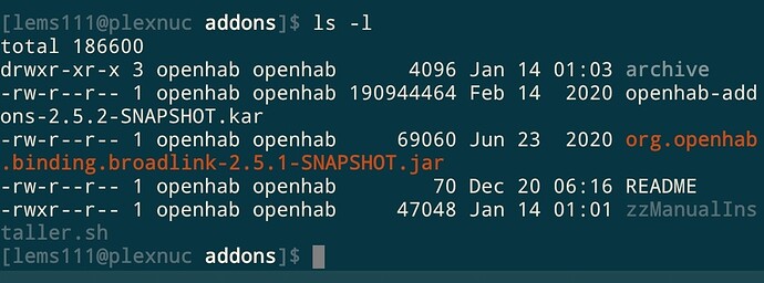

I downloaded the script in the addons folder and changed the owner and group to openhab:

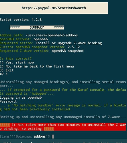

I get following error when running the script. I ran it with openhab stopped and with it running, same error:
For reference, I am running openhab 2.5.11 release build
I do not know. I did not write the script. Perhaps try asking in the script thread.
