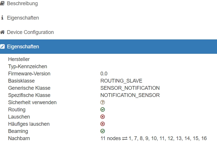

I found this one. TP-807ZG from Topvico
37$ on Aliexpress → https://www.aliexpress.com/item/Topvico-Zwave-Carbon-Monoxide-Natural-Liquefied-Gas-Leak-Detector-Sensor-Alarm-Z-wave-Z-wave-Smart/32817143922.html?spm=a2g0s.9042311.0.0.rvzJTO
, but unfortunately it shows up without any information.
Is there any way to integrate such an unknown device into the database?
The documentation is just one page, telling me to press the button 3 times for inclusion, but thats all…
Yes, see here. As you should have a .XML already, please upload it to the database. It’ll then become available in the next OH snapshot.

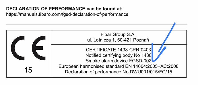

After finding that using the Fibaro FGSD-002 would effectively invalidate my home insurance (not EN14604 certified) and fail in some scenarios, I rather gave up with the idea of using Z-Wave for life-critical systems.
Vesternet do show some certified Popp sensors, but paying £65 for a single mode sensor seems poor value compared with a Next Protect device which for £99 detects optical smoke, ionisation smoke, CO, and is both mains powered and interlinked.

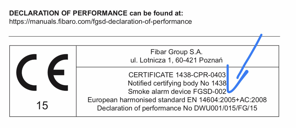

I believe that this was on FGSD-001 and the reason to create FGSD-002 to now be compliant at least with EU requirements, but I didn’t follow up on the details.
And not sure what that means to brexiteers now :wink:
