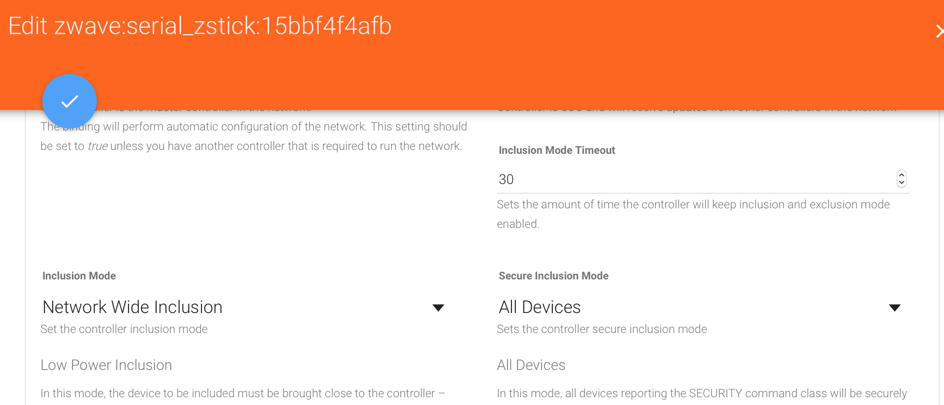

The 17 channels were added only a couple of weeks back. Ignore all of the alarm channels. You need to get only the BARRIER_STATE channel working.
Exclude the device from the network. In PaperUI change config to include ALL Devices securely. Include the GDC securely. Verify that it is securely included in HABMIN. Then everything will work.
I excluded the GDC and then using PaperUI set the Z-wave controller config to include All Devices securely.
I then included GDC through HABmin (click on discovery + z-wave binding → unplug z-wave stick → include GDC by pressing button on stick and GDC → plug z-stick back in Pi → reboot pi → Add GDC to Things). After rebooting Pi, my z-wave controller binding stopped showing any properties and displayed a Delete icon. Even the added GDC displayed the same behavior.
Now if click on discovery, I don’t see Z-wave binding in the drop down. The logs still show that security failed:
