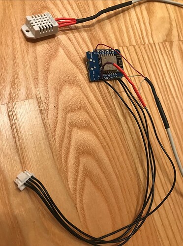

The esp module is connected with the AC unit using a cn105 connector and that is used to power the esp unit + do a serial communication with the AC unit. ESP module is then connected via wifi. Again, I’m using the EspEasy firmware for my setup (since it includes the plugin out-of-the-box) and you can access and setup the ESP module via build in web interface (+ do OTA, …), but I guess other firmwares would do the trick too.
Soldered look like
or
as an example - and I just added that inside the AC and closed it down, so it’s not visible anymore (it’s pretty small so should not be that hard to find place for ESP module within AC unit).
