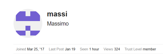

Massimo in no more available?
Don’t think so. He has not posted since Jan this year. Doesn’t answer PM’s either but does seem to be lurking

edit… while trying to figure why Massimo does not post anymore I noticed that his last posts in Jan 2019 were concerning this very topic.. expired binding… coincidence?
