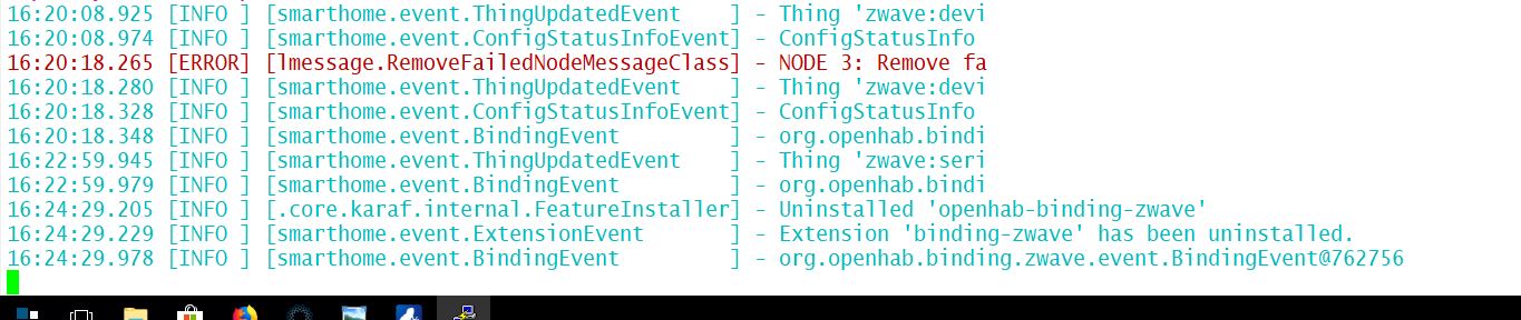

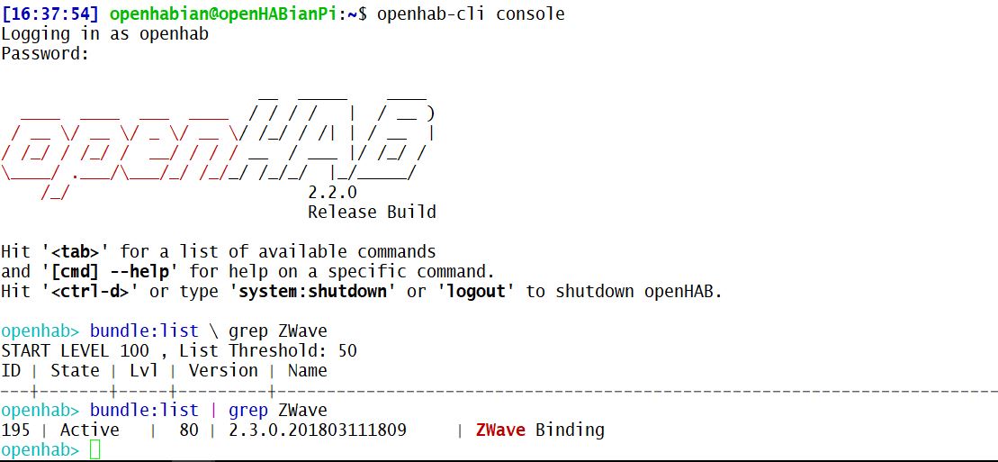

  1. I went to HABmin and uninstall (or something, I forget now) the garage door nodes.

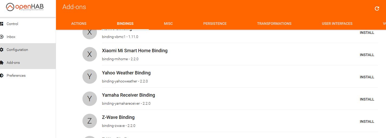

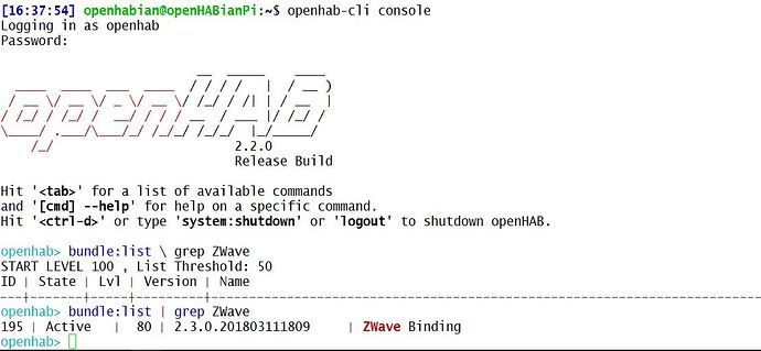

  2. I went to PaperUI > Addons > Bindings and uninstalled the ZWave binding and it worked this time.

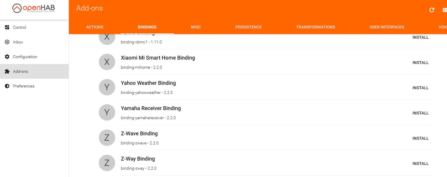

    The problem I see is that the binding in PaperUI > Addons > Bindings still lists as 2.20.
    Bummer

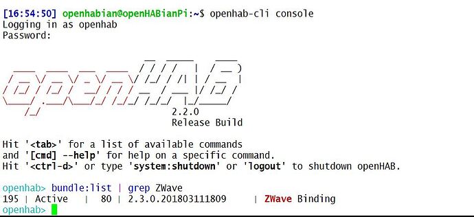

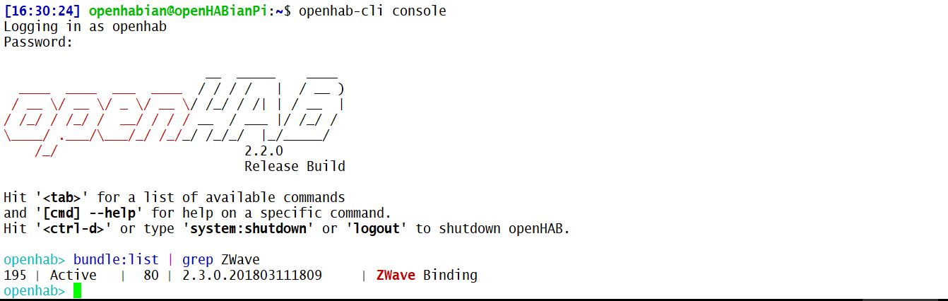

    I did a system restart.
    Checked the PaperUI Binding again. Still lists as 2.2.0.

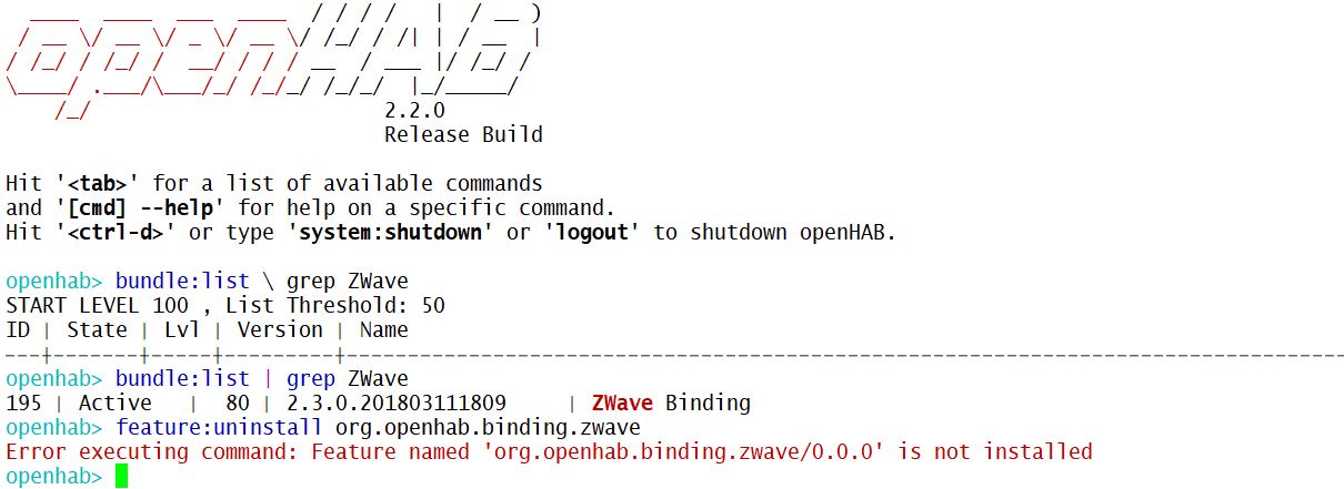

I ran “feature:uninstall org.openhab.binding.zwave” in the karaf console.
got this error massage:
Error executing command: Feature named ‘org.openhab.binding.zwave/0.0.0’ is not installed
Rebooted again
PaperUI binding still lists as 2.2.0
So what do I do know?
Thanks Marc
Oh and don’t forget the screenshots:
You’re all good. The older binding is uninstalled, so the newer binding can now start. You wil not see the newer binding in PaperUI.
Exclude the garage door opener, then run inclusion again and press the button on the opener.
OK, OK, I think I now see where I was confused (maybe). What I believe you are saying is that I leave the ZWave binding (version 2.2.0) in PaperUI > Addons > Bindings uninstalled because just by placing the binding.snapshot.jar in the /usr/share/openhab2/addons directory openHAB has seen it, installed it and it is up and running. So now I can go on my marry way and Exclude then include the garage device.
What had me is that I thought that I HAD to start the new binding file somehow after putting it in the directory. That there was no way it would start on it’s own. I was sure that the binding label in the PaperUI was just missed-labeled and that by starting this binding I was actually starting the new 2.3.0 binding.

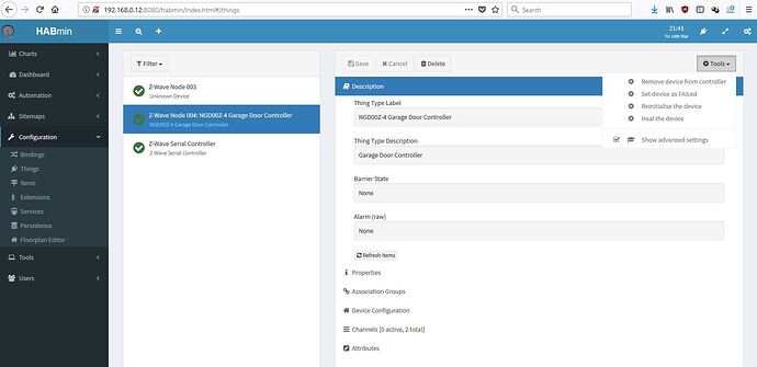

Well, I went to Habmin >Configuration> Things> Z-Wave Serial Controler> Tools (over on the top right)> Advanced Options> Exclude
Then I think I re included it or something. Reset the Garage door thing, pressed the magnifying glass, pressed the button on the garage door thing again. I got a notification of a new device and I added it.
But I still don’t see anything in PaperUI>Control
I feel thoroughly lost again.

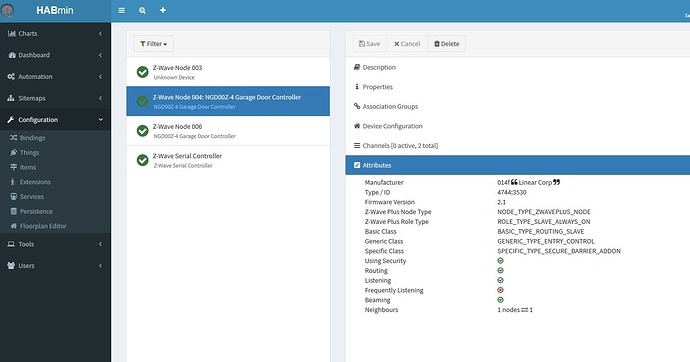

  4. In Habmin> Configuration> Things> newly added Thing> Attributes> Using Security, if this is a grey question mark, then wait. If it is a red X, then continue (it was not securely included). If it was a green check mark, you are done.
  5. In Habmin> Configuration> Things> your controller> Tools (top right)> Show Advanced Settings> Tools> Exclude Devices. Same as Inclusion, you now need to press the button on the device to let the controller know which device to exclude. The opener will beep three times and then a long harsh sounding beep.

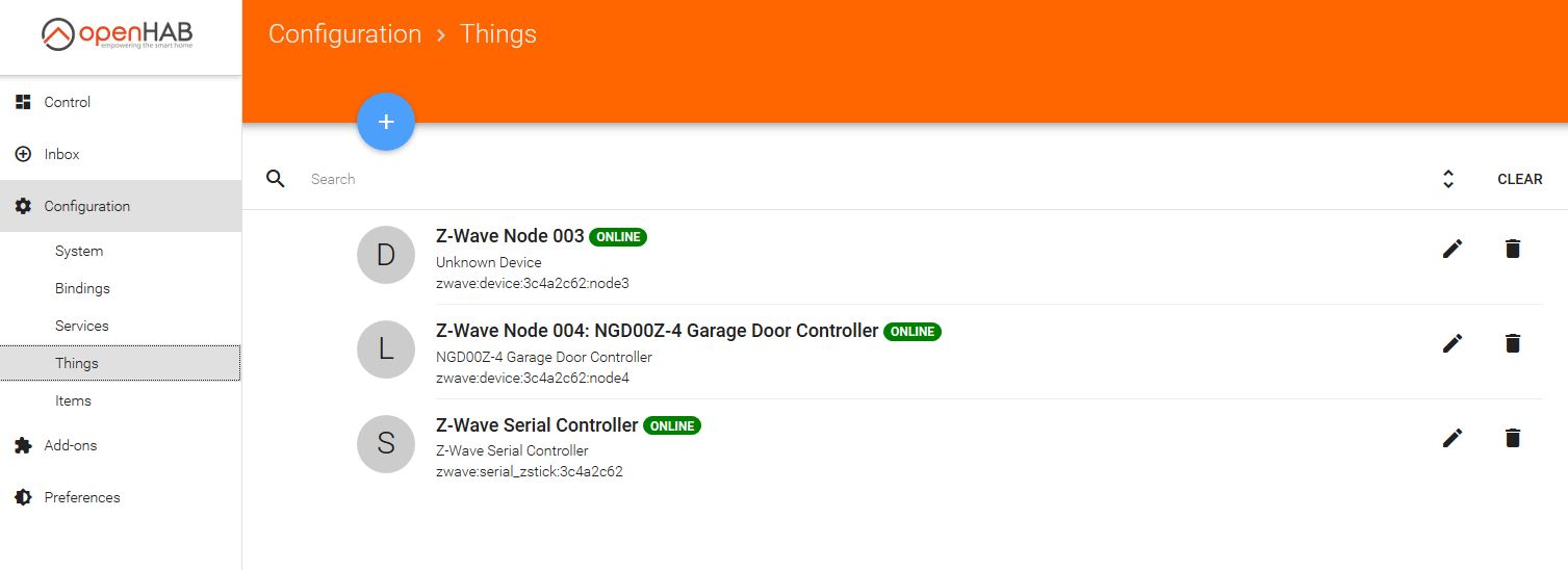

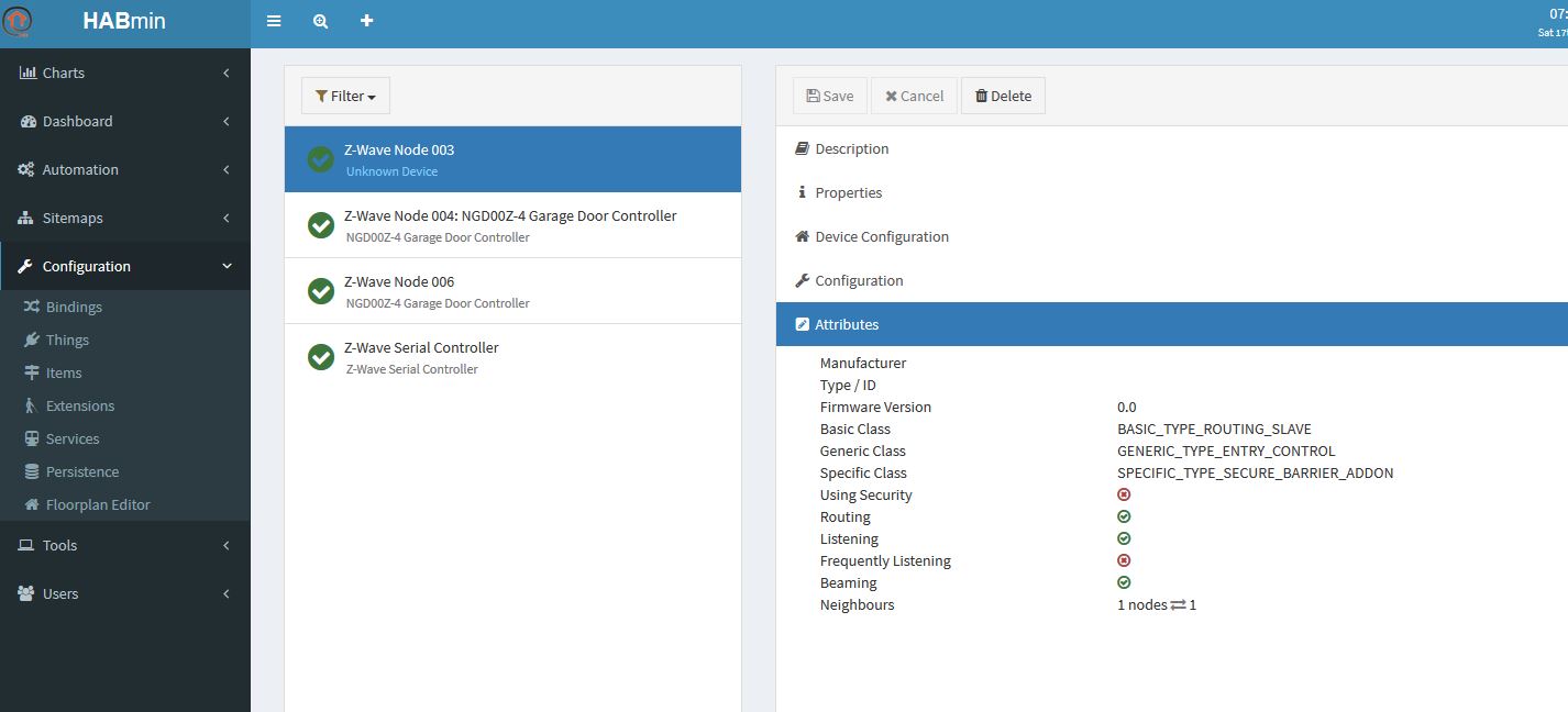

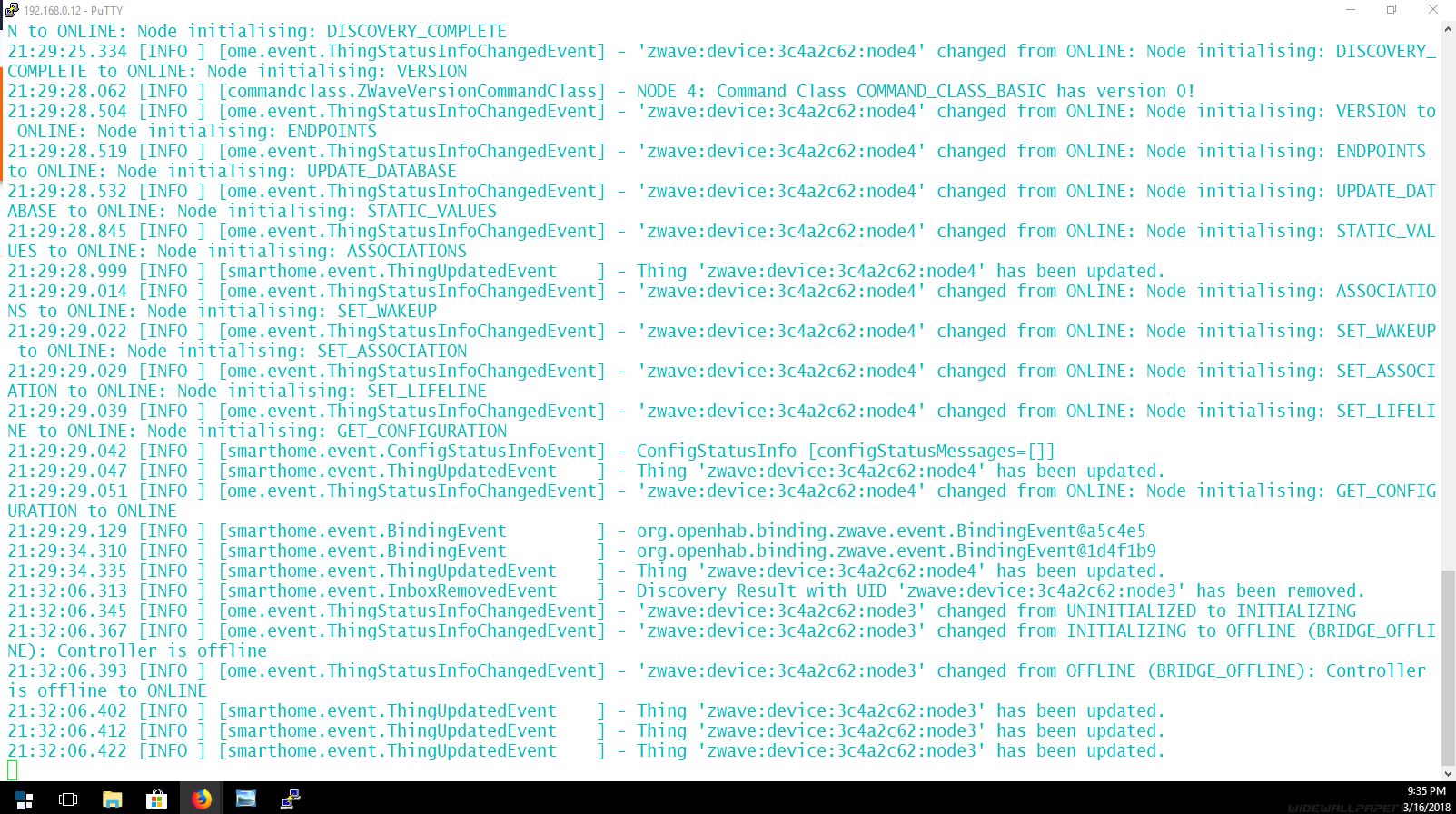

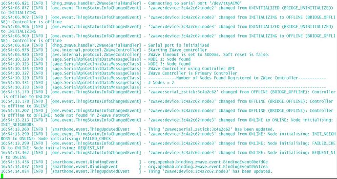

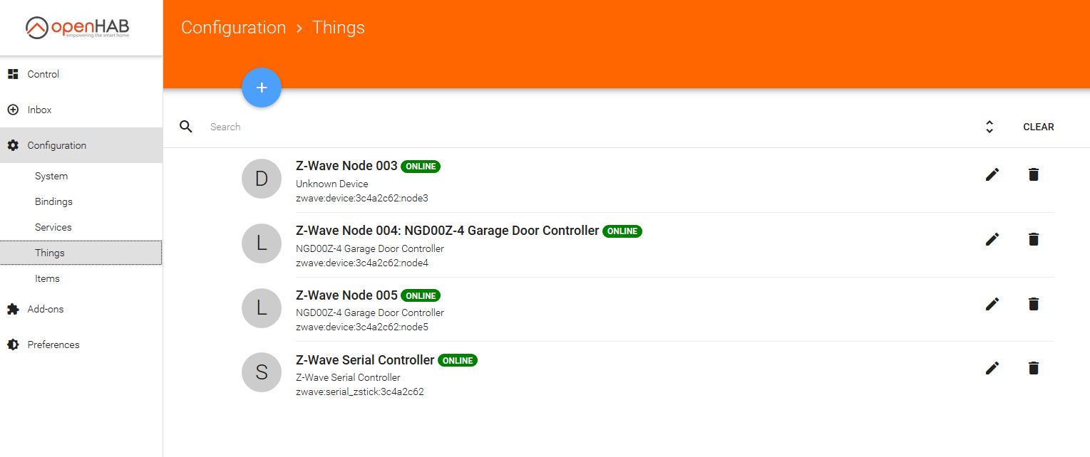

I’m not sure what this means. Same as what? Beside the Z-Wave serial contoller there were 3 nodes od different numbers.

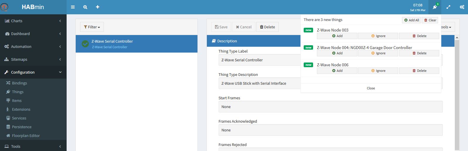

Anyways, I tried again.
  1. I excluded through the Z-Wave Controller. Then went to the garage door device and presses the button. I think I got a short then a long beep. Note: Up until this point I had been looking to exclude each device through their own nodes. I didn’t think you would issue an exclude command from the Z-Wave controller it’s self.
  2. I forgot to to reset the garage door device by pressing the button 5 times. Oops

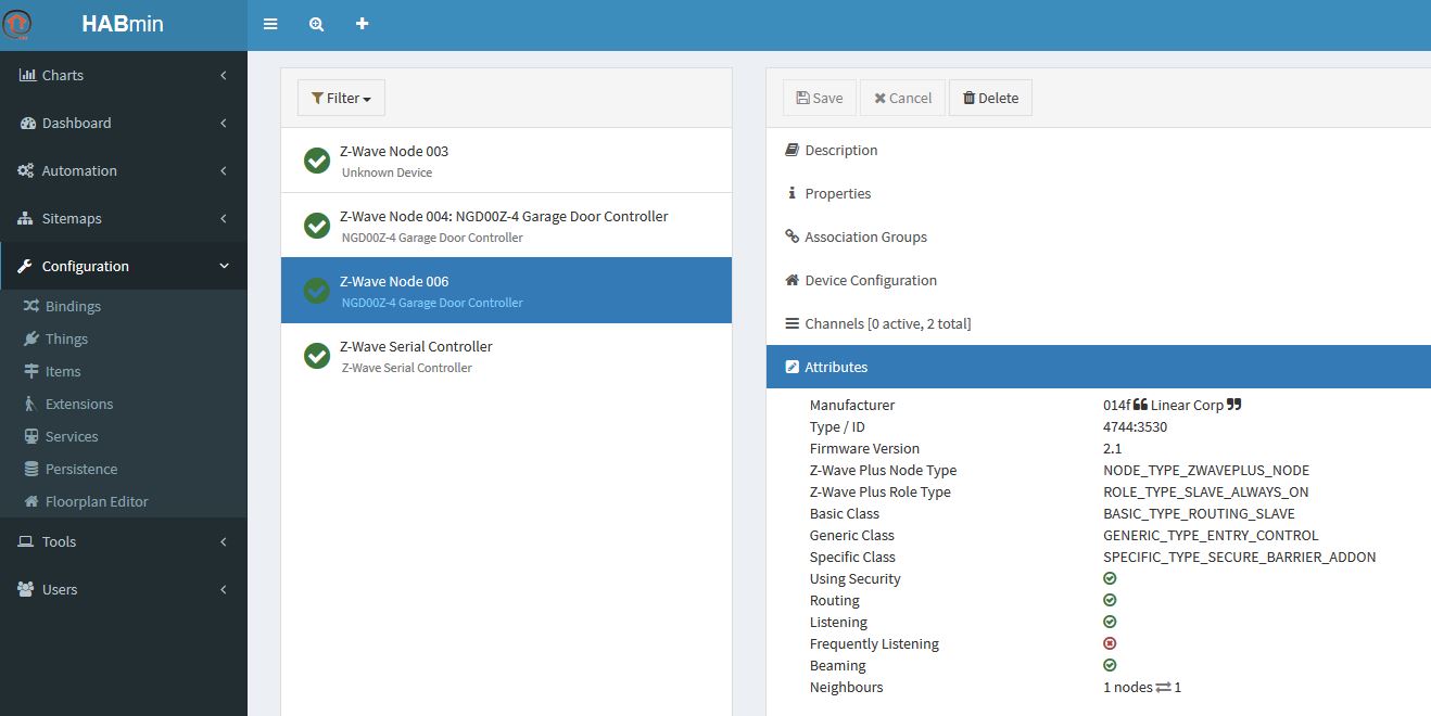

  3. I deleted the 3 devices listed under HABmin>Configuration>Things. Because I was thinking that these are all copies of the same device or something since I have only one device besides the Z-Wave Serial Controller.
  4. I Pressed the magnifying glass search thing then pessed the button on the garage door thing and got tome beeps.
  5. Got 3 new discovered things and added them.
  6. Looked In Habmin> Configuration> Things> newly added Thing> Attributes> Using Security to see if thing look right. New nodes 006 and 004 look good but new node 003 still has security x-ed out.
So am I looking good yet? Or should I do it again and this time remember to press the garage door device button 5 times to rest the device?
Also I still don’t see anything in the PaperUI>Control section.
I’m going off to work now. I’ll be back kind of late.
Thanks Scott
Marc

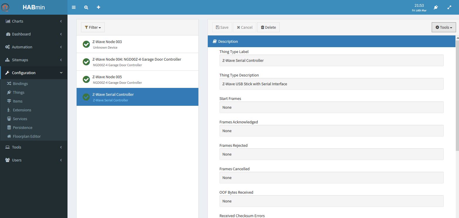

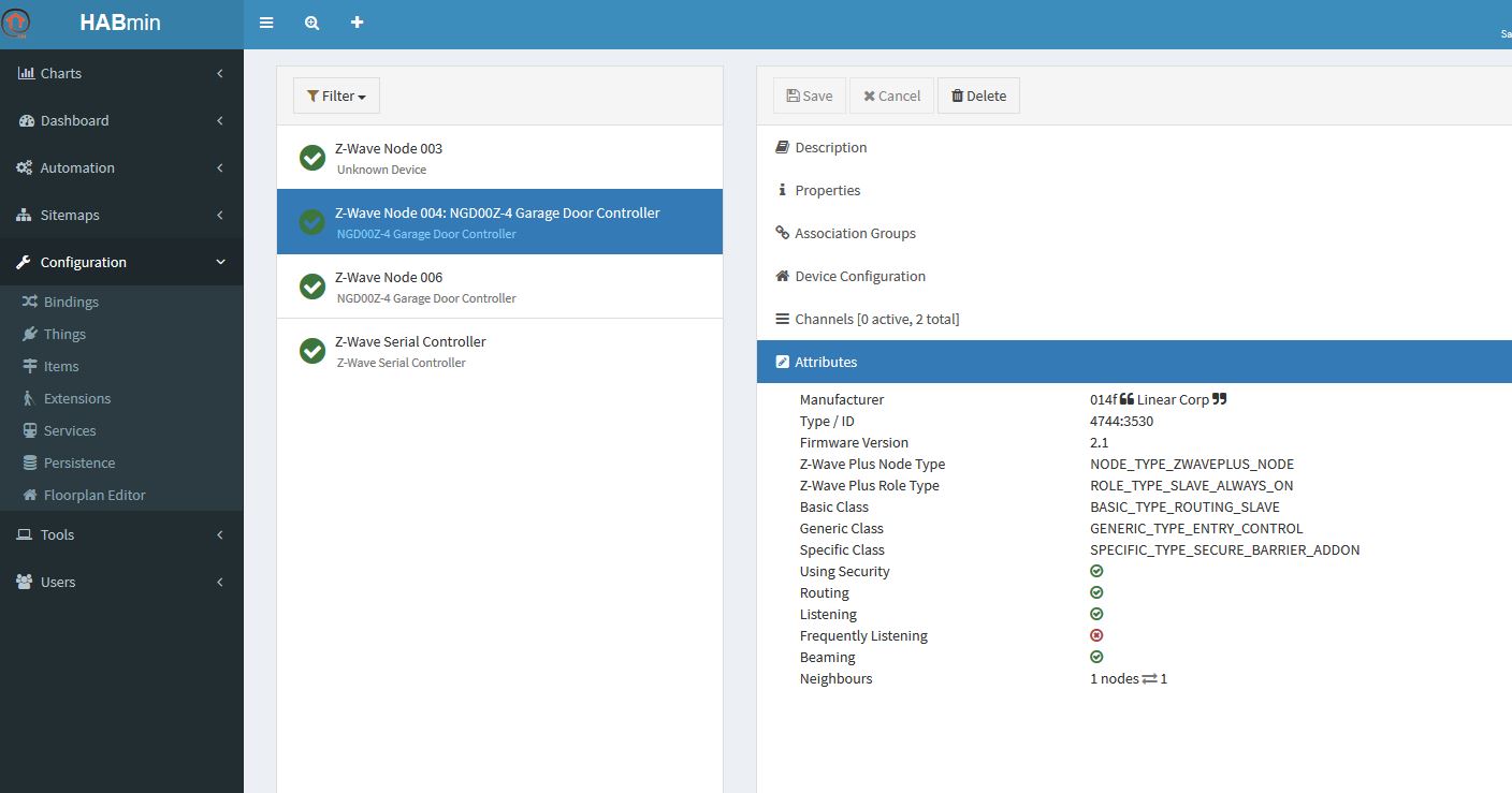

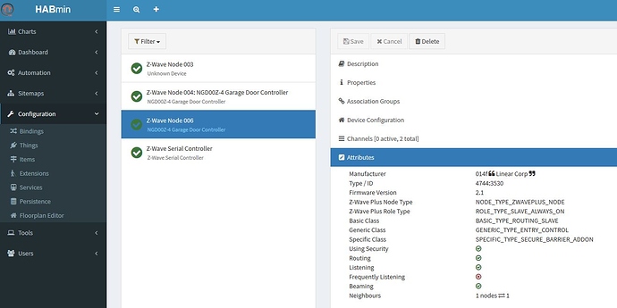

Screen Shots attached:
When assigning node IDs, the zstick (all controllers?) will find the next available node id that is not in use on the network. At 232, it starts back at 1. After a discovery and adding the devices from the Inbox, you should see a node with a new node ID. If the node IDs of your devices didn’t change, then no new node was added. When a device is successfully excluded, it will show in red (Habmin). Delete the Thing so that it does not display any more. If you reset the device without excluding it first, it will still show up in OH because when the binding queries the controller for devices, it will still be reported. Habmin has the option to remove a device from the controller, but I haven’t used it. It looks like Node 6 is your garage door opener, and it was securely included, so you should be good now. Cleaning up the old devices may be a pain, so let’s leave that for now.
That is displaying Items. You will need to create Items that link to the channels available from the garage opener Thing. You can create them through PaperUI, Habmin, or an items file.

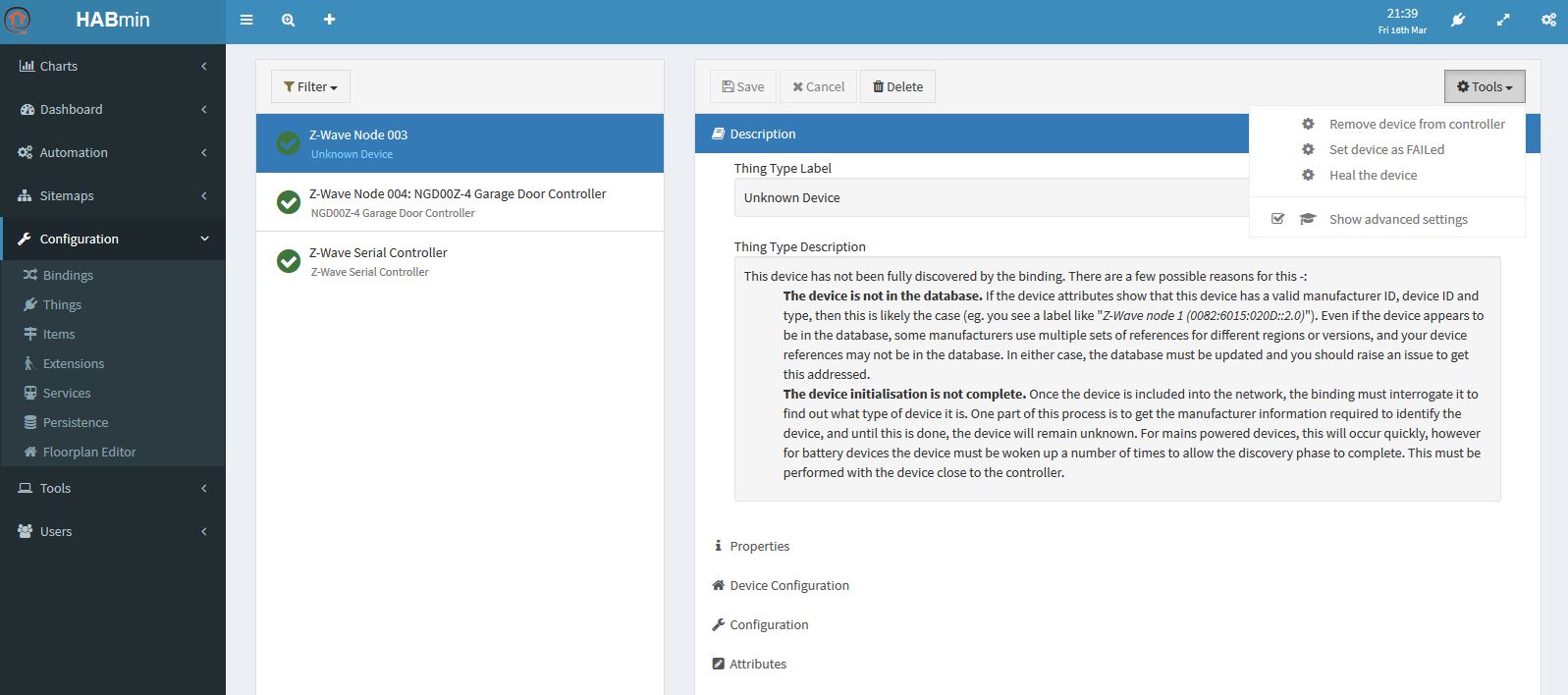

Also if the extra nodes showing in my Things section from not properly excluding devices is going to be a problem maybe it would be easier to format the OS again now that I have a better understanding on including devices?

No, there’s no need to format the OS or to reinstall OH, because that would still not remove the ghost nodes. The easiest way would be to exclude the devices and then reset the zstick (turn off OH, unplug the zstick, hold the button for 20s). Another option is to use Zensys Tools, which Aeon Labs looks to have stripped down as their OTA firmware installer app.
It is also distributed with the InControl software by Axial, but they have a link to download it too.
Using Zensys Tools, you’d send a NOP to the dead node (you have to type the nodeID into the text box). This should fail, but sometimes it takes more than once. Select the dead node. Click the IsFailed button to check it. This will mark the node as failed. Then you can click the Remove Failed Node button. It sounds daunting, but is a good thing to learn for maintaining the network in the future. The worst thing that could happen to you at this point is that you’d have to do a reset. Better to learn how to do it now than when you have more devices on the network. There may be some more detailed write-ups on the forum.

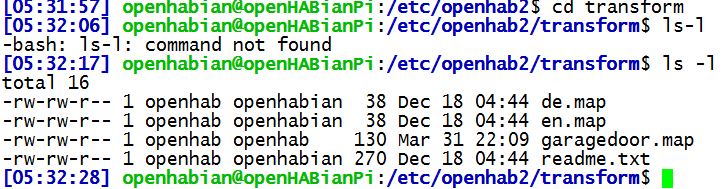

  1. where does the “MAP” File go?:
    0=CLOSED
    ON=CLOSED
    252=CLOSING
    253=STOPPED
    254=OPENING
    255=OPEN
    OFF=OPEN
    -=Unknown
    NULL=Unknown

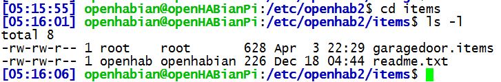

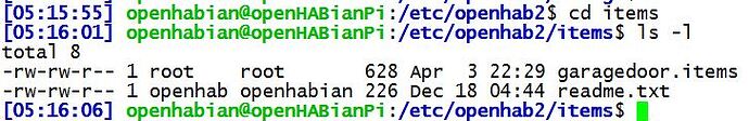

I put the “ITEMS” in /etc/openhab2/items/home.items
and the LAMBDA in /etc/openhab2/rules/home.rules

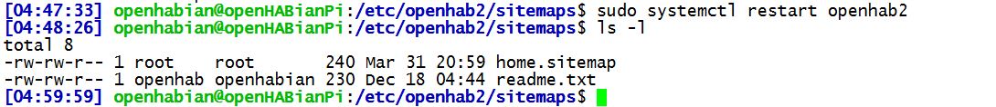

I made a sitemaps file:
/etc/openhab2/sitemaps/home.sitemaps
sitemap home label="MK-SmartHouse"
    Frame label="Demo"
        Switch item=DEMOSW
    Frame label=“Garage Door”
        Switch item=Garage_Door
        Text item=Garage_Door_Position
But where does the “MAP” File go?

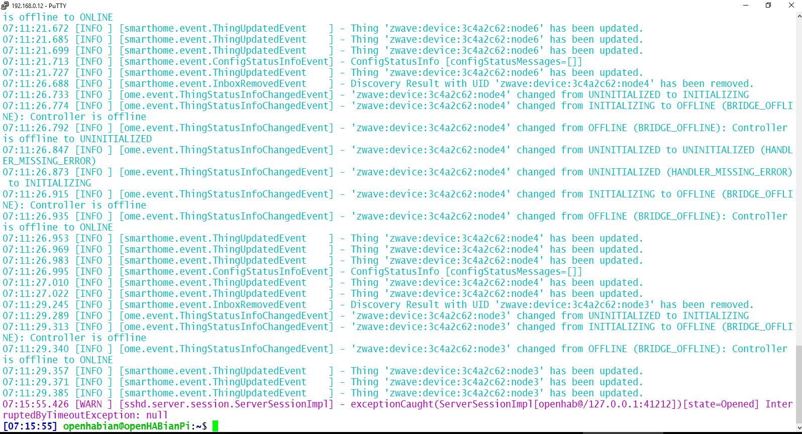

I haven’t had a chance do do your recent suggestions yet but I have been trying to figure out how to shut down openHAB when it’s running inside Linux. I installed it from the openhabianpi distro.
I’m not sure if it’s a service or a process and I’m not sure how to tell or what to do when I find out.
I read your recommendation to turn off openHAB when doing major changes and that sounds like sound advice if I knew how.

I’ve never used openHabian, but if you ssh into a Karaf console, system:shutdown has worked for me in docker.
systemctl stop openhab2
Does anyone know what could be causing this?

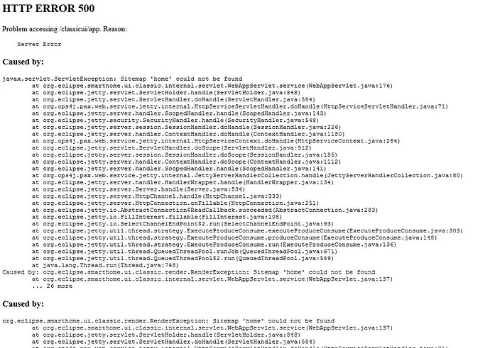

OK, whenever I try to go into the the Classic UI interface I get this error in the openhab-cli console:
openhab> log:tail
04:48:38.788 [WARN ] [ig.dispatch.internal.ConfigDispatcher] - Could not parse line 'Define your MQTT broker connections here for use in the MQTT Binding or MQTT'
04:48:40.599 [INFO ] [i.dashboard.internal.DashboardService] - Started dashboard at http://192.168.0.12:8080
04:48:40.605 [INFO ] [i.dashboard.internal.DashboardService] - Started dashboard at https://192.168.0.12:8443
04:48:43.861 [INFO ] [.io.openhabcloud.internal.CloudClient] - Connected to the openHAB Cloud service (UUID = 4a44c372-3ca2-4348-a2b6-42fd2d2deccf, base URL = http://localhost:8080)
04:48:48.426 [INFO ] [del.core.internal.ModelRepositoryImpl] - Loading model 'garagedoor.items'
04:48:55.021 [INFO ] [del.core.internal.ModelRepositoryImpl] - Validation issues found in configuration model 'garagedoor.rules', using it anyway:
There is no context to infer the closure's argument types from. Consider typing the arguments or put the closures into a typed context.

04:49:12.953 [INFO ] [smarthome.event.ThingUpdatedEvent    ] - Thing 'zwave:serial_zstick:3c4a2c62' has been updated.
04:49:12.958 [INFO ] [ome.event.ThingStatusInfoChangedEvent] - 'zwave:device:3c4a2c62:node4' changed from ONLINE to ONLINE: Node initialising: FAILED_CHECK
04:49:12.968 [INFO ] [ome.event.ThingStatusInfoChangedEvent] - 'zwave:device:3c4a2c62:node4' changed from ONLINE: Node initialising: FAILED_CHECK to OFFLINE (COMMUNICATION_ERROR): Node is not communicating with controller
04:53:43.588 [WARN ] [.eclipse.jetty.servlet.ServletHandler] -
javax.servlet.ServletException: Sitemap 'home' could not be found
        at org.eclipse.smarthome.ui.classic.internal.servlet.WebAppServlet.service(WebAppServlet.java:176) [219:org.eclipse.smarthome.ui.classic:0.10.0.b1]
        at org.eclipse.jetty.servlet.ServletHolder.handle(ServletHolder.java:848) [88:org.eclipse.jetty.servlet:9.3.22.v20171030]
        at org.eclipse.jetty.servlet.ServletHandler.doHandle(ServletHandler.java:584) [88:org.eclipse.jetty.servlet:9.3.22.v20171030]

Caused by: org.eclipse.smarthome.ui.classic.render.RenderException: Sitemap 'home' could not be found
        at org.eclipse.smarthome.ui.classic.internal.servlet.WebAppServlet.service(WebAppServlet.java:137) ~[219:org.eclipse.smarthome.ui.classic:0.10.0.b1]
        ... 26 more
Here are the contents of my /etc/openhab2/sitemaps/home.sitemap File:
    Frame label="Demo"
        Switch item=DEMOSW
        Switch item=GarageAttached_Door
        Text item=GarageAttached_Door_Position
Screenshot of ls -l in /sitemaps:
screenshot of ls -l /items:
Here is the contents of /etc/openhab2/items/garagedoor.items:

Screenshot of /etc/openhab2/transform:
File contents of /etc/openhab2/transform/garagedoor.map:

I strongly suggest using VS Code with the openHAB extension, which is the official editor. I’m not familiar with mcedit.
I think your sitemap issue might be caused by smart quotes (if you look at what you pasted in your post, the double quotes in line 7 look slightly different that in line 1 and 3). Retype the quotes on line 7. The validation warning addresses this line too. The permissions on your files also look odd, unless your running OH as root.

And I see what you mean about owner and permissions for those files. The tutorial I was following told me to “sudo nano” to create the files. I can easily change them to openhab openhabian if that makes a difference.

I’m sure it will. OH expectes openhab to be the owners of those files.
