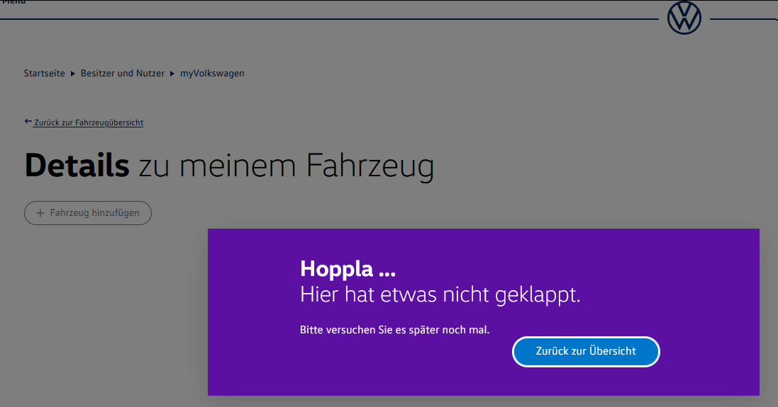

Same here. Logs shows 404 for identity.vwgroup.io
I guess it is an VW/Audi bug because for me even the login on the website doesn’t work properly
I can login in myaudi, and all the functionality of the website works OK.
If I try to access https://identity.vwgroup.io/ the browser gives “404 Not Found: Requested route (‘identity.vwgroup.io’) does not exist.” that is the same that appears in the connectedcar binding logs

Now, itˋs working again….seems problem was on Server-side….
Confirmed, thanks for the heads-up
