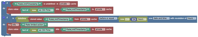

Blockly
The openHAB Rules Tools [4.1.0.0;5.9.9.9] Block Library provides a rate limit block that implements this design pattern.
To implement this yourself it would be something like the following.
