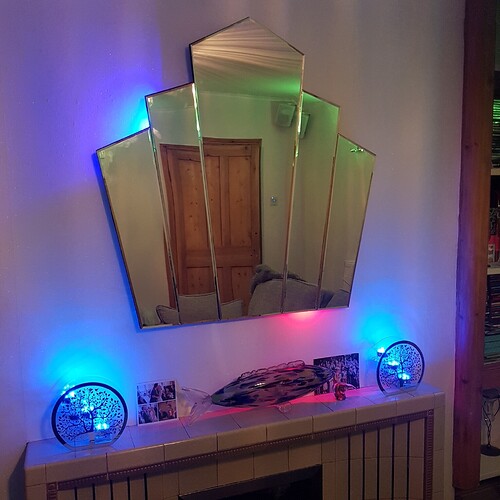

I thought I’d share a rule I’ve just created to turn the 83 addressable SPI LEDs I have around a mirror into a 12 hour clock.
Showing 10:25 in this picture.
The pixels start at the top, go around the mirror clockwise (Which wasn’t intentional, just the way I happened to make it, but it made programming this rule much easier).
