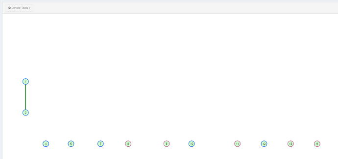

Hello folks, I just updated openhab to 2.3 (it went way smother then expected, so far ) and I added new device that was not supported before (sensative comfort strip). It went fine, but after mounting it on its final place it went offline, but waking it manually got it back online. Which got me to read a bit about the z-wave network repeating and healing and stuff. All works fine, all devices are (for now) at most 6-8m distance from the aeotec stick, with one/two walls in between. But is z-wave network supposed to look like this?
Node 2 is a wall switch, closest to the stick. Other nodes are several wall switches, roller blinds controllers, some battery powered switches and door sensors.
I also noticed in habmin that healing is set at 2am, should I disable it? (I dont thing I ever chose that myself)
Is all good or is there something I can do to improve the network? (as mentioned above, all seems to be working fine, I think)
There’s not much you can do with such an outdated binding. I don’t think much has been done in master other than device database updates since 2.2 (maybe 2.1?). Heal is displayed in Habmin, but is not available in the version of binding you are using. An updated version should be available soon, or you could manually install it…

After updating the binding, the network view will likely look different, but this really doesn’t mean much…
