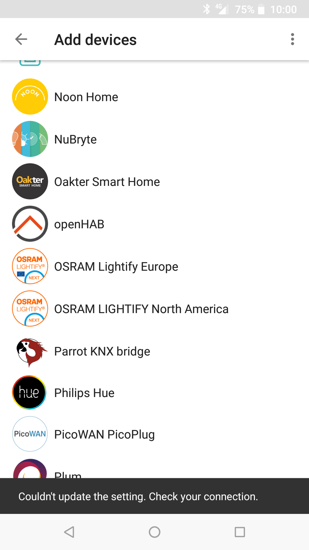

But when I added a second item it didn’t show up. So I unlinked openhab.
Now I try to relink openhab, after I click allow on the openhab webpage I get the error
“Couldn’t update the setting. Check your connection”
I am sure the connection is ok as it worked before. Not sure what to do next.
I’m getting the “Couldn’t update the setting” message too

If you’re getting “Couldn’t update the setting”, then it possibly means you have tags other than Switchable or Lighting in your config. As soon as I removed any other tags, it worked perfectly.

Confirming, in my case removing tags “CurrentTemperature” also resolved problem.
Thank you that worked. Removed the tag I added, no idea what was wrong with it, it was same tag as on the other item which worked.

The message “Could not update the setting” was happening to me too. I removed all the tags and saved the .items file, then I just added the “Switchable” and “Lighting” tags and saved the file again. Done that, I reboot the openhab and connect to my openhab again.
Worked to me, hope this can help you
