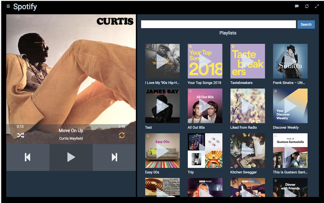

I played about with @pmpkk cool python script and opehab panel. I’ve modified both significantly for various features, like making the script able to handle various inputs so you can stick voice commands straight into it. So now since device ids do change, you can type part of the device name instead. That way the command “play Bathroom” works much more reliability than the device id and it much easier to to use in rules.

A nice and useful implementation of search would be in a habpanel widget. That would easy for users to install with minimal effort required. There are already some Spotify widgets. It would be nice to see those widgets extended with search included. A widget also has the ability to provide a nice UI to display the search results.
