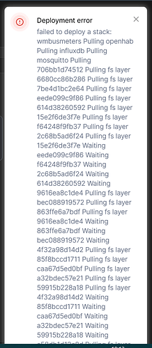

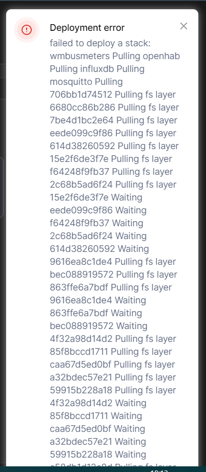

Disclaimer 2: As you can read in this thread, running all of the below on Docker requires more than 1 GB of RAM. It also runs with just 1 GB of RAM, but Raspbian then starts to swap, which reduces speed and lifetime of the SD card.

  • Use the “Add Stack”-button to add the following Stack and deploy the respective containers defined in that stack.
  • You can either paste the stack-definition code (below) into the Web Editor or (what I would recommend) save the code into local files and use the “Upload” function. Give the stack a meaningful name (I chose openhab as a stack name).

Guys I stuck on stack no3. Have you seen such an error before? Stack has been written to file as per instruction.
Then samba part and users/folders creation should be done with Ansible.
at the notification Tab have found that all of error notifications are finished with “no matching manifest for linux/arm/v7 in the manifest list entries”
what this is about? I did not modify any of steps.
My hardware is original rpi 3b+
It is possible that somehow an error sneaked in my instructions. Will double-check this, but might take some time.
Hi I deleted the wmbusmeters part, which fixed this, i didn’t need it, hope this helps.
Good point, did the same and stack deployed forward :slight_smile:

Thanks for your comments. You found something that would’ve probably come in my next firedrill as well). :slight_smile:
Turned out we weren’t the only ones stumbling upon this (see here). Not absolutely sure why the platform now has to be defined, but adding platform: linux/armv7 is a quick fix.
Will also update the step-by-step (incl. the docker-compose.yml) above, but have to find some time to re-do the entire thing and test it once more. Hence the quick fix.
