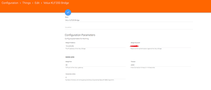

Hi Stuart,
I share you my configuration
I followed the quick start https://github.com/gs4711/org.openhab.binding.velux, and the velux binding is working great.
My configuration:
KLF200 Firmware: 0.1.1.0.41.0
Raspberry pi 2
openHAB 2.3.0-1
Copyed de binding with windows explorer: \openHAB-share\openhab2-addons\org.openhab.binding.velux-2.4.0-SNAPSHOT.jar
*.things file
Default velux password velux123.
Use IP address instead of URL (give your KLF200 a static IP Adress)
//Velux
Bridge velux:klf200:home   [ bridgeIPAddress="192.168.1.100", bridgeTCPPort=80,bridgePassword=" velux123",timeoutMsecs=5000, retries=9 ]

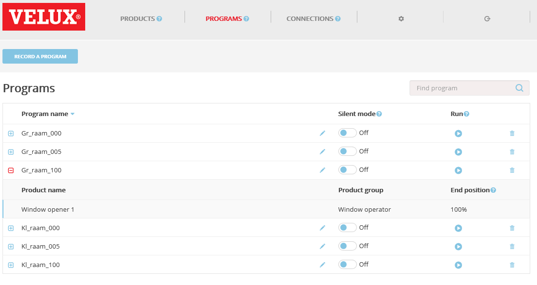

    //Ramen
    Thing   scene   grWindowClosed    [ sceneName="Gr_raam_000" ]
    Thing   scene   grWindowUnlocked  [ sceneName="Gr_raam_005" ]
    Thing   scene   grWindow050       [ sceneName="Gr_raam_050" ]
    Thing   scene   grWindowOpened    [ sceneName="Gr_raam_100" ]
    Thing   scene   klWindowClosed    [ sceneName="Kl_raam_000" ]
    Thing   scene   klWindowUnlocked  [ sceneName="Kl_raam_005" ]
    Thing   scene   klWindow050       [ sceneName="Kl_raam_050" ]
    Thing   scene   klWindowOpened    [ sceneName="Kl_raam_100" ]
    Thing   scene   allWindowClosed   [ sceneName="Alle_ramen_000" ]
    Thing   scene   allWindowUnlocked [ sceneName="Alle_ramen_005" ]
    Thing   scene   allWindow050      [ sceneName="Alle_ramen_050" ]
    Thing   scene   allWindowOpened   [ sceneName="Alle_ramen_100" ]

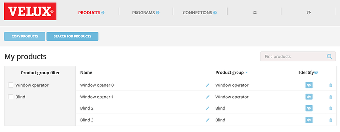

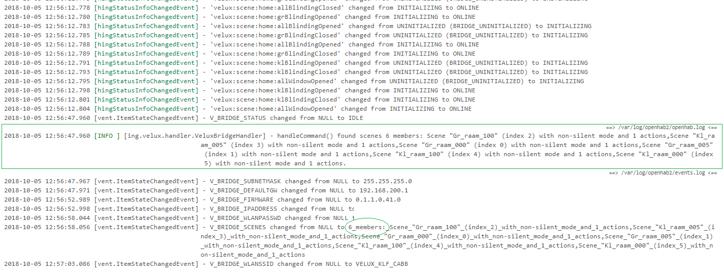

Paper UI Things, Velux products, Velux programs, Log fil OH
I am limited to one foto in a post ;-(
I hope you can do something with this information.
