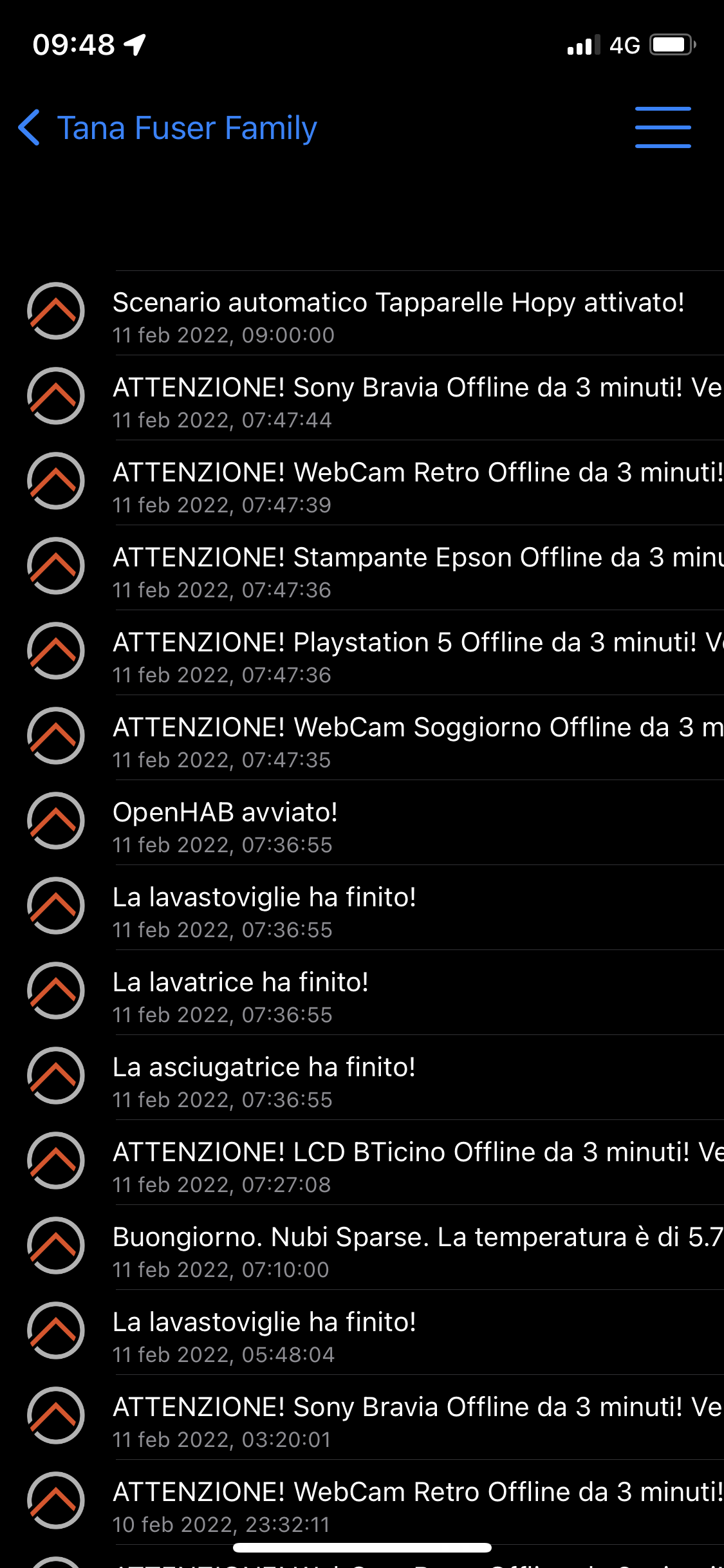

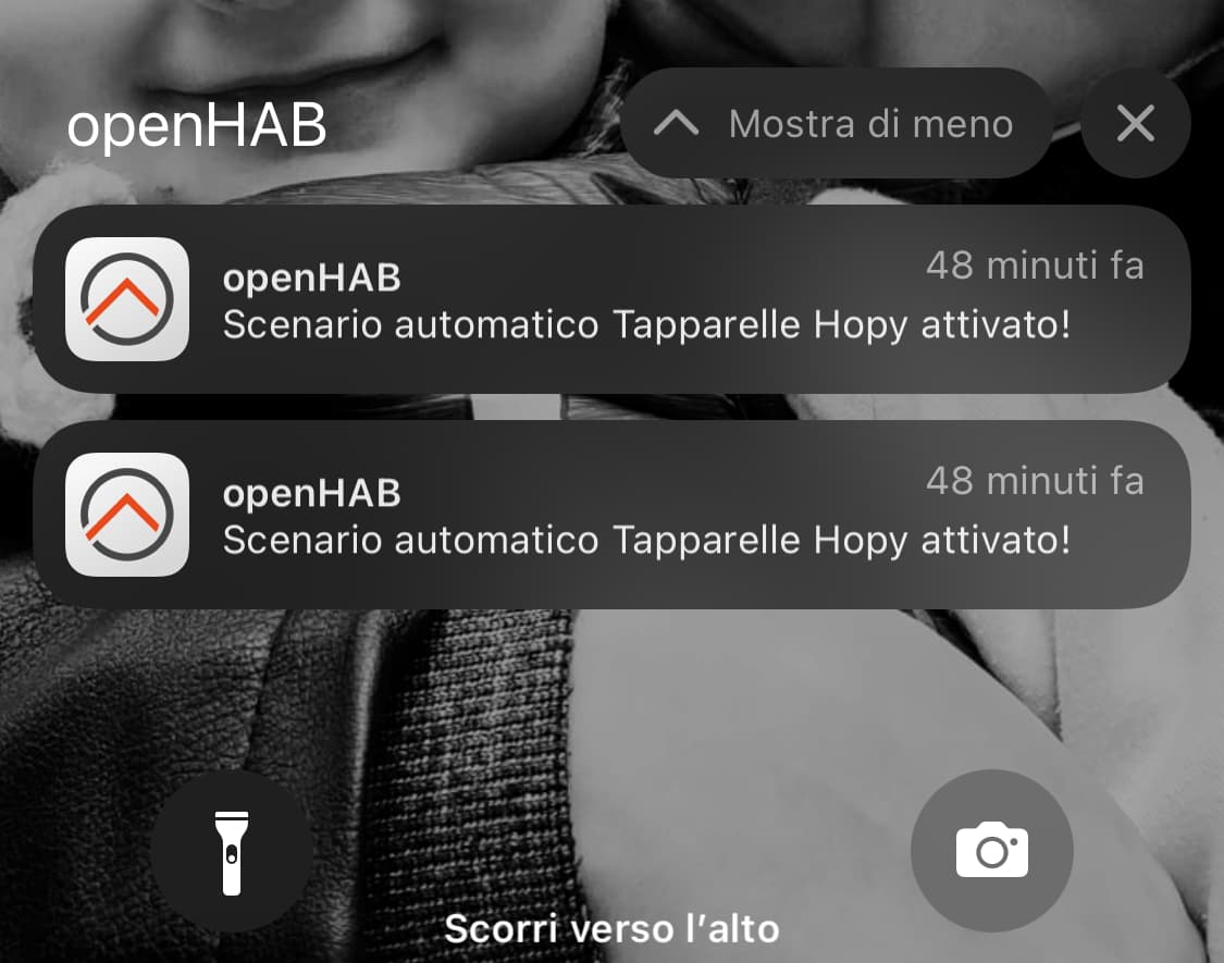

another question: with beta version i faced also this “issue” on IOS. notifications are double but only on lock screen.
as you can see, into “notification” of openhab app it’s just one.
this issue there was also on previous versions of the beta app…
