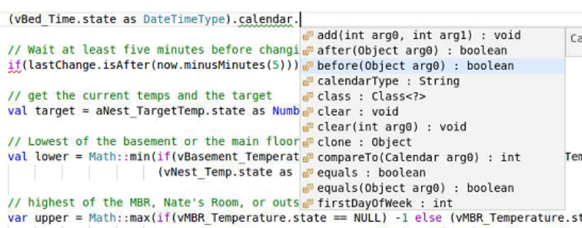

It might be easier to use
(release.state as DateTimeType).isAfter(now.millis)
unfortunately that produces an error “The method isAfter(long) is undefined for the type DateTimeType”
That does look better though.
It is probably just after instead of isAfter.
If you use VSCode you can just type up to the . And it will pop up all the methods on the object.
Of course a tried that but VSC has no suggestions for methods that resemble that.
The otehr sugestions where good though.
Currently looking into how I can give some feedback when a heater is active or not in the applicable thermostat. HABPanel widget: Virtual Thermostat/OnOff Appliance scheduling - #36 by branek
A great widget just lacks that feedback of “is it actually doing something right now”.
OK, it looks like before is on the calendar member.
Something must be missing in my VSC, the suggestions it shows you are actually useful.
At the dot I get no suggestions until i type at least one letter.
This works but it introduces another warning about getCalendar being deprecated.
