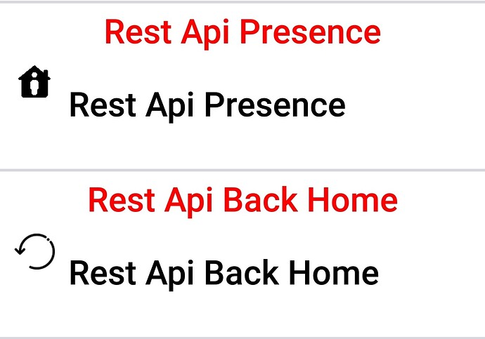

Thanks for creating this app.
Can you give an example of the syntax for filling in these two fields please?
IE,
Do they need the full path with the Item name, or just the Item name?
I’m assuming that the internal and external URLs just need to be the hostname & port.

Yes, sure:
you are right, in Internal and external URL, just the hostname and port in this manner:
http://192.168.1.101:8080
where 192.168.1.101 is the server address and 8080 is the port of openhab web interface
In case of external server, you have to use the public IP or DNS name like:
https://mysvroh.mydomain.com:4443
rest api user and password are the openhab user and password
in Rest Api Presence:
/rest/items/Nik_Presence
assuming you defined a switch for presence that is named Nik_Presence in openhab Items
of course you can define more switchs presence items each for any member of family
In Rest Api Back Home:
/rest/items/backhome
assuming that you defined a switch that fires a scenario when you come back home.
