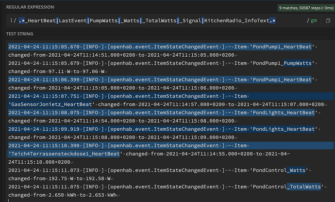

I want to filter certain events from the openHAB log, but can’t make it work
I see the following entries in events.log
2021-04-24 11:15:05.670 [INFO ] [openhab.event.ItemStateChangedEvent ] - Item 'PondPump1_HeartBeat' changed from 2021-04-24T11:14:51.000+0200 to 2021-04-24T11:15:05.000+0200
2021-04-24 11:15:05.679 [INFO ] [openhab.event.ItemStateChangedEvent ] - Item 'PondPump1_PumpWatts' changed from 97.11 W to 97.06 W
2021-04-24 11:15:06.399 [INFO ] [openhab.event.ItemStateChangedEvent ] - Item 'PondPump1_HeartBeat' changed from 2021-04-24T11:15:05.000+0200 to 2021-04-24T11:15:06.000+0200
2021-04-24 11:15:07.751 [INFO ] [openhab.event.ItemStateChangedEvent ] - Item 'GasSensorJonietz_HeartBeat' changed from 2021-04-24T11:14:57.000+0200 to 2021-04-24T11:15:07.000+0200
2021-04-24 11:15:08.075 [INFO ] [openhab.event.ItemStateChangedEvent ] - Item 'PondLights_HeartBeat' changed from 2021-04-24T11:14:54.000+0200 to 2021-04-24T11:15:08.000+0200
2021-04-24 11:15:09.919 [INFO ] [openhab.event.ItemStateChangedEvent ] - Item 'PondLights_HeartBeat' changed from 2021-04-24T11:15:08.000+0200 to 2021-04-24T11:15:09.000+0200
2021-04-24 11:15:10.390 [INFO ] [openhab.event.ItemStateChangedEvent ] - Item 'Teich4Terrassensteckdose1_HeartBeat' changed from 2021-04-24T11:14:55.000+0200 to 2021-04-24T11:15:10.000+0200
2021-04-24 11:15:11.073 [INFO ] [openhab.event.ItemStateChangedEvent ] - Item 'PondControl_Watts' changed from 192.75 W to 192.58 W
2021-04-24 11:15:11.075 [INFO ] [openhab.event.ItemStateChangedEvent ] - Item 'PondControl_TotalWatts' changed from 2.650 kWh to 2.653 kWh
and want to filter those.
I changed event log appender in log2j2.xml
		<!-- Event log appender -->
		<RollingRandomAccessFile fileName="${sys:openhab.logdir}/events.log" filePattern="${sys:openhab.logdir}/events.log.%i" name="EVENT">
			<RegexFilter regex=".*_HeartBeat|LastEvent|PumpWatts|_Watts|_TotalWatts|_Signal|KitchenRadio_InfoText.*" onMatch="DENY" onMismatch="NEUTRAL"/>
			<PatternLayout pattern="%d{yyyy-MM-dd HH:mm:ss.SSS} [%-5.5p] [%-36.36c] - %m%n"/>
			<Policies>
				<OnStartupTriggeringPolicy/>
				<SizeBasedTriggeringPolicy size="4 MB"/>
			</Policies>
		</RollingRandomAccessFile>
butt still see those events.
I used https://regex101.com to verify the regex pattern and it brings up 9 matches as expected
I also tried
		<Logger additivity="false" level="INFO" name="openhab.event">
			<AppenderRef ref="EVENT"/>
			<AppenderRef ref="OSGI"/>
			<RegexFilter onMatch="DENY" onMismatch="ACCEPT" regex=".*_HeartBeat|LastEvent|PumpWatts|_Watts|_TotalWatts|_Signal|KitchenRadio_InfoText.*"/>
		</Logger>
I also restarted OH to make sure that changes become active.
What’s wrong?
