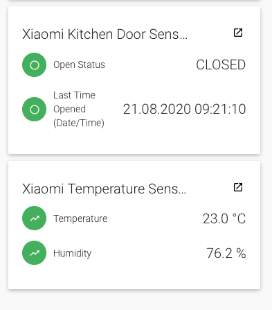

1, Xiaomi door and temperature sensor are added, it works properly on the Paper UI, but i can’t display these on my sitemap.
2, what is wrong with the rule with xiaomi door sensor (the roller shutter work like a charm),

thak you for your advice, i did it, but here is the result:
Do the items change state in the .event.log at all ?
Its highly strange since you say its working from PaperUI (I hardly ever use PaperUI control, cause I have so many things going on, and PaperUI is slow as hell, and not trustworthy in my opinion). So I suggest you keep an eye on the logfile for the items names above,
KitchenDoorStatus
KitcheDoorLastOpened
BasementTemperature
If you dont see any changes in the log, then you have the reason why they´re not working in the sitemap. And we´ll take it from there.
