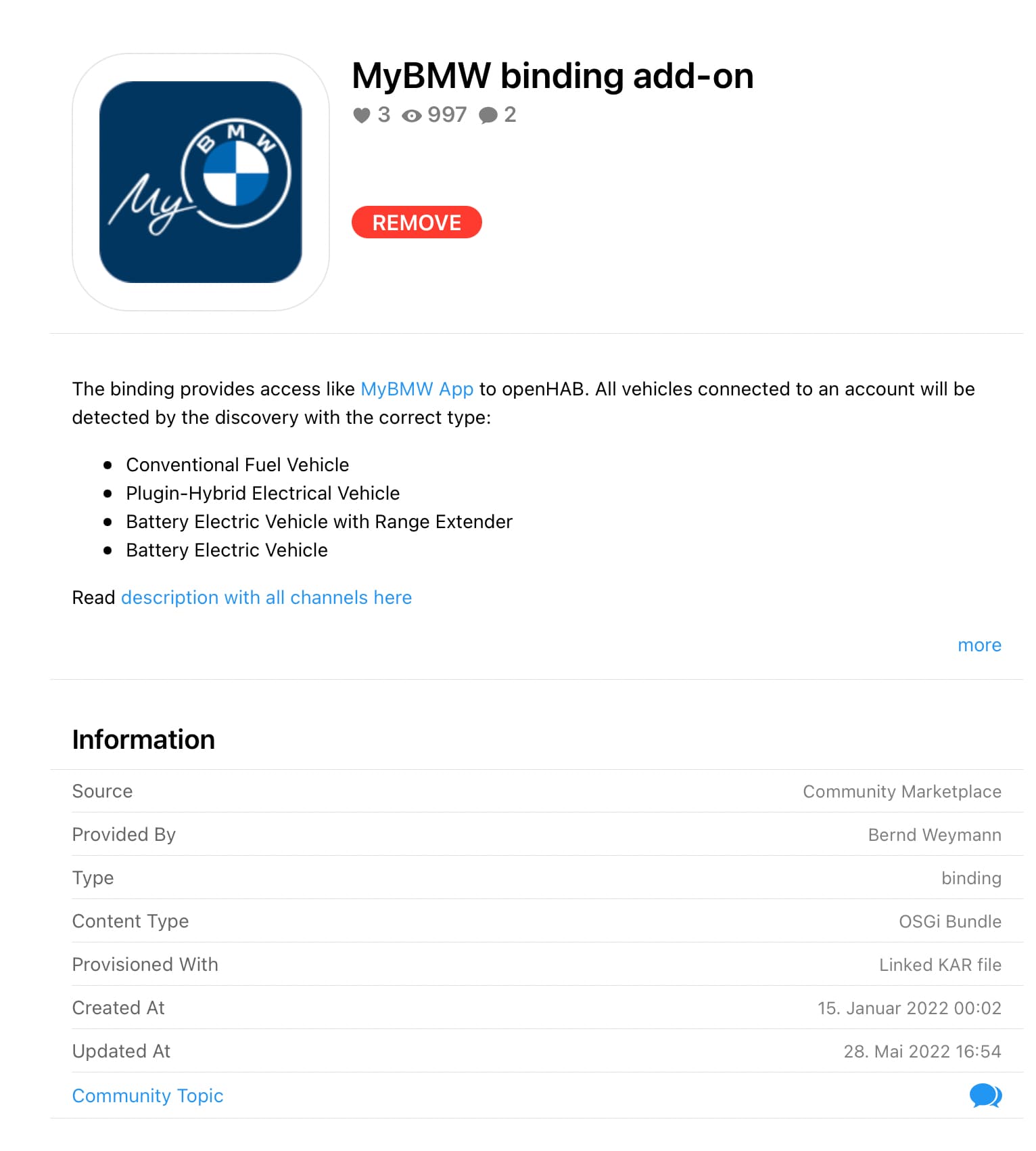

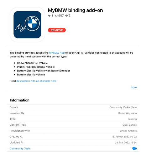

Do i have do update it manually or comes the fix to ther marketplace version, too?
I checked manually but Marketplace is adapted too. Please check and provide some feedback if it’s working on Marketplace
Actually i still got the forbidden error (even after pause/restart the bridge thing).
Binding seems up to date, i am not sure if it updated automatically?
Do i have to restart openhab maybe?
To be honest I’m not that familiar with Community Marketplace updates. As you can see the kar file was updated today with the newest changes.
Please check restart if it does any changes otherwise you can try manually exchanging the jar / kar in update folder. For me it’s working so far
Restart (simple and with cleaning cache) did not work for me.
I just removed the binding and installed it again in the marketplace. Now it is working again. Upgrade an restart is not enough.
Thanks again for your great and fast support!
Tried it this way, too - and it worked. Thank you!
